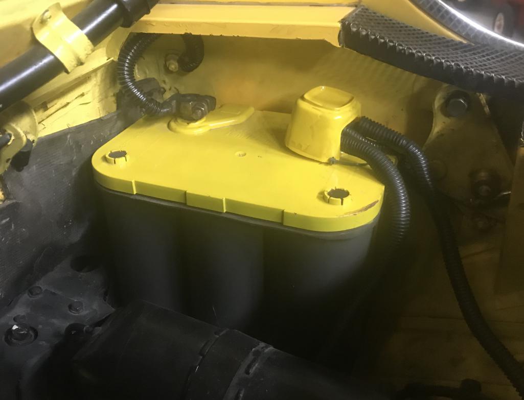

Optima 3478 battery fits just fine; battery cutoff switch added to reduce fire risk and add thief deterrent

34r Red Top (yep, just painted it to match the car...)
Tons of room....

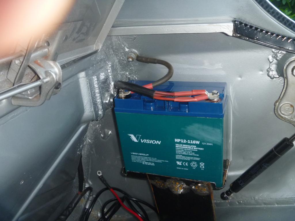

Funny little Chinese Vision AGM still going strong after a long time (4yrs),cheap and only 9lbs,hell @ less than $80 to buy and with that weight you could carry a spare.
Sold as a racecar battery in my country but plenty of cranking power for my six.
I have since built a custom battery tray for it which is future proofed to the next larger size if needs be.

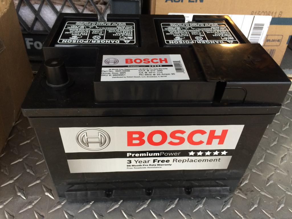

I'm currently running the Bosch 96R size battery and it fits perfect. I've had it for three years with no issues. It's connected to a battery tender in the off season.
