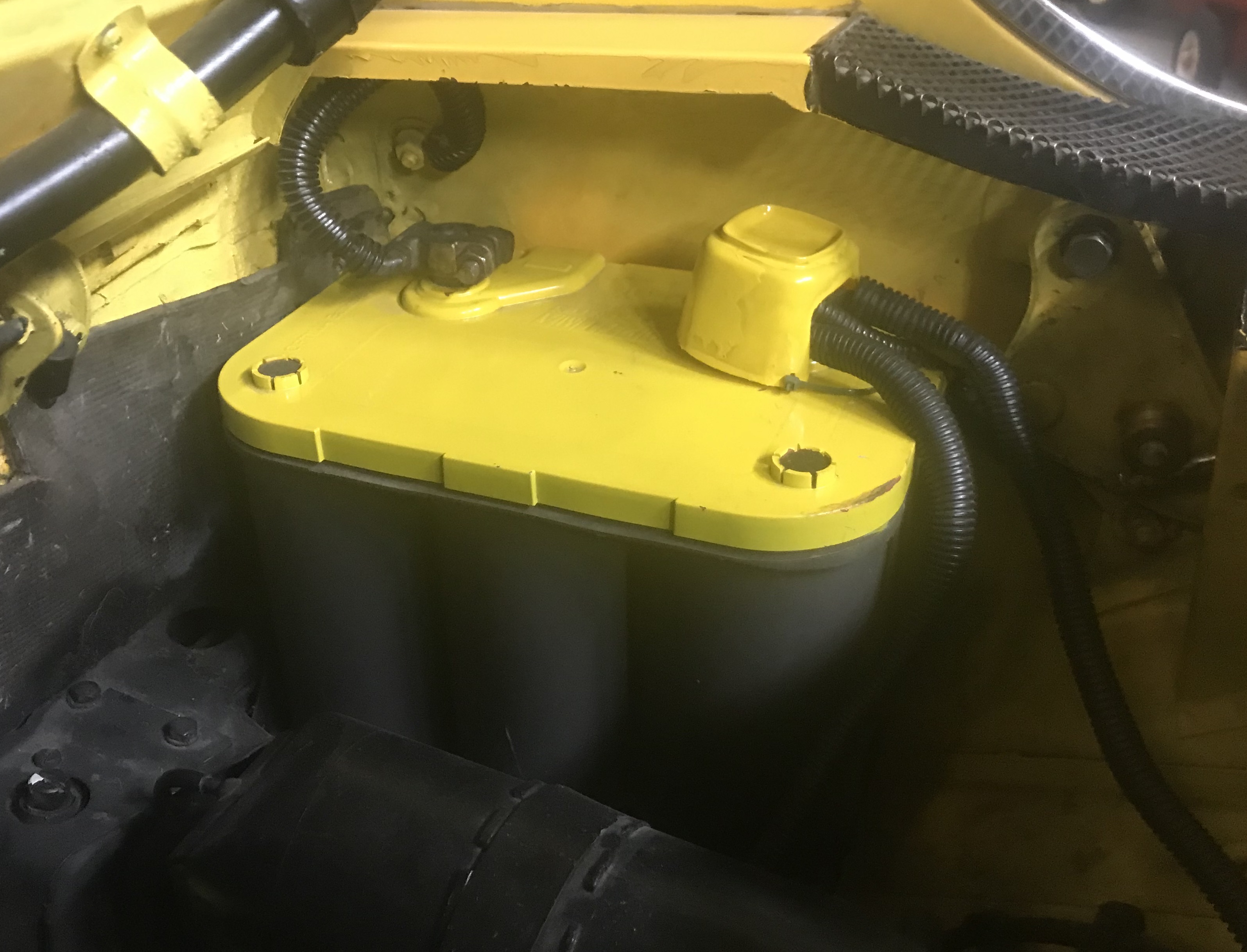

oakdalecurtis
May 21 2019, 10:19 AM
34r Red Top (yep, just painted it to match the car...)
Tons of room....

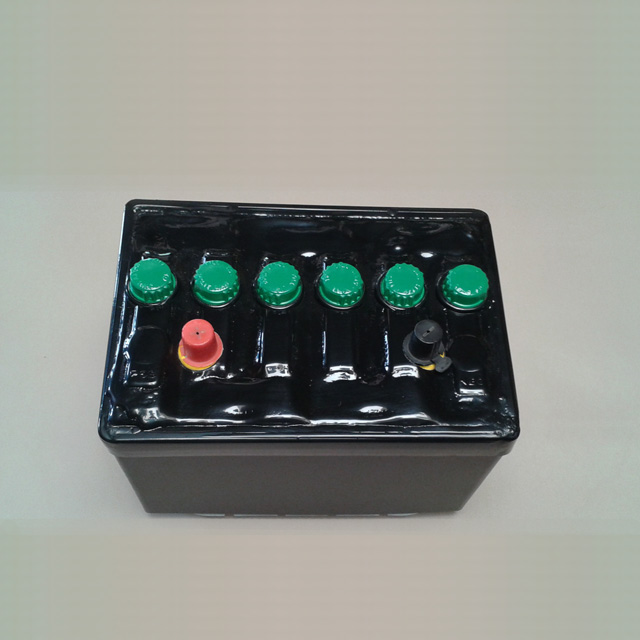

914forme
May 21 2019, 12:16 PM
You want it for period correct Look?
They make covers for the Optimas Odedessy Even Delco and Deka that make it look like the old lead acids, if you are going period look.
Click to view attachmentTar Topper Make Modren Starting Power look period correct
