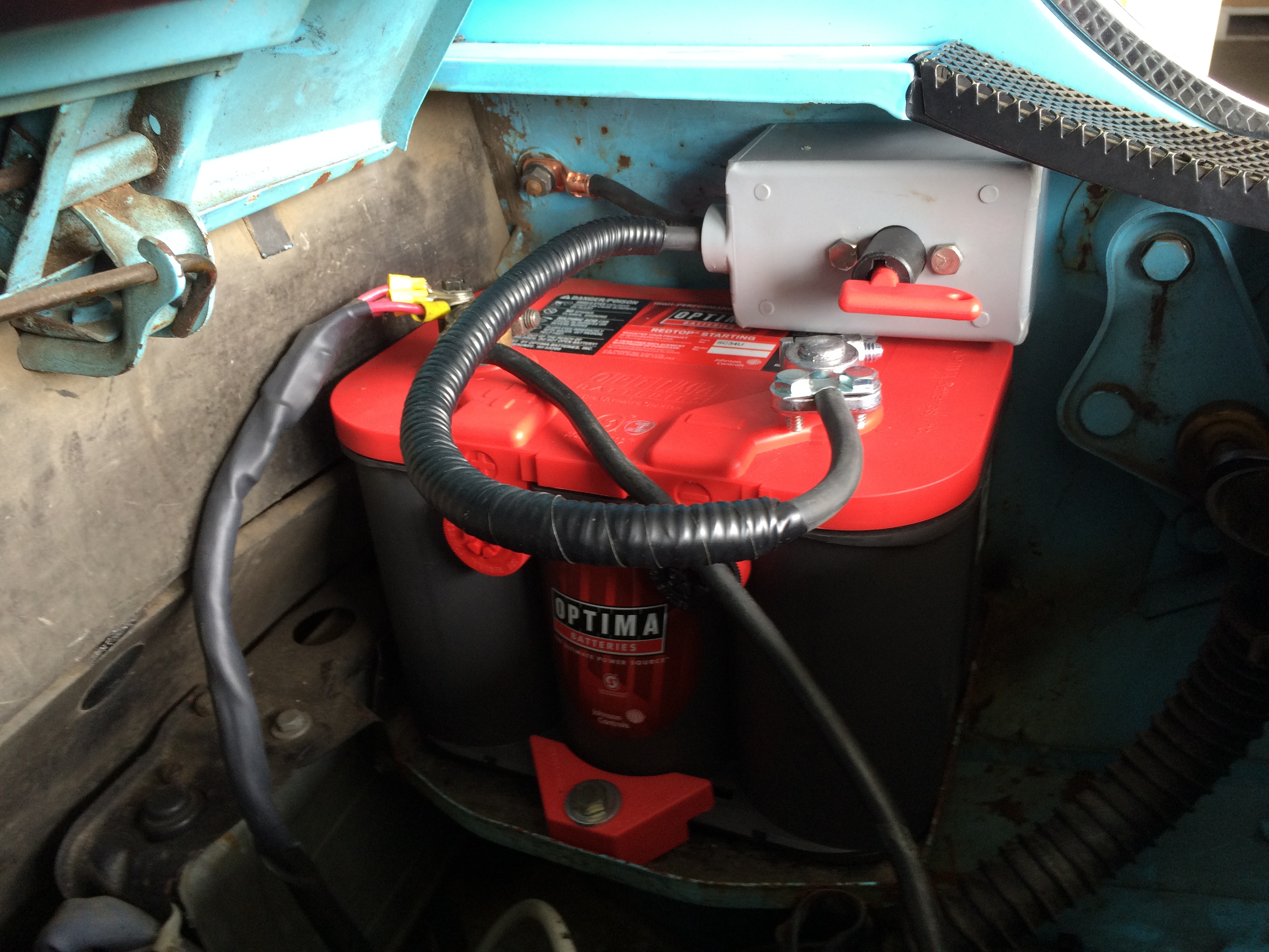

Optima 3478 battery fits just fine; battery cutoff switch added to reduce fire risk and add thief deterrent

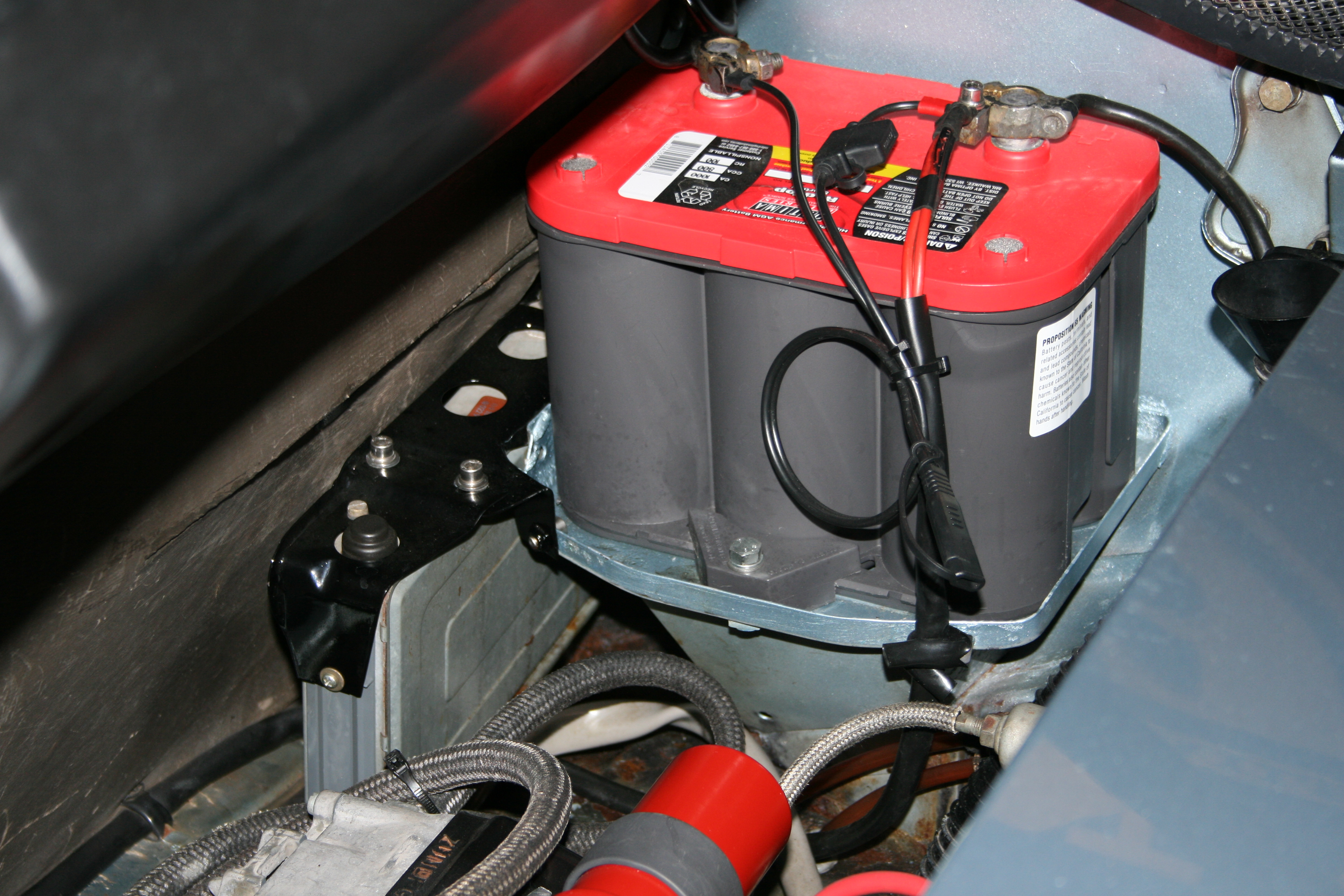

This Optima battery is about ten years old & works just fine. FYI.

34r Red Top (yep, just painted it to match the car...)
Tons of room....

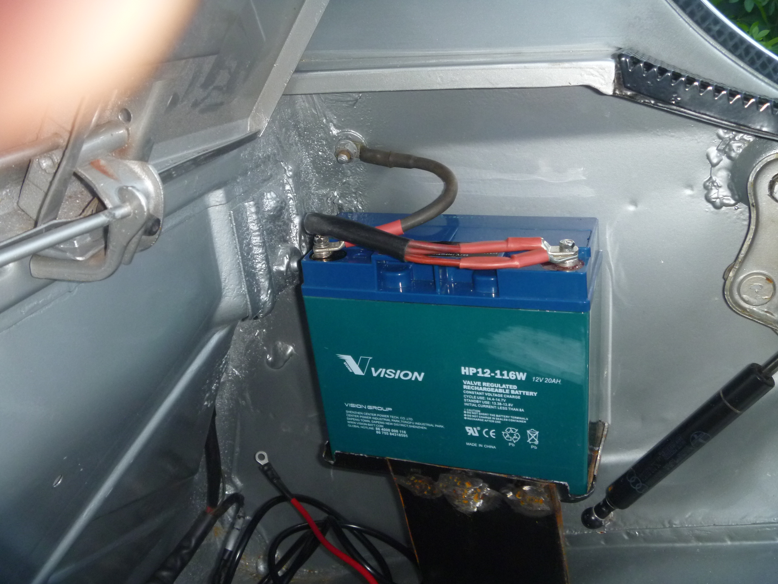

Funny little Chinese Vision AGM still going strong after a long time (4yrs),cheap and only 9lbs,hell @ less than $80 to buy and with that weight you could carry a spare.
Sold as a racecar battery in my country but plenty of cranking power for my six.
I have since built a custom battery tray for it which is future proofed to the next larger size if needs be.

napasteve
post May 21 2019, 04:38 PM
914 driving winemaker
Posts: 515
Joined: 2-January 13
From: Napa, CA
Member No.: 15,327
I just bought a cutoff switch from Amazon
https://www.amazon.com/gp/product/B007O0BBF...=UTF8&psc=1
I made the box from a plastic outlet box and cover.
