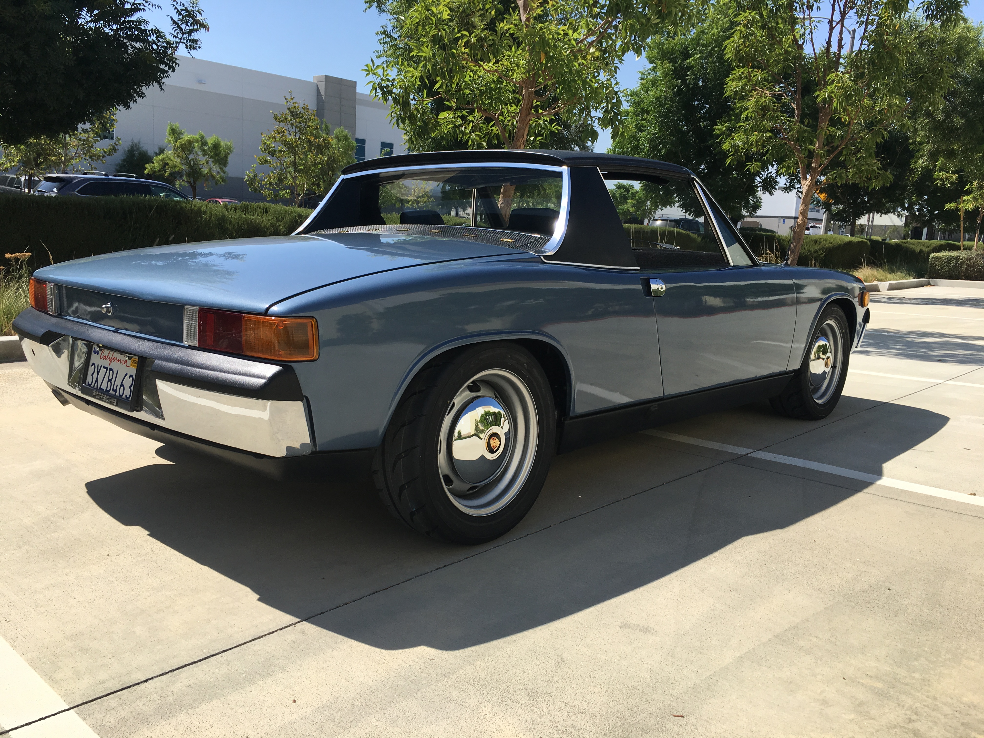

So I am in the process of restomodding my 914.
I debated back and forth on wheels.
To me:
Fuchs (4) lug empi copies. (Too many folks doing it. I wanted something different)
Fuchs (5) lug with conversion. (Expensive. Too many folks doing it, etc.)
Panasports or Ultralight style. (I have had those previously on other sports cars, and frankly wanted something different)
Mahle, real Fuchs, etc.. ditto
Now I am not saying any of those are bad. I just want to be different.
I settled on Steel Wheels 6” with Chrome hubcaps with gold Porsche crest emblem.
At first I couldn’t make up my mind if I liked the look. Now it has grown on me and I like it.
Now to the part about backspacing.
These are the US wheel VW/Porsche steel wheel replicas in 6” wide.
They advertise them with 5 inch backspace. My calculations said this would be perfect and I “should” be able to easily get a 205 width tire under the rear. I settled on a 195 width tire and I am glad I did. The actual backspace is closer to 4”.
I like the deeper dish look, but you have to be real careful with fender rub.

They look beautiful!
Offset is key as well. Offset is measured from the center of the rim to the mounting point. The 15x5.5 VW sport wheels that came on the type 1 and also available on the ‘74 and later 914s had different offsets
ET 26 on the Beetles and ET40 on the 914. The ET 40s would rub the front suspension on the Type 1s. Tricky business for sure.

Looks great, I like that look.

Thanks guys. I appreciate the positive comments.
Also part of the charm/coolness factor I was going for is the “wolf in sheeps clothing” effect!
The suspension has been rebuilt with new bushings, springs, bilstein shocks, etc....but the crowning jewel is the Toyo R888R race tires!

Very cool. Looks Great !

Looks really good. Maybe lower the rear a little for a perfect stance.

Looks great. (IMG:style_emoticons/default/beerchug.gif)
195\65\15’s?

They are 195/55/15

I agree. I have the bilsteins on their lowest height setting.
With new shocks and new springs, I hop it settles down just a bit lower.

I like your wheel/tire combo too.....the deeper dish makes all the difference. That being said, I think if you're car had a little patina, it would look better without the wheel covers and caps. Nonetheless, it looks great!

Great look- nice and clean. Very purposeful. Those are some serious tires for the street; are they noisy? Do they throw up a bunch of debris from the road? They look nice and sticky. (IMG:style_emoticons/default/beerchug.gif)

So far they have been good about not throwing things up off the street.
However, at low speeds they are a little noisy. Not too bad, but noisy enough to know it is from the tires. At highway speeds they are fine.
Since I live in SoCal, I built the car for canyon carving. So far I have taken it up the mountain a few times. It handles very good. Could use more power. Right now it has a little 1911 with dual Webers and MSDS header. More power will come in the future.

Thanks guys! I appreciate the kind remarks.
The Steelies are really growing on me! When I reaseaching going this direction, I googled “steel wheels, Porsche hubcaps, 914”. Never found a picture to give me an idea.
I finally decided “screw it”! It will look cool!
Guess my decision was Good.
