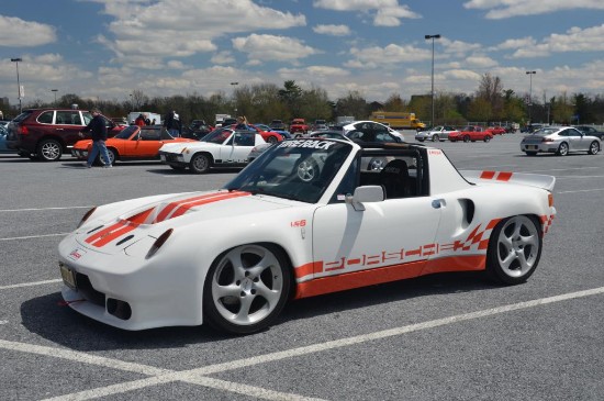

I understand that these are not to everyone's taste, but please set that aside -
Wondering if anyone has run these or if the offsets are just too much for the typical GT flared car... A quick search came up with little info and no photos on a 914 -
These also come in 11" rears which is too wide currently for my car -
Thanks -

You are going to need some seriously long wheel studs and lots of spacers to make these work.
The offset is all wrong for a 914, the mounting surface of those wheels is on the outside and most of the barrel goes towards the inside, there's no way those will bolt up and not hit the inner wheel well without some serious spacer magick.
PS: Not even sure anyone makes wheels studs long enough to make those work.

I run BIIG Spacers. Dad does too. 1.5" spacers up front and about 3.25" spacers in the back.
As JD said its technically not increasing scrub radius any more than large dish wheels.
I run 17x8.5xET50 in the front and 18x10xET62 in the rear.
I should probably change to a much smaller offset rear wheel (IMG:style_emoticons/default/dry.gif)
Granted I run my wheels black which helps the 18" look better on the 914 body. Also Im not running GT flares, Im running Bontempi flares.
Mine vs my dads.
http://www.914world.com/bbs2/index.php?act...t&id=703104

I think Chris is right. I've been trying to find affordable zero offset rims that I can afford for a year now. Mine does have heavy steering, however, with recent suspension changes it it a lot better. I'm about to update my thread with my latest wheel info but here it is.
I now have 2 sets of 2003 turbo wheels.
18x8 with 50et and 18x11 45et. I need to remeasure my spacers, but they are about 2" rear and 2.5" front.
Note: My fenders are Sheridan and are setup for 10" all around. I can run as large as 11s in front. In fact i was running 11s all around at WCR. But I am going with recommendations to use a staggered setup on the track. I haven't had any pushing issues yet with 8s on the front.
