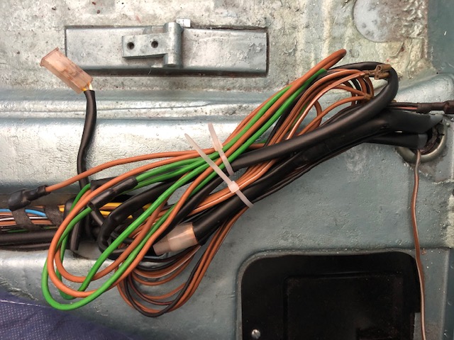

Hi everyone. If you've seen my project thread, you'll notice that this is my current headache.
Looking for any reference photos of the nice 'loom' or 'routing' of the wiring harness as it comes out of the center tunnel, to the fuse-board, then behind the dash. Also, any tips / pointers to getting this to fit nicely, or any vendors you've worked with, would be greatly appreciated!
A little preview of the headache I've had over the last few years.

A colored wiring chart will help; they have been available on this site in PDF formats. I used a laminated set and find them the best.
First: are the ends of the wires hooked mum; ie, the headlights, taillights, etc. This should be #1
If I were dealing with the wires in the picture wires; I would sort and separate them by where they go first. The wires to the gauges, wires to switches, wires to the fuse panel. Then untangle so each group can reach its destination unimpeded.When the group to the fuse panel looks right, zip tie that group to keep them together; then start at the fuse panel.
Then do the switches, one at a time, making sure the switch will perform ts designated function before going on to the next one.
Lastly, the gauges, pretty straight forward.
It may take longer than you think, but it will work out..... (IMG:style_emoticons/default/smile.gif)

Is this a new custom harness or did you just remove the tape?

This looks like a wiring nightmare. Are you doing a Subaru install here?
A regular 914 /4 or /6 isn't THAT complicated. Even an idiot like me can do those.

Original harness (1970/4cyl), with the tape and 'routing' removed. Should have never done it.

3.6 conversion, however, this being my first conversion, I made the mistake of undoing / removing the routing of the harness years ago. By all means, you're welcome to come try, bring zip-ties! (IMG:style_emoticons/default/tongue.gif)

Not something I can help you with at this point RM, other than sideline encouragement.
Just collect the wires in their routing and temporarily tie them with bread bag wrapper ties or similar, then when it all makes sense, install the spiral tape again.

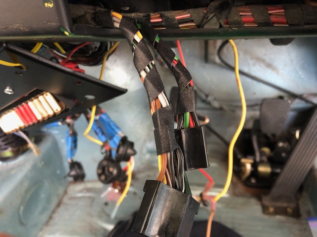

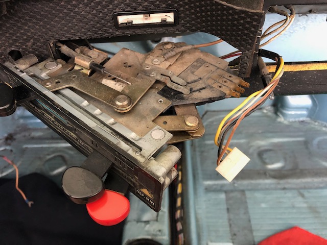

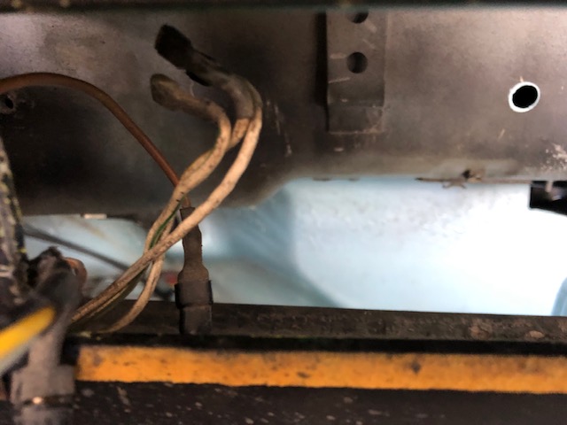

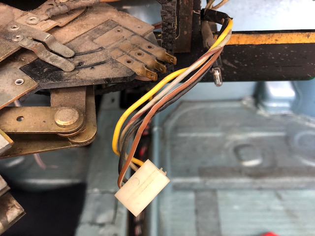

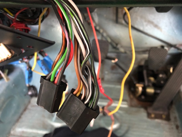

I’m not sure if these pictures can help you. Been saving them whenever I see some members share their projects. Some came from Jeffrey’s 73 project. I will be dealing with my wiring also soon for my 74 project.

Thanks for the photos, this helps. Any information on the photo labeled 'Kroon Harness'? Is this some sort of replacement?

Kroon make replacement harness but unfortunately only for 914-6's.

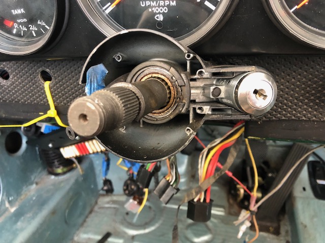

Here is how my '73 presently sits. You're welcome to come check it out and take photos and make some notes if you feel that would help.
Also, for sure get a copy of the wiring diagram as others have suggested as there were differences and mine has got the heated rear window option.
