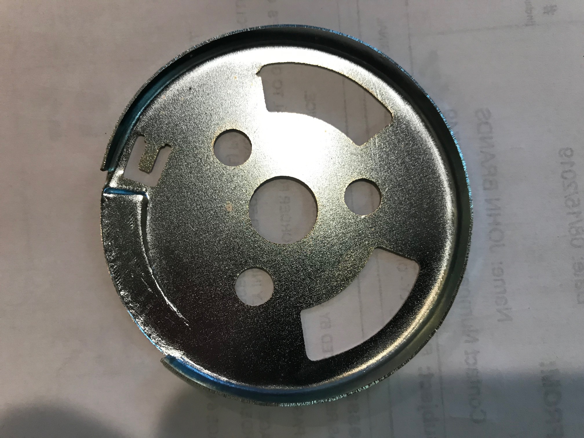

I am presuming that when the pad twists and locks into place it should be pretty secure?
I have tried it numerous times and have repositioned the plate on the back of the pad in all its possible orientations but the fit is really loose
Is there a knack or some way of adjusting the fit?

Check the horn rubber, may be worn or missing. 914Rubber makes a replacement

Tension spring is probably broken, it is the piece with the 3 loops.

QUOTE(Mike Fitton @ Aug 21 2019, 01:47 PM) *
No, its still there
I have a photo of the parts, Ill try to add it to the thread

tighten the three screws and make sure a horn boot is installed, also look at the three prongs on the horn spring and make sure that the strap spring ends are not broken

also we had these horn base plates made because of the clip breaking off

which part is a horn boot?
can you spot it on the photo?

the horn boot is missing looks like a squashed black megaphone

Put that $14.00 rubber boot in there and it feels brand new.
Hope that works for you and thanks to everyone who put out the suggestions.
