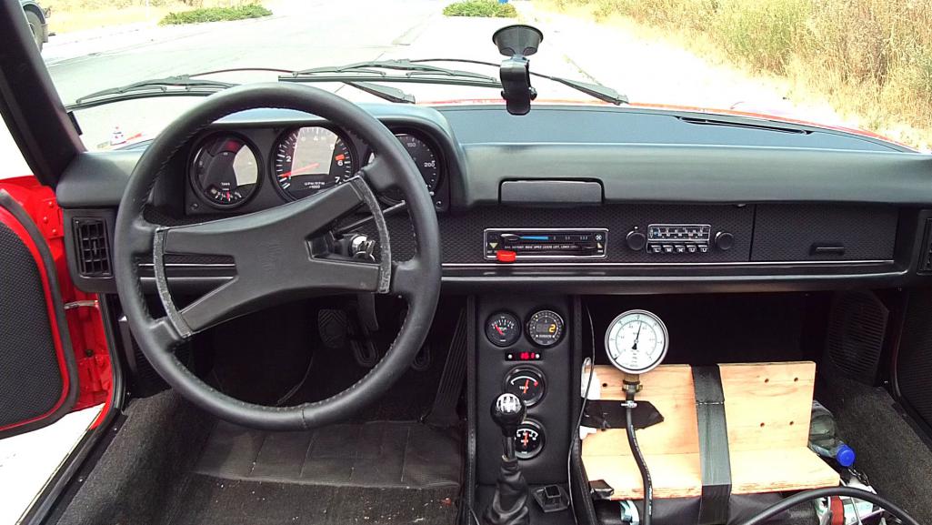

Went through this with two different engine combos, latest with same combo you are running.
Much easier and faster if you measure what you adjust.
If you hook up a vacuum gauge, using a T-Piece in front of the MPS and route the hose to the gauge, it's pretty easy to adjust the MPS, as you can clearly see in which region you are running (part load, transition, or full load).
Tune for drive ability first, then start to play with idle settings (ignition timing and maybe recalibration of AAR)

Good news is oil leaks are significantly better, and the engine gives nice power - a lot of fun to drive (IMG:style_emoticons/default/driving.gif) and the weather is looking NICE for the next few days.
