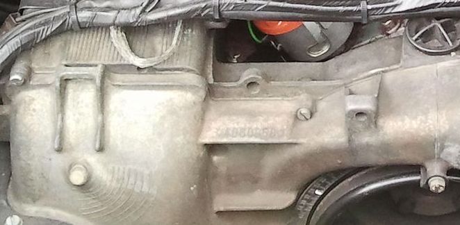

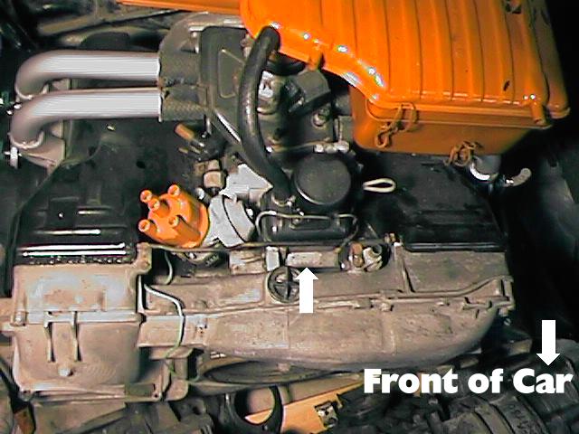

Hello folks. I’m a new member here. I am having a shop perform a PPI on a 1975 2.0 that I am looking to purchase. They can’t find the engine serial number. Isn’t it located on top of the engine, in front of the oil filler neck? Thanks.

ndfrigi

9**P-car
post Sep 11 2019, 01:03 PM
1975 2.0L
Posts: 17
Joined: 11-September 19
From: Virginia
Member No.: 23,450
Thanks for the Pic! On this car, that metal area is smooth - no numbers stamped. From what I have read, it may be a replacement block that doesn’t have a number.

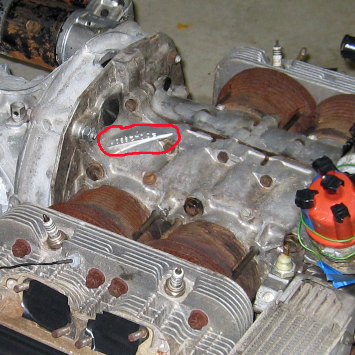

is it 2.0 or 1.8? if 1.8 the engine number is at different location. Attached Image

QUOTE(ndfrigi @ Sep 11 2019, 11:53 AM) *
Yes, mine is a 1975 2.0 and it’s by the oil filler in the same spot.

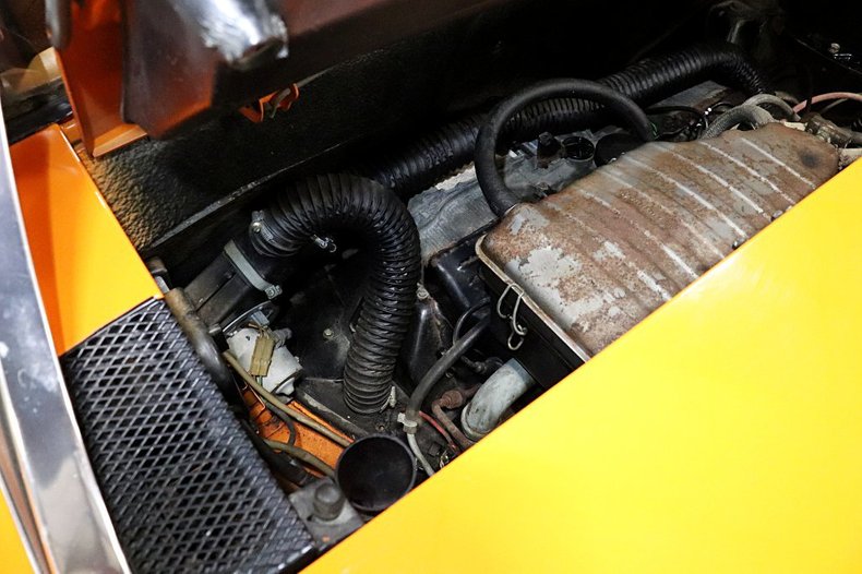

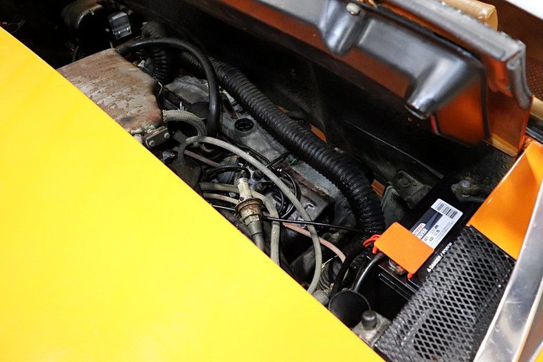

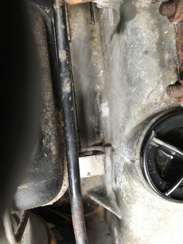

9**P-car
post Sep 12 2019, 03:46 PM
1975 2.0L
Posts: 17
From: Virginia
Member No.: 23,450
The first 2 pics are from the dealer selling the 914. The 3rd pic is from the mechanic performing the PPI. That area where the number should be is smooth.

If a 912E engine, the serial is located on the fan shroud. If a normal fan shroud is placed on a 912E case, then there would be no engine serial to be found.
