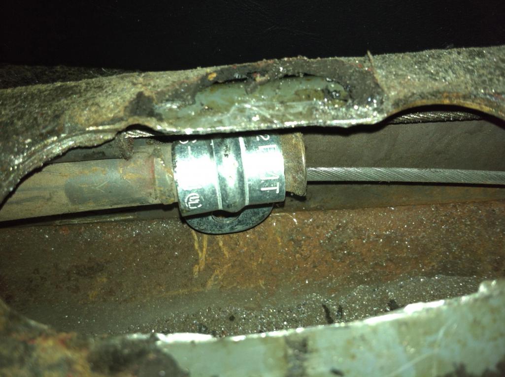

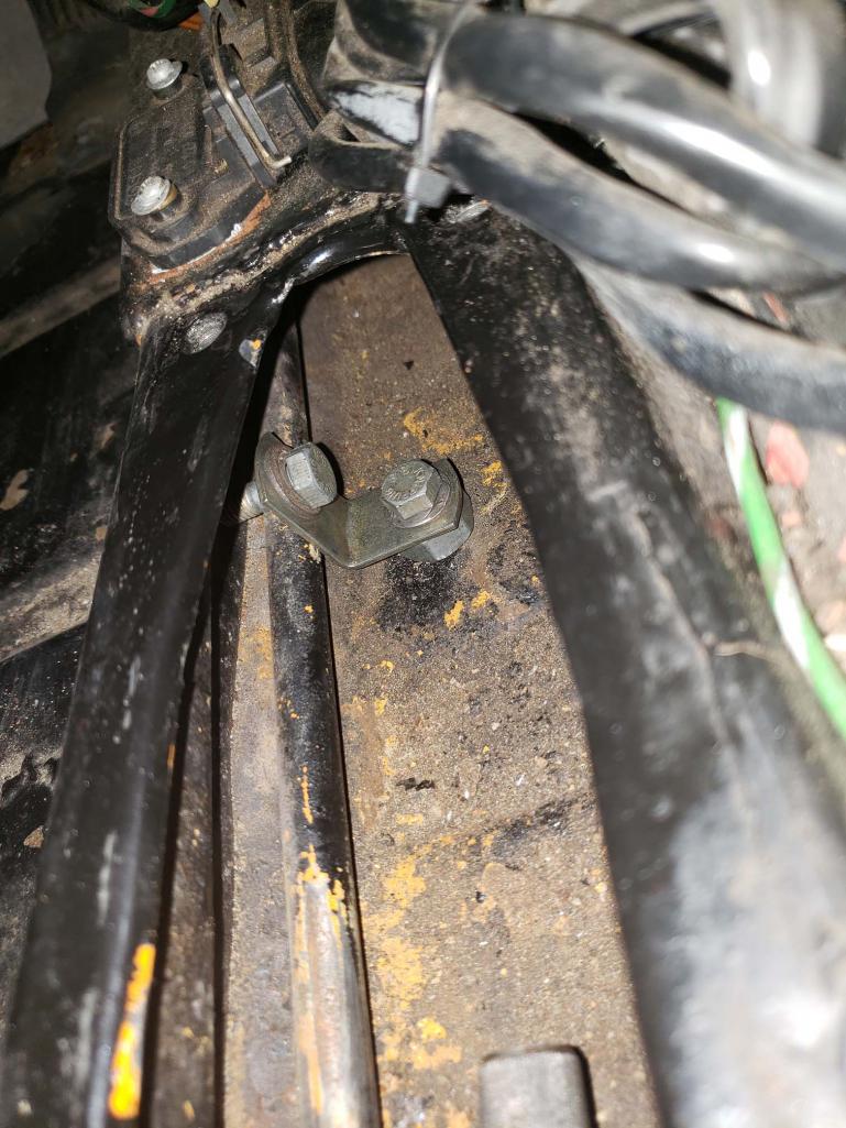

post Sep 24 2019, 04:27 PM
Resident German
Posts: 42,455
Joined: 21-January 03
From: Oakland, Kalifornia
Member No.: 179

QUOTE(SirAndy @ Sep 24 2019, 06:27 PM) *
Not sure what shifter you have, but make sure it does not contact those bolt heads. I had an issue with putting the bolt for the heater lever in wrong and it interfered with the shifter.
JMHO

There is no 'right'way really, but as you can see, several different solutions that get the job done. Some more elegant than others. This is the one I like. Stuff a #2 phillips screwdriver into the tube from inside the tunnel, so the welding does not burn through the tube wall and block the passage for the cable. drill holes for the welds. Clamp the tube to the tunnel and plug weld it to the inside wall of the tunnel:

QUOTE(Olympic 914 @ Sep 25 2019, 08:02 AM) *
Plenty of room, might be the angle of the picture but it's nowhere near the shift coupler.

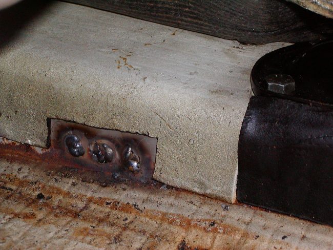

burton73
post Sep 26 2019, 11:55 AM
Senior member, and old dude
Posts: 3,976
Joined: 2-January 07
From: Los Angeles
Member No.: 7,414
QUOTE(jcd914 @ Sep 20 2019, 12:30 PM) *
A clable clamp can be used to secure the tube up front to the side of the tunnel.
Kind of fiddly to get in and leaves a couple holes in the side of the tunnel but for short term it might be doable.
Don't over tighten and crush the tube.
Jim
Andy,
This was the set up on 41 when I got it. Only 15 years on the road when it went in storage. Who knows how long it would have worked but I believe it did work as it was still tight when I took it off to weld a new set up in there.
Only use the U and nuts
Bob B

QUOTE(JeffBowlsby @ Sep 26 2019, 03:39 AM) *
QUOTE(DennisO @ Sep 25 2019, 07:11 AM) *
I read several articles on clutch tube repair. What is "the best and correct" method for this repair. Is there a specific article?
Seen that pic before but never seen measurements where you need to drill ? certainly the best solution IMO.
