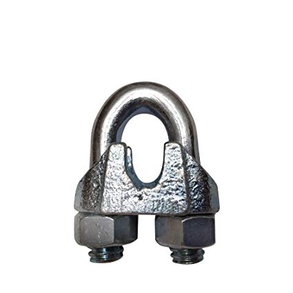

A clable clamp can be used to secure the tube up front to the side of the tunnel.
Kind of fiddly to get in and leaves a couple holes in the side of the tunnel but for short term it might be doable.
Don't over tighten and crush the tube.

QUOTE(jcd914 @ Sep 20 2019, 02:30 PM) *
Jim

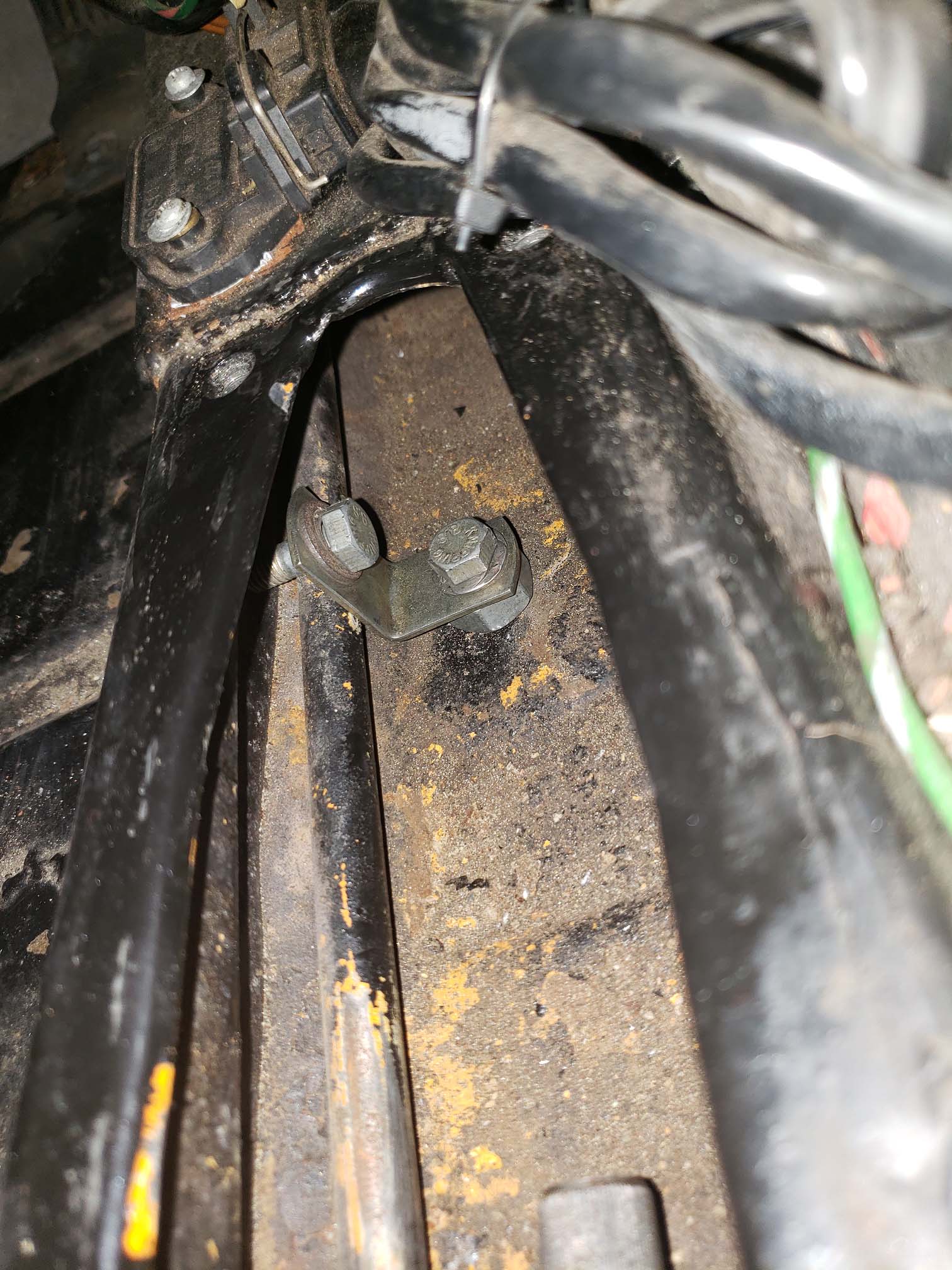

I put one of those in Betty's car 30+ years ago when we were dating. We were young and broke, and I didn't own a welder. So that was a quick and dirty fix. It is still there after 300K miles. I know it is not the correct way to fix it, but frankly, it is working. So I am not going to change it now.
Every time I run her car up on the lift, I see the ends of the bolts and I think "Maybe I should fix that right." But I always get distracted and forget about it.

QUOTE(SirAndy @ Sep 24 2019, 06:27 PM) *
Not sure what shifter you have, but make sure it does not contact those bolt heads. I had an issue with putting the bolt for the heater lever in wrong and it interfered with the shifter.

I put one in my car years ago as a quick fix as well. My clamp is oriented so the nuts are on the driver's side of the tunnel--in the footwell. I was JUST looking at it this past weekend and thinking "man I need to get that out of there and fix this thing right." welder.gif

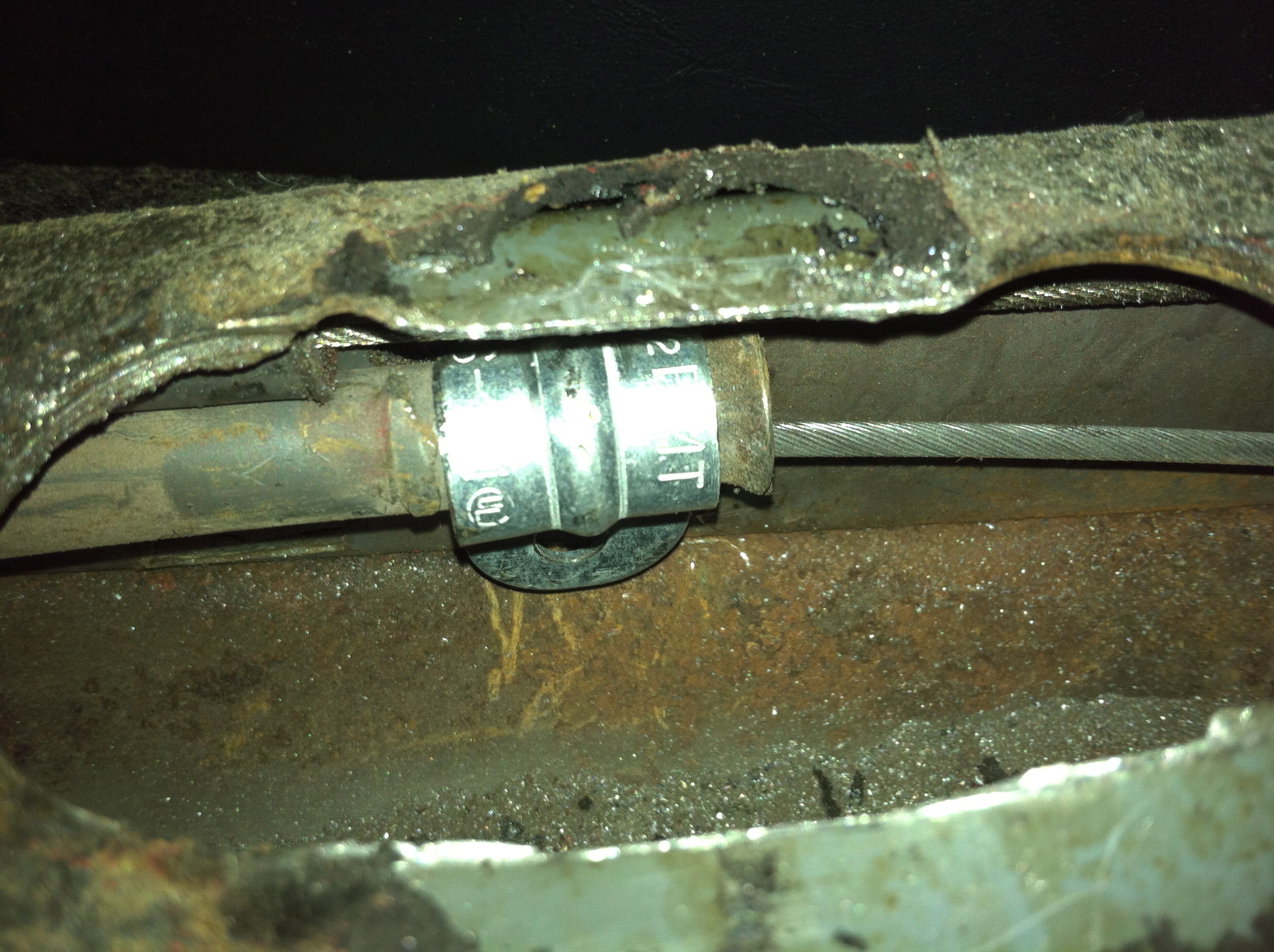

There is no 'right'way really, but as you can see, several different solutions that get the job done. Some more elegant than others. This is the one I like. Stuff a #2 phillips screwdriver into the tube from inside the tunnel, so the welding does not burn through the tube wall and block the passage for the cable. drill holes for the welds. Clamp the tube to the tunnel and plug weld it to the inside wall of the tunnel:
QUOTE(Olympic 914 @ Sep 25 2019, 08:02 AM) *
Plenty of room, might be the angle of the picture but it's nowhere near the shift coupler.

I used an electrical conduit clamp silghtly blacksmithed to the correct ID, then bolted it to the side of the tunnel. That tube aint goin nowhere !!

Andy,
This was the set up on 41 when I got it. Only 15 years on the road when it went in storage. Who knows how long it would have worked but I believe it did work as it was still tight when I took it off to weld a new set up in there.
Only use the U and nuts
Bob B
ssuperflyoldguy
10 electricians, 11 different ways of doing it (this one is a pretty elegant & brave way of repair) - I also have a loaner 120v welder in the Bay Area if needed (but any invitation by TygaB is always the best)
