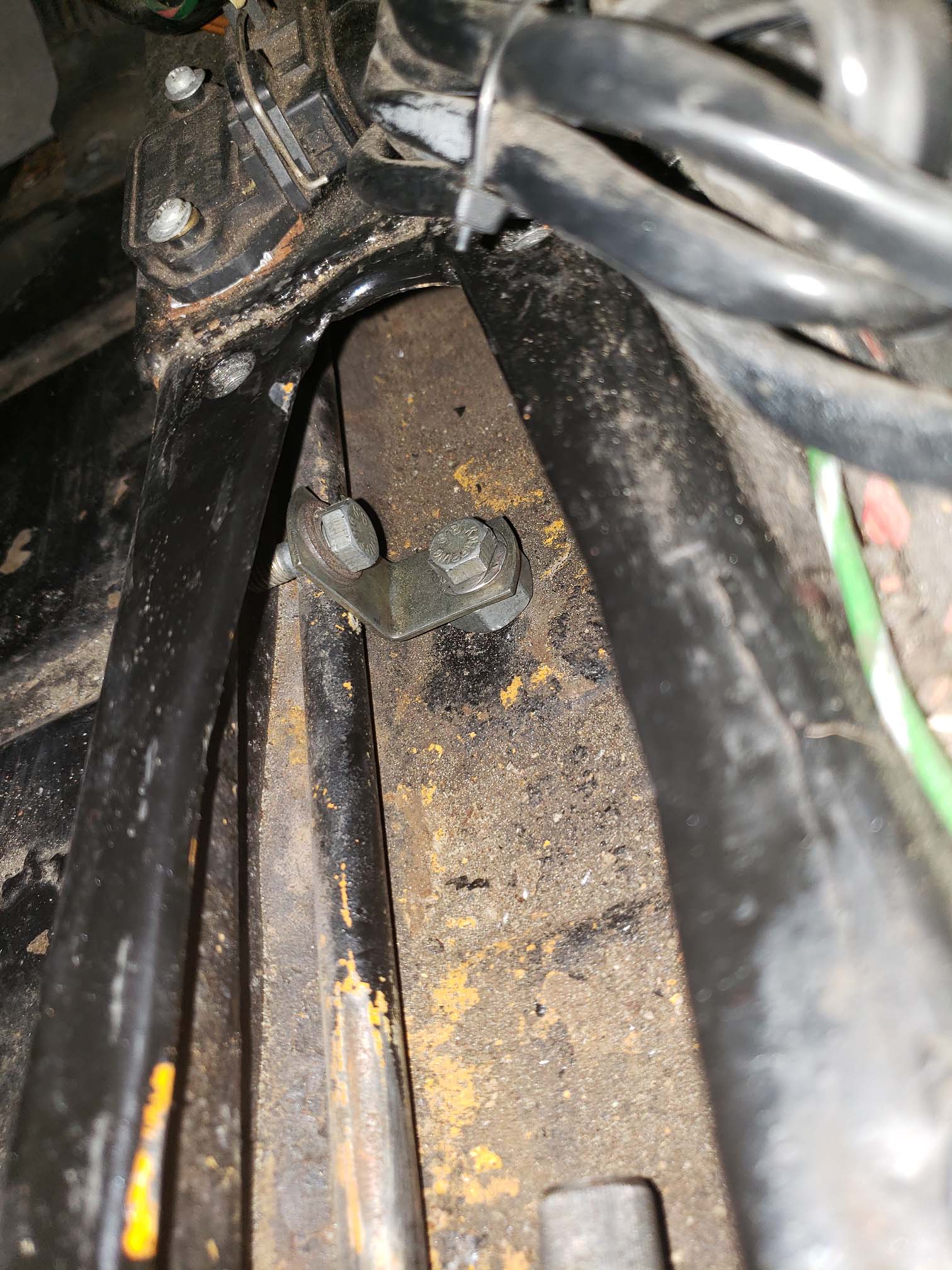

post Sep 24 2019, 04:27 PM
Resident German
Posts: 42,455
Joined: 21-January 03
From: Oakland, Kalifornia
Member No.: 179

QUOTE(SirAndy @ Sep 24 2019, 06:27 PM) *
Not sure what shifter you have, but make sure it does not contact those bolt heads. I had an issue with putting the bolt for the heater lever in wrong and it interfered with the shifter.
JMHO

QUOTE(Olympic 914 @ Sep 25 2019, 08:02 AM) *
Plenty of room, might be the angle of the picture but it's nowhere near the shift coupler.

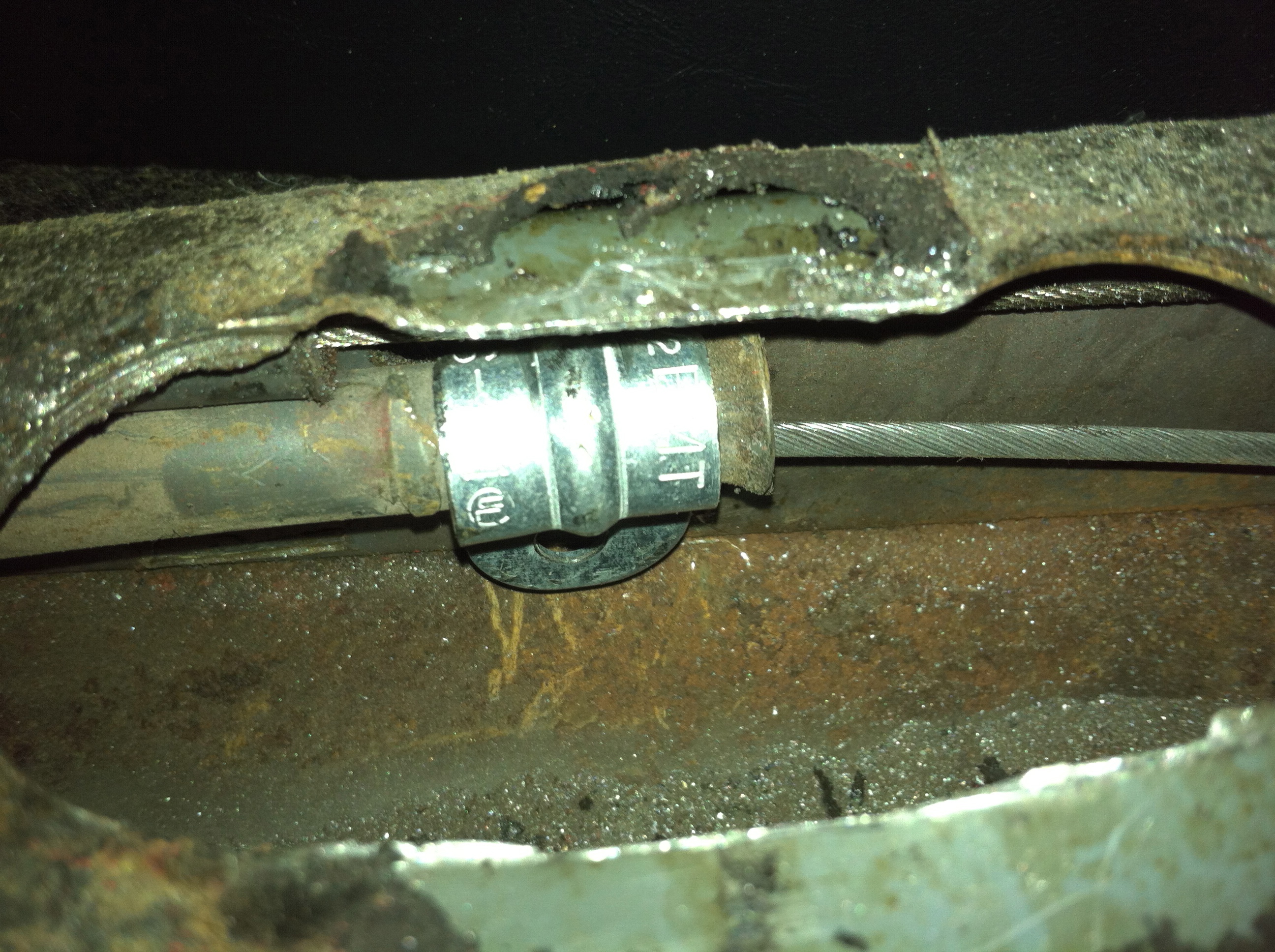

Andy,
This was the set up on 41 when I got it. Only 15 years on the road when it went in storage. Who knows how long it would have worked but I believe it did work as it was still tight when I took it off to weld a new set up in there.
Only use the U and nuts
Bob B
