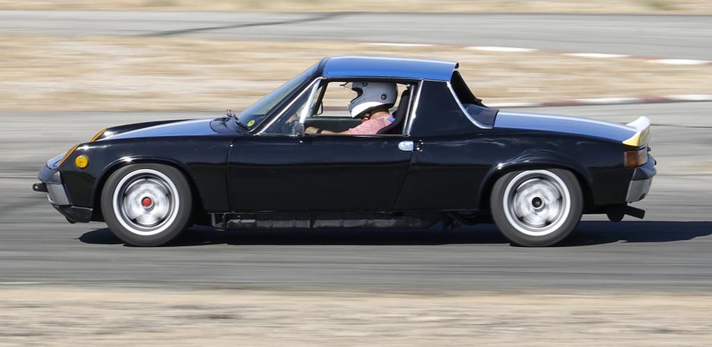

1st track day in the bag with the new 914, no decent pics yet (there was a photog in attendants, but haven’t seen his pics yet). Car rand great and although running with much newer machinery she was holding her own once her driver brushed off the cobwebs... (IMG:style_emoticons/default/driving.gif)
Since this was essentially her first shakedown I found a number of little things I need to address, one in particular I’m questioning:
After a few laps I noticed - mainly on a flat sweeper turn, when entering hard on brakes and trailing off while turning in I’d get a soft groan from my outside wheel (drivers in this case). I’m thinking wheel bearing? I’ve never had one go bad on the front spindle before, so I’ve never heard or felt the slight vibration before. Never really occurred on any other turns.... thoughts?

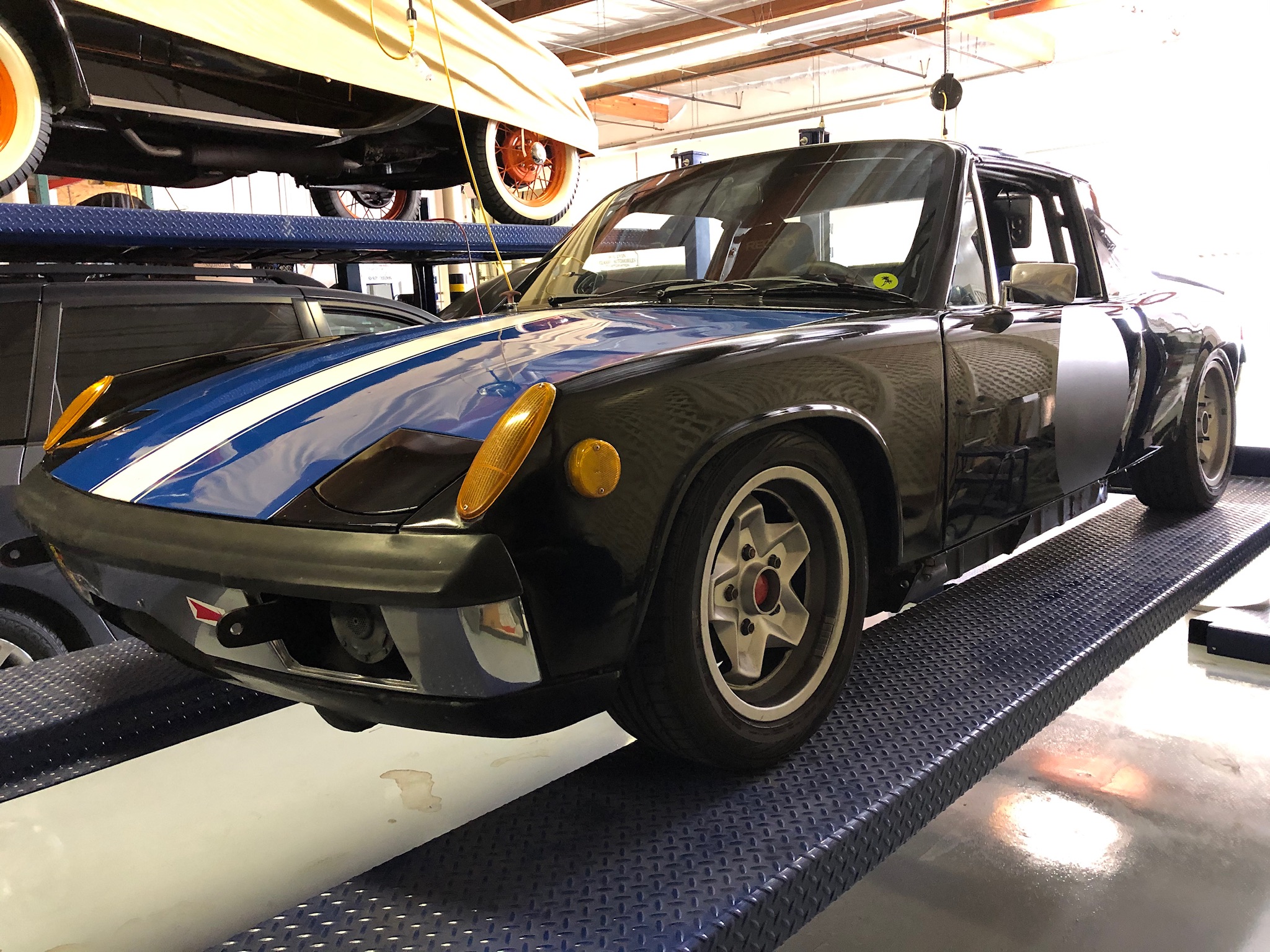

Took a hard look, couldn’t see any rubbing, autocross on sun, will see what she does then. In the meantime, putting on number graphics, she’s starting to look like a proper race car...

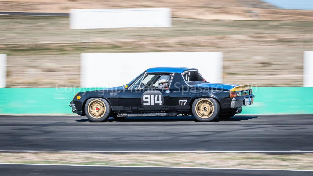

Photo credit: @garyambrose1256

Wheel bearings usually make noise under lateral load regardless of brake pressure. That said, on track cars they're a consumable and not terribly expensive so I'd suggest switch them out.
What brakes, pads, etc are you running?
Sweet looking car btw.

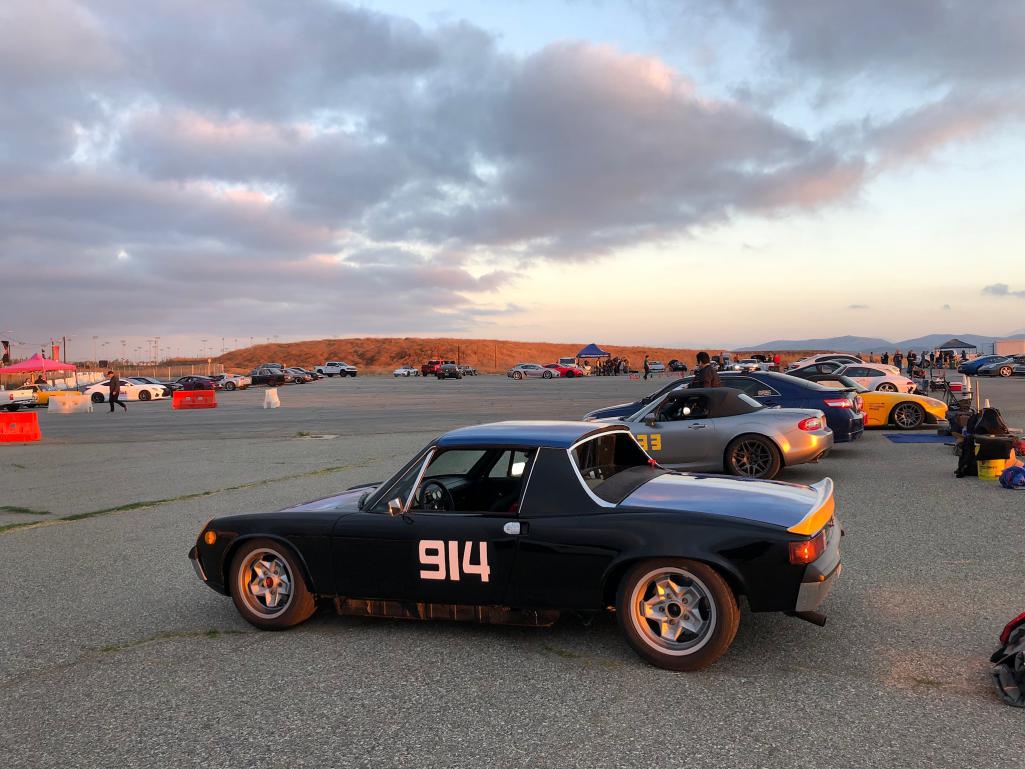

October autocross with POC, nothing too eventful, gotta get rid of the rust, then find my balls! Had mandatory instructor for most runs, in the end let me run solo. Said he’d put in a good word to allow me a check run at next autox to get out of “student” classification.
Morning pic in the OC...

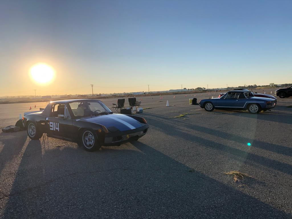

Nov autocross, I’m starting to get hooked... definitely fun, but still prefer the big track. But this is so easy and cheap while dusting off the webs. Check run, first one out (IMG:style_emoticons/default/blink.gif)
Laid down solid 2 runs with chief driving instructor, upgraded my wristband to a real drivers band. (IMG:style_emoticons/default/piratenanner.gif)
Another morning pic, but this time I was in good company:
Nice driver mostly stock 2 liter, driver was a young autox junkie coming off a 2 year hiatus, all day in practice runs I was a hair quicker... then when it counted, I botched it! (IMG:style_emoticons/default/headbang.gif)
My timed runs involved a little bowling, and lost time cause I forgot the course and wasn’t looking far enough ahead, so critical turns ended up being surprises where I left a ton of time on the table.... All my timed runs were over 3 seconds longer than my typical practice runs.... (IMG:style_emoticons/default/hissyfit.gif) I watched his timed runs as I was packing up, he definitely laid down some good laps, much faster than my practice times...
Ok, so gotta work on my performance anxiety too... (IMG:style_emoticons/default/barf.gif) All in, hard to complain when finally doing what I’ve wanted to do for over 20 years now... There were 5 teeners including mine on sun, nice people all very glad to see another 914 over the newer hardware.
