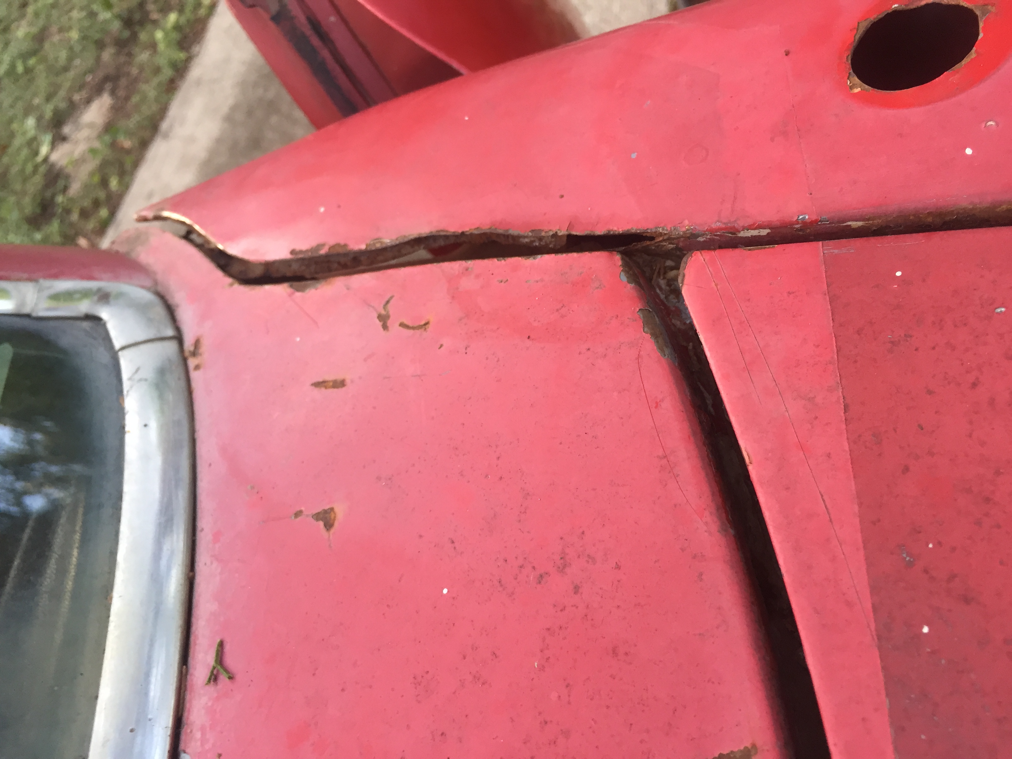

RUSTY FENDER TIPS:(IMG:http://www.914world.com/bbs2/uploads_offsite/i.postimg.cc-7222-1571969095.7.jpg)
(IMG:http://www.914world.com/bbs2/uploads_offsite/i.postimg.cc-7222-1571969096.8.jpg)

Oh yeah, before it got on the rotisserie I had to address the fender to cowling issues... both fender's "pointy tips" by the cowl, were rotting away. I cut them off and welded on replacements:
Before, during -
