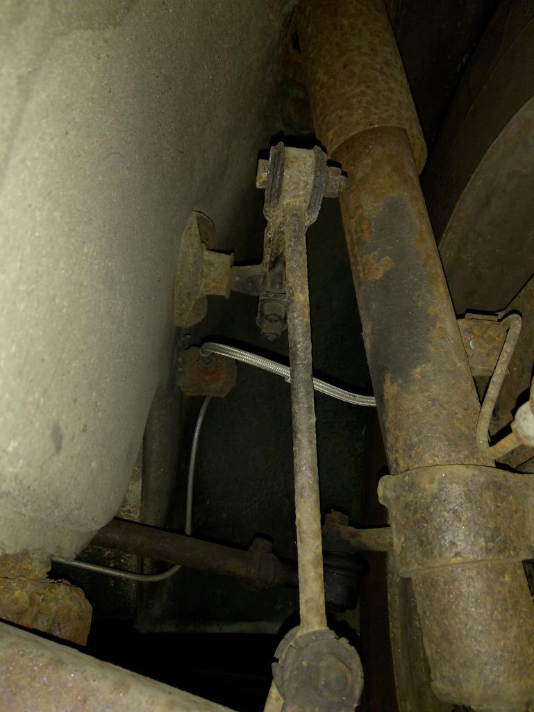

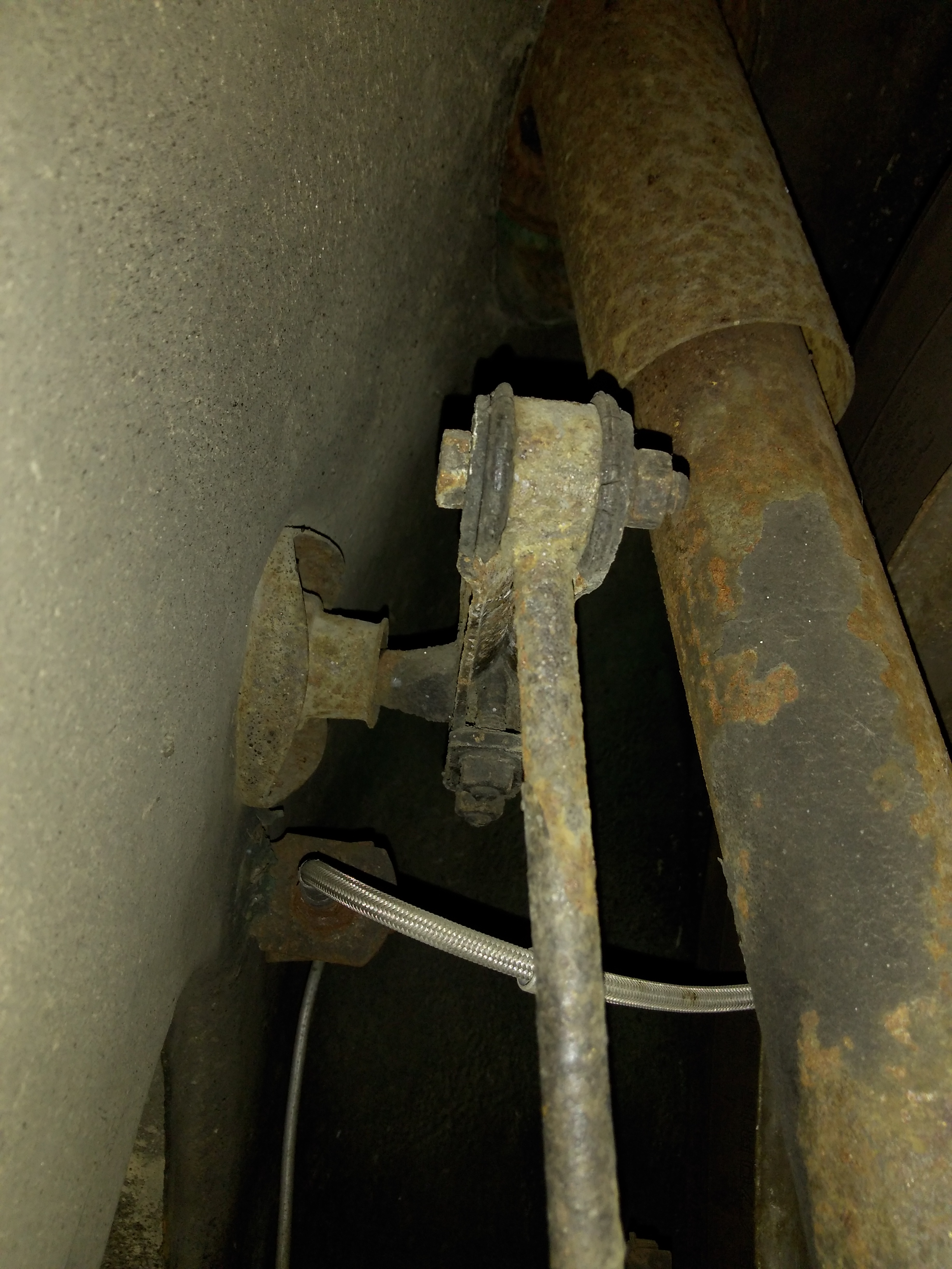

QUOTE(ClayPerrine @ Nov 5 2019, 04:21 PM) *
The 70 models were not available with a sway bar. And I think you got both front and rear bars in 71-72.
My March 70 -6 has the front sway bar, but no rear.
I bought it in '77 and it was there at that time. No history prior to that, but think I'm the second or possibly third owner.

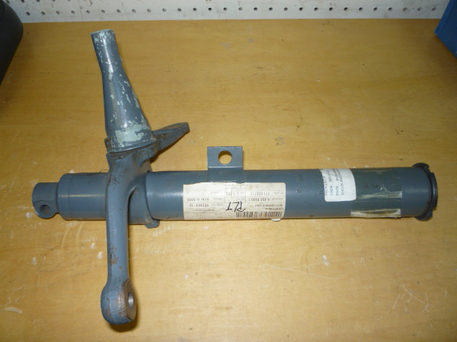

altitude411
post Nov 5 2019, 10:18 PM
I drove my 6 into a tree
Posts: 1,306
Joined: 21-September 14
From: montana
Member No.: 17,932
QUOTE(poulinatwop @ Nov 5 2019, 08:37 AM) *
1) what would the original suspension have been on the car and what color were the shocks?
2) Would the car have come with a front sway bar or did the PO add that?
3) The engine is original to the car but at one point the PO tossed the air filter housing. Anyone have a line on where i can find and original air filter housing?
Thanks in advance
1)Attached Image
3)Here's some info on 914-6 air boxes...
http://w.914world.com/bbs2/index.php?showtopic=337394

fixer34
post Nov 7 2019, 07:28 PM
Posts: 1,488
Joined: 16-September 14
From: Chicago area
Member No.: 17,908
QUOTE(mtndawg @ Nov 5 2019, 06:11 PM) *
Pics needed
If you were asking me, here you go. I can pull the tire and get better ones this weekend if needed. I know I didn't add it and I've had the car since 1977. There was nothing done to the car that I could tell when I bought it except the muffler had been replaced with the dual muffler Monza style. (and the rear valence discarded....) Attached Image Attached Image
ClayPerrine
post Nov 8 2019, 07:18 AM
Posts: 16,568
Joined: 11-September 03
From: Hurst, TX.
Member No.: 1,143
QUOTE(fixer34 @ Nov 7 2019, 07:28 PM) *
Pics needed
Probably installed by a previous owner, like our six. I disconnected it because the hole on the left side is torn out. It will be restored to no sway bar when the body work is done.
