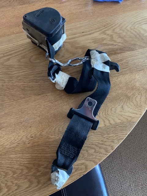

I know the OP is talking about the receivers but there has been mention of the retracting part as well.
I took two of them somewhat apart recently - but I did NOT take the cover (the thinner of the two) that houses the coil spring off.
Instead, I fully extended the belt and then pushed the webbing back thru the metal bar where it is held by another bar that runs through a pocket in the belt. Slide the bar out but be mindful that the bar will spin (quickly) if released.
I put a screwdriver in the slot that kept the retractor in this position while I put the belt in a bucket of Woolite-water and washed 'em out and hung them out to dry.
While they were drying, I took the screwdriver through the slot and advanced the rod to the point where it wouldn't go any more and then backed off a half-turn. It did seem to add significantly to the amount of tension in the retraction action.
I did add a small amount of silicone lube to where the bar spins and then put the belt back through the slot, securing it with the pin. It retracted quite well and I'll be putting them back in the car in a couple of weeks. I'll report back....probably in a separate thread.

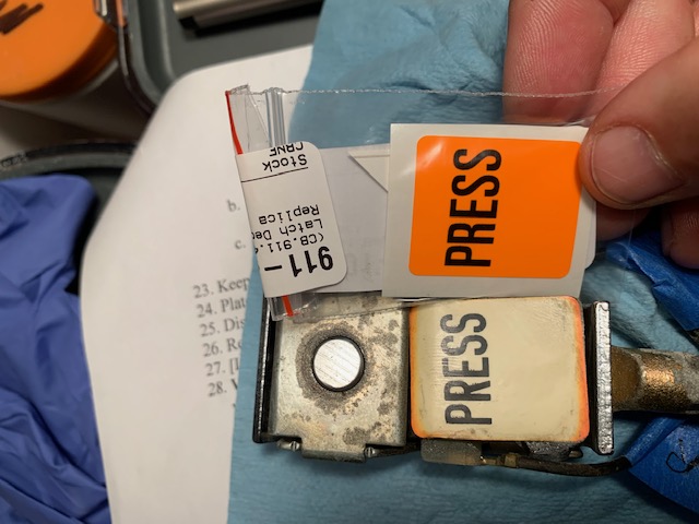

@Mikey914 Mark, I didn't know that you carry the stickers or I'd have asked you to put them in with my visors (still in transit). Mine are from Pelican (I believe made by Carbone). They look nice to me but I've since been made aware that they are not a perfect reproduction because the 'R' is incorrect (see pic below the sticker next to the original). The image on your website also looks the same. If possible, it might be a good idea for you to change the R and not only have the best price but also the most correct replacement.

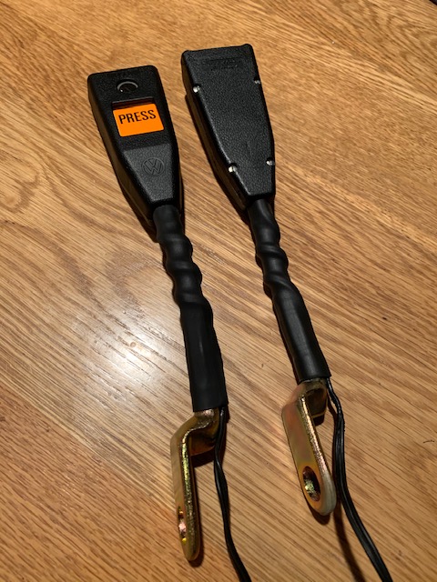

I finally had some time to complete the restoration on the seat belt receivers. Replated the steel bases and screws, repaired and cleaned the wires as well as the connector, new 4-1 heat shrink, new stickers, and SEM plastic paint. I'm really pleased with the result. I wish the retractable part would be this easy...

I'm re-installing my retractors today and I'm hopeful they'll be improved. I didn't take them apart but did pull the belts all the way out and removed and washed them. I shot some penetrating lube in both sides of the axle and then re-wound it to maximum (til it stops) and then backed off half a turn. Cleaned up the other external hardware, re-installed the belt and I think i'm good to go. Lots o dirt comes off those belts even when they look clean.
