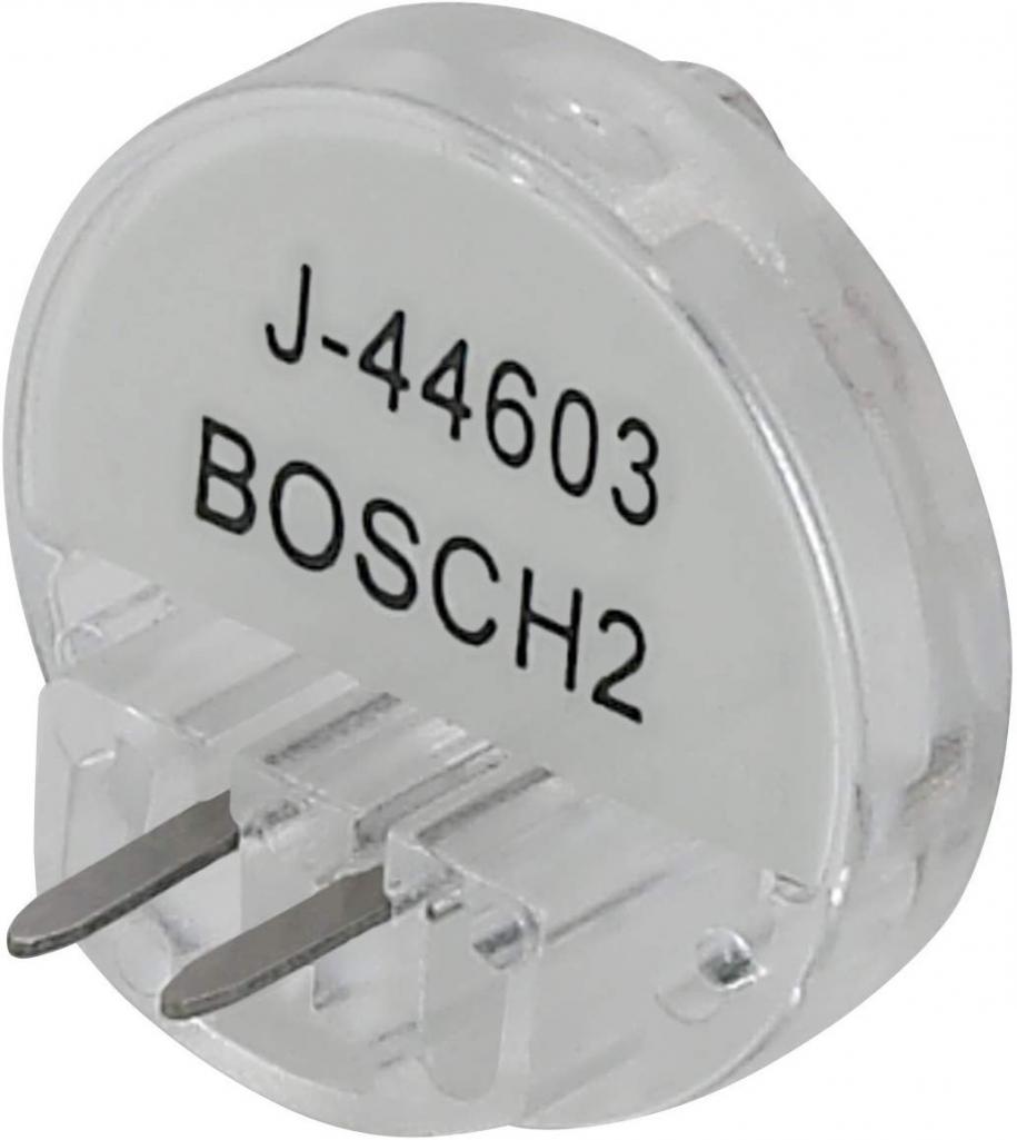

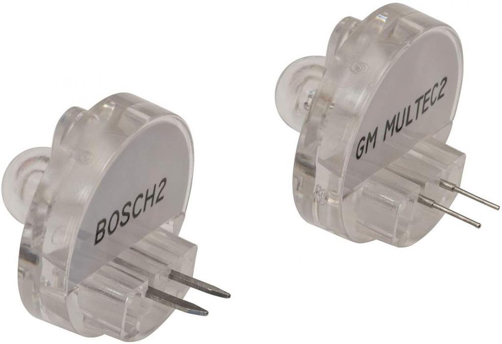

I found these on amazon. Anyone use these before?
OEMTOOLS 27319
OTC 6266

I could use the Bosch ones too but haven't seen it separately for less than half a whole set.
A DVM reacts too slow to read but will fluctuate letting you know it's being triggered, so technically yes.
Also, since injectors click, you could plug in a known working one and either listen or feel.

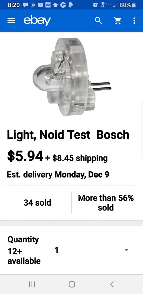

I bought a Harbor freight set for $12.
They work ok. It is just a bunch of different terminal types.
I don't think they pick up every pulse. Response seems inconsistent. I had a Subaru fi system that I wanted to check injector signal.
Saw these on ebay
