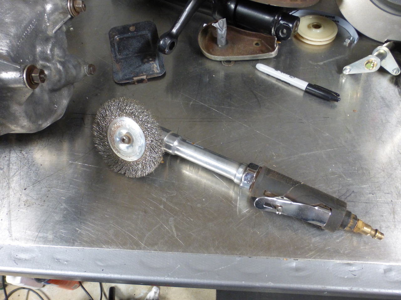

Purchase this from HF, extended angle grinder and a wire brush wheel, cut the 1/4 stud off the wheel and drill hole to fit grinder. I did my entire exterior floor and inner fenders in four hours. Best, MarkAttached Image

QUOTE(mlindner @ Dec 24 2019, 09:36 AM) *
I like it. The low profile head will have advantages over the Wurth tool in tight quarters. I don't know that I've ever seen that tool in a HF store but I'll be looking next time!
Just be sure to wear a face shield. Spinning a wire wheel at air tool speeds can shed those wires as very dangerous little projectiles.

Superhawk996, and I think it was only $25.00. really worked great up in the tight 914 inner fenders.

The extended angle grinder is really clever, will get one asap... Many thanks for sharing!
