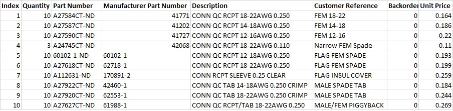

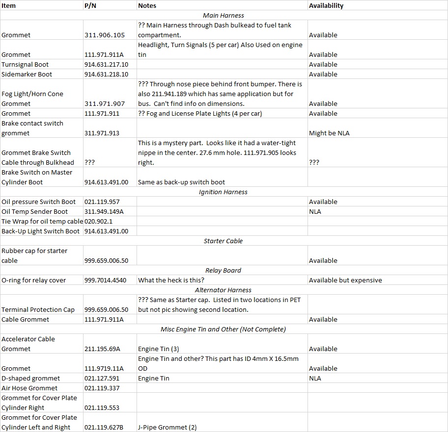

I'll just add a little to the already excellent advice given. You can buy OEM (AMP) connectors at digikey. They are high quality and an exact match of what came originally in these cars. Here is a list of some of the part numbers I used rebuilding my harness:
You can use generic grommets but OEM are still available but a bit of a PITA to source. Most of the grommets are blanked sealing grommets so IMO, using open style grommets is not at a professional level as they won't seal out water or air like the originals. Here is a list of part numbers for most of the grommets. If you want the spreadsheet that includes source links, PM your email address.
As for soldering, follow the earlier advice and do not solder terminal connectors for the reasons @Superhawk996 described. From what I have read, soldered terminal connections are not allowed in aviation applications. That says something. However, DO solder wire splices if you have to make them. Use a lineman's splice , solder it, and protect it with heat sink. I match the heat sink color to the wire and add match tracers with colored sharpies just for that extra touch.
914Rubber sells OEM harness tape if you want to match the original. You can also get it on ebay. I think the brand is Telsa but can't remember for sure.
Hope this helps.

QUOTE(bbrock @ Jan 3 2020, 09:37 PM) *
That is an incredibly useful list of small parts. Thank you for sharing. It must have taken a ton of time to research all those part numbers.
@SirAndy
That list should get moved somewhere for ease of acess long after this thread disappears off the front page.

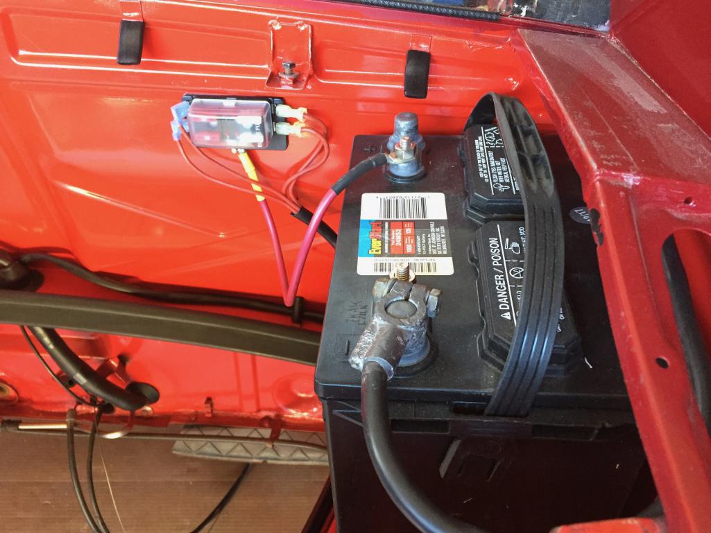

Agree here, I had to install a new to me main harness & was afraid of a short somewhere.
here's my new fuze box.

QUOTE(barefoot @ Jan 4 2020, 08:29 AM) *
QUOTE(Costa05 @ Jan 3 2020, 10:43 PM) *
If you are a bit detail obsessed like me, I found that brake cleaner, hard nylon brush, then a soapy water can clean up a tired existing harness pretty well. Rewrap it with new cloth tape from HD.
Also I would add new fuse terminal block to the four main high amp feed wires (10 ga. red) coming off your battery terminal block. I think the stock setup is a bit under designed in my opinion (mine was) Cheap easy insurance.
Exactly. That is a clean install.
