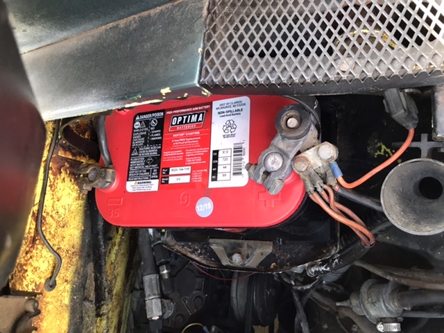

@bbrock Check my install. BTW the battery hold down clamp is NOS (IMG:style_emoticons/default/poke.gif)

Pict
When I get some time I will straighten up my wires.
