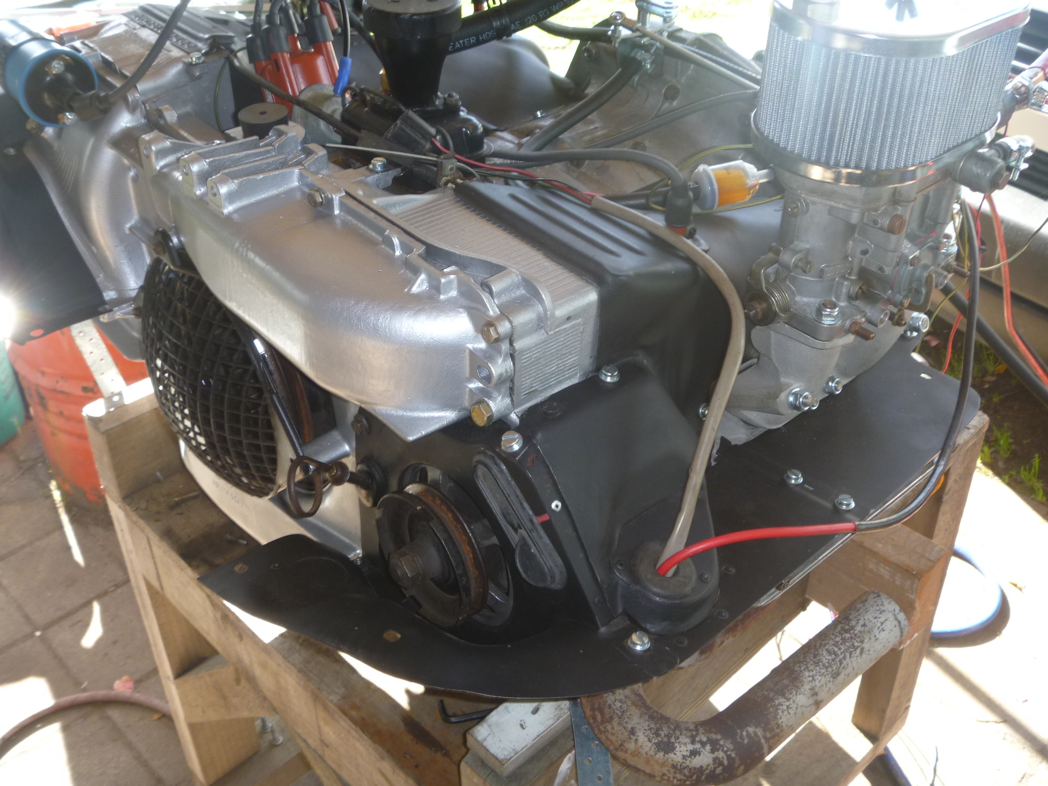

Just done a 1.8 carb cam motor on Dellorto DRLA's 36mm easy to tune with 28mm vents,nice idle with easy starting,I really like these carbs.
40mm will run fine with 28mm vents on a mild small bore motor,and provide a good driving street car.
I'am constantly amazed @ the amount of folks trying to run oversize carbs on these engines ,they just run like (IMG:style_emoticons/default/stromberg.gif) and are SO hard to tune due to poor vacuum signal ,leave the big carbs to the high rpm big horsepower big bore motors IMO.
