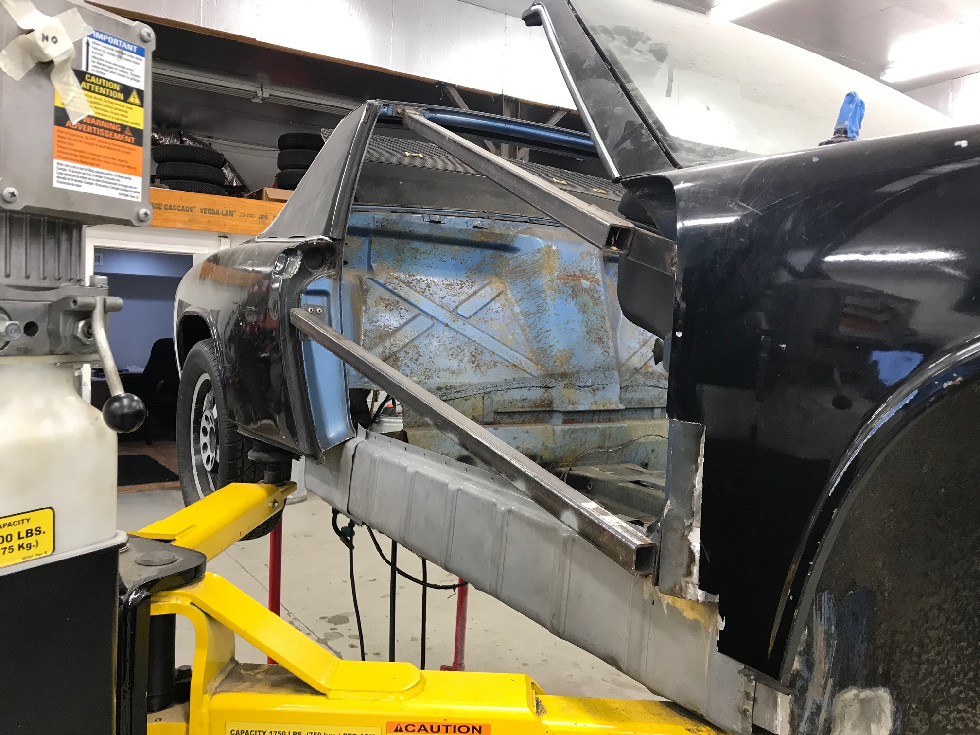

You can pick up a set from Tangerine Racing, they allow you to leave the doors on throughout the process to monitor door gap easily.
http://www.tangerineracing.com/tools.htm
Alternatively, just grab some box tube, turnbuckles, and some scrap and weld up your own set. I did mine very easily (I'm a CSOB, and put the $$ toward replacement sheet metal), and made them in a similar fashion to be able to monitor door gap.

Heim joints and threaded bungs to make adjustable braces are cheap and available on Amazon.

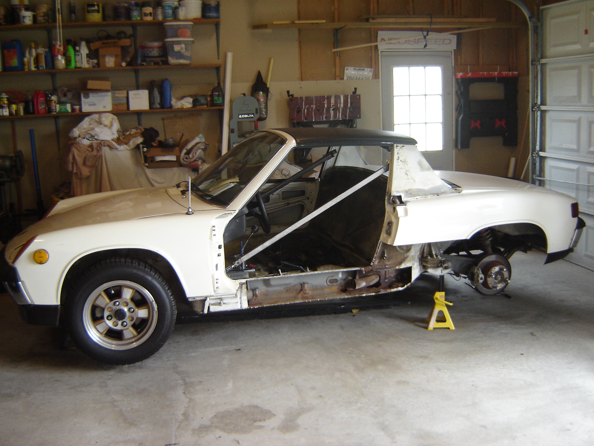

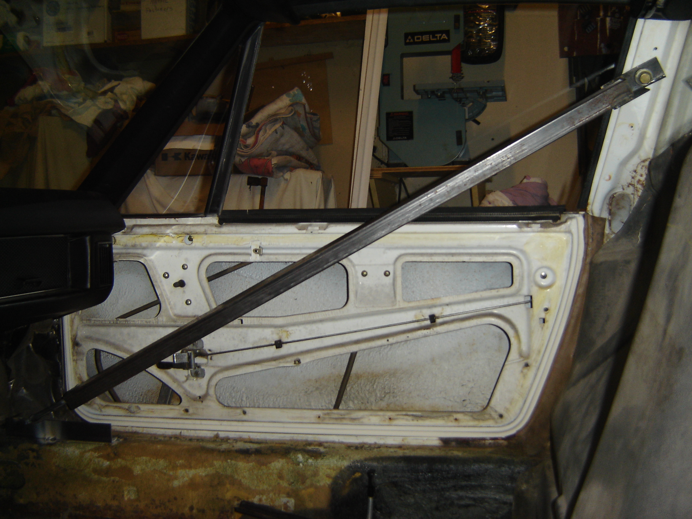

I also built mine using square tubing and turnbuckles. The top of the brace mounted at the shoulder belt pivot and I welded the lower end to the top of the longs, inboard enough that I could also close the doors. I'll have to look and see if I've got any pictures of them.

I had to walk out in the garage and measure them. Looks like 4” turnbuckles. No special rating. They just felt stout enough when I was shopping for the components.
