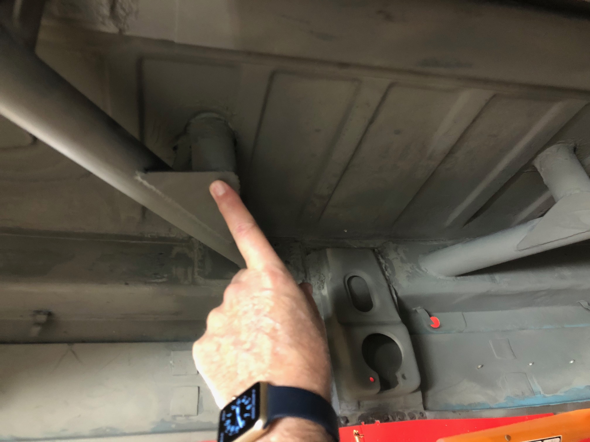

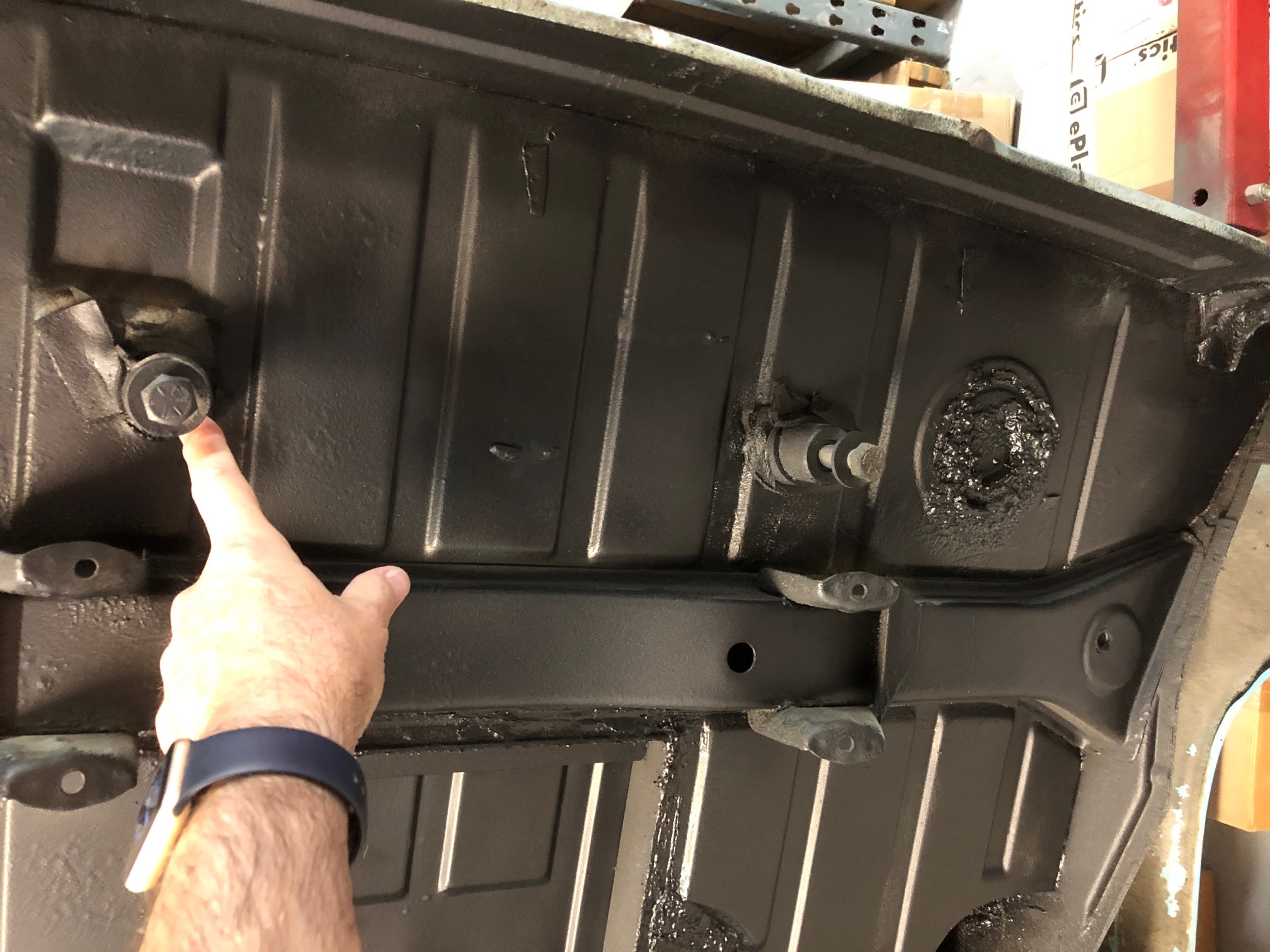

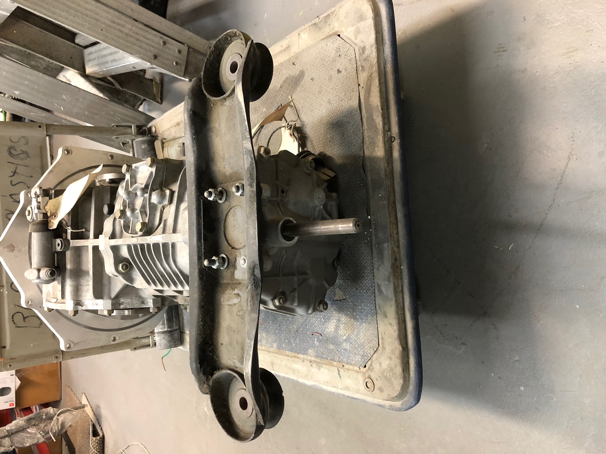

OK, these are pictures of my V8 car as far as the 930 trans, body mods to make the trans rear support fit the 914 body and the top view of rear trunk to show how I put in the moved back trans support as well as the factory 930 rear trans support mounted to the trans. Stock 930 trans mount on a flipped 930 so it hangs down and is not under the trans.
You can come down to my shop in Inglewood that you have been to see if this is an option for you on a 915 box. I am going to use Cable Shifts set up for linkage. You can use the same with a 915

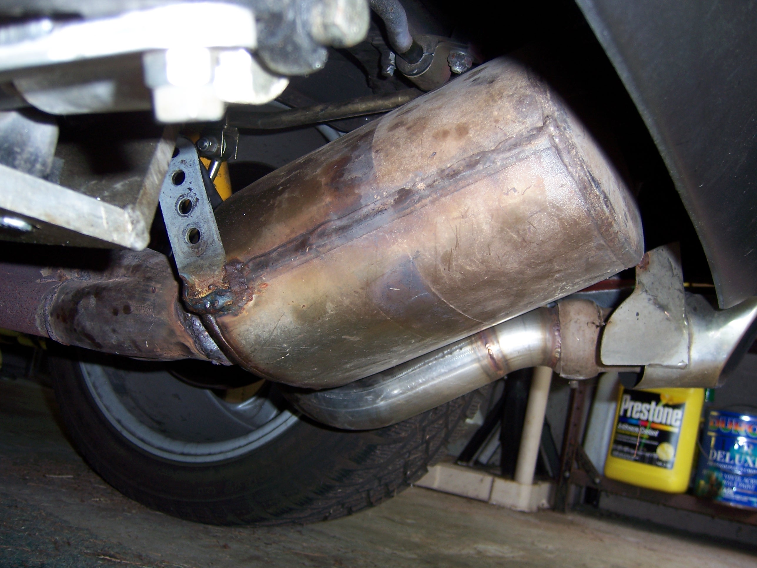

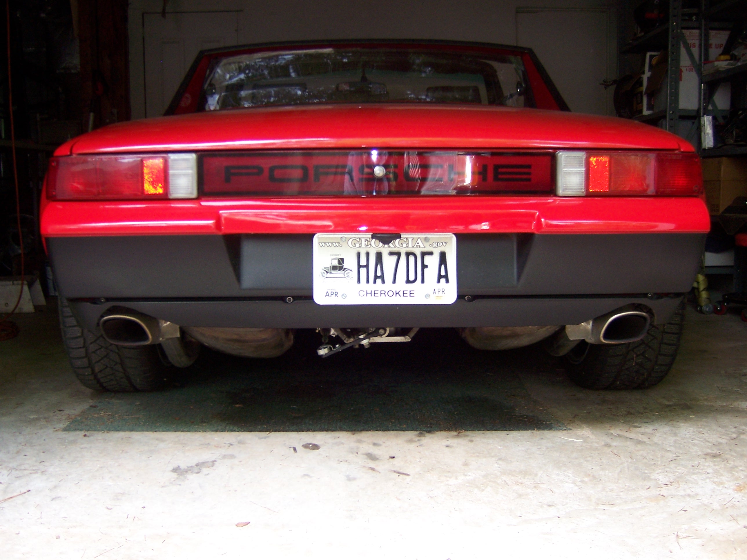

I have this muffler on each side. I can't remember if they are from a 993 or 996 (according to the guy I purchased the car from).

QUOTE(sharper @ Jan 28 2020, 05:14 AM) *
I have this ordered muffler on each side. I can't remember if they are from a 993 or 996 (according to the guy I purchased the car from).
I have an extra set of 993 mufflers and tips, that back end looks great.
I like the color keyed bumper top too.

The bumpers are fiberglass (car is a '75 model) and the guy I bought it from said the painter got the black and red backwards on accident. But he liked the look on the car and I agree that it looks great. Both front and rear bumpers are like this.

QUOTE(sharper @ Jan 28 2020, 10:46 AM) *
I agree, it looks good. Could you post a photo or two of the front bumper? Thanks.
