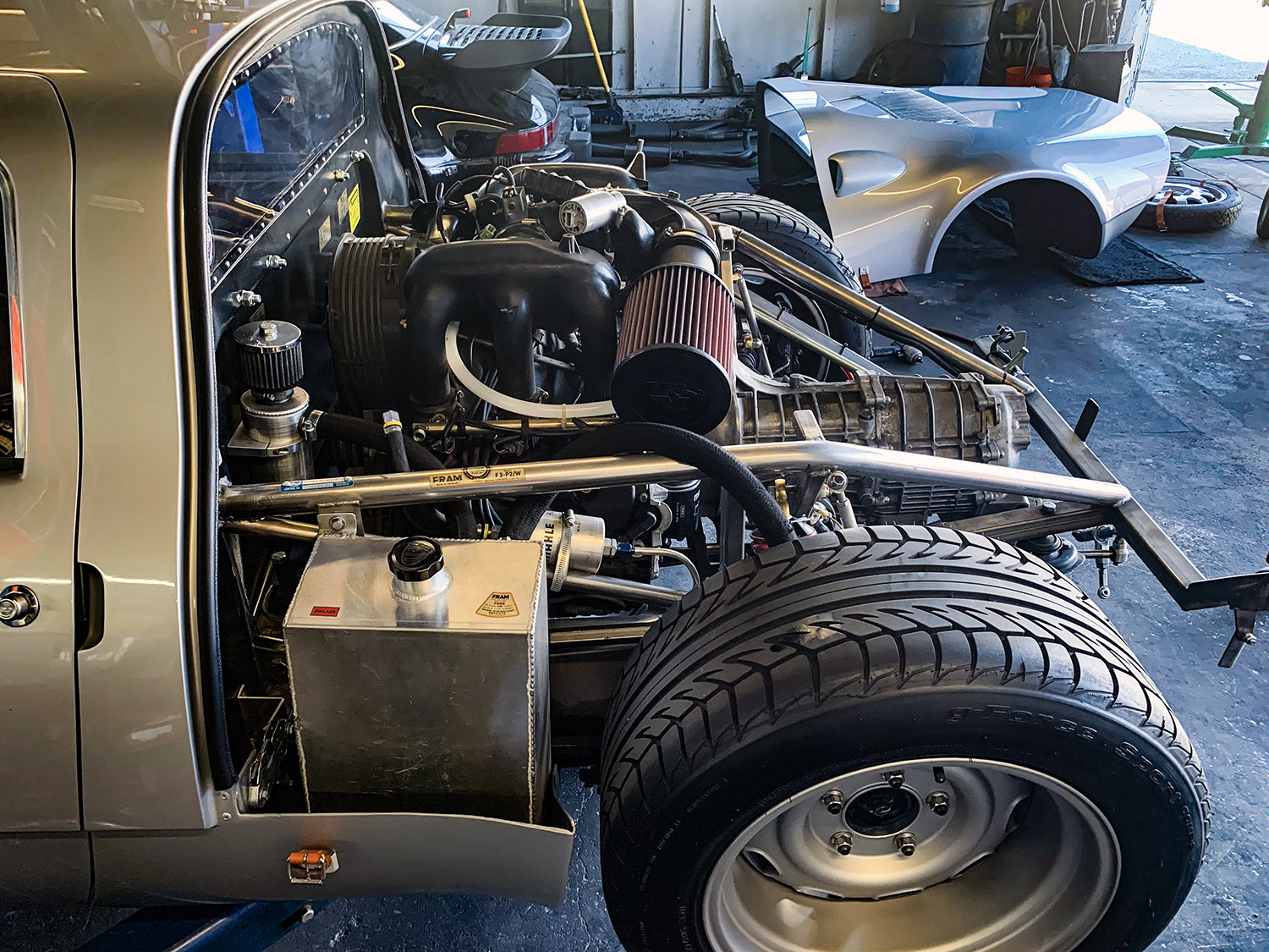

I was at my mechanic's the other day getting some work on my car (the one that is actually assembled and running) and he had a Beck 904-3.6 in the shop with a 915.
It was such a simple mounting system for the tail end of the 915 I was again wondering if anyone was making a simple 914 chassis to 915 tail adaptor. The Bott kit seems great, but costly—same for the Evo.
I figured if this works for the Beck—mounted straight onto a square steel tube with a simple shift rod—couldn't I get solid clean shifting out of something similar for a lot less than (some very pretty and well made) alloy tailpiece?

Unfortunately no, but I should be able to get some in a few months when it is back in the shop. It was a solid rod with a couple of links,
Im thinking it looks like a cable system would probably work easily if there is a simple clean mount fo the tail. I know Patrick used to make one.

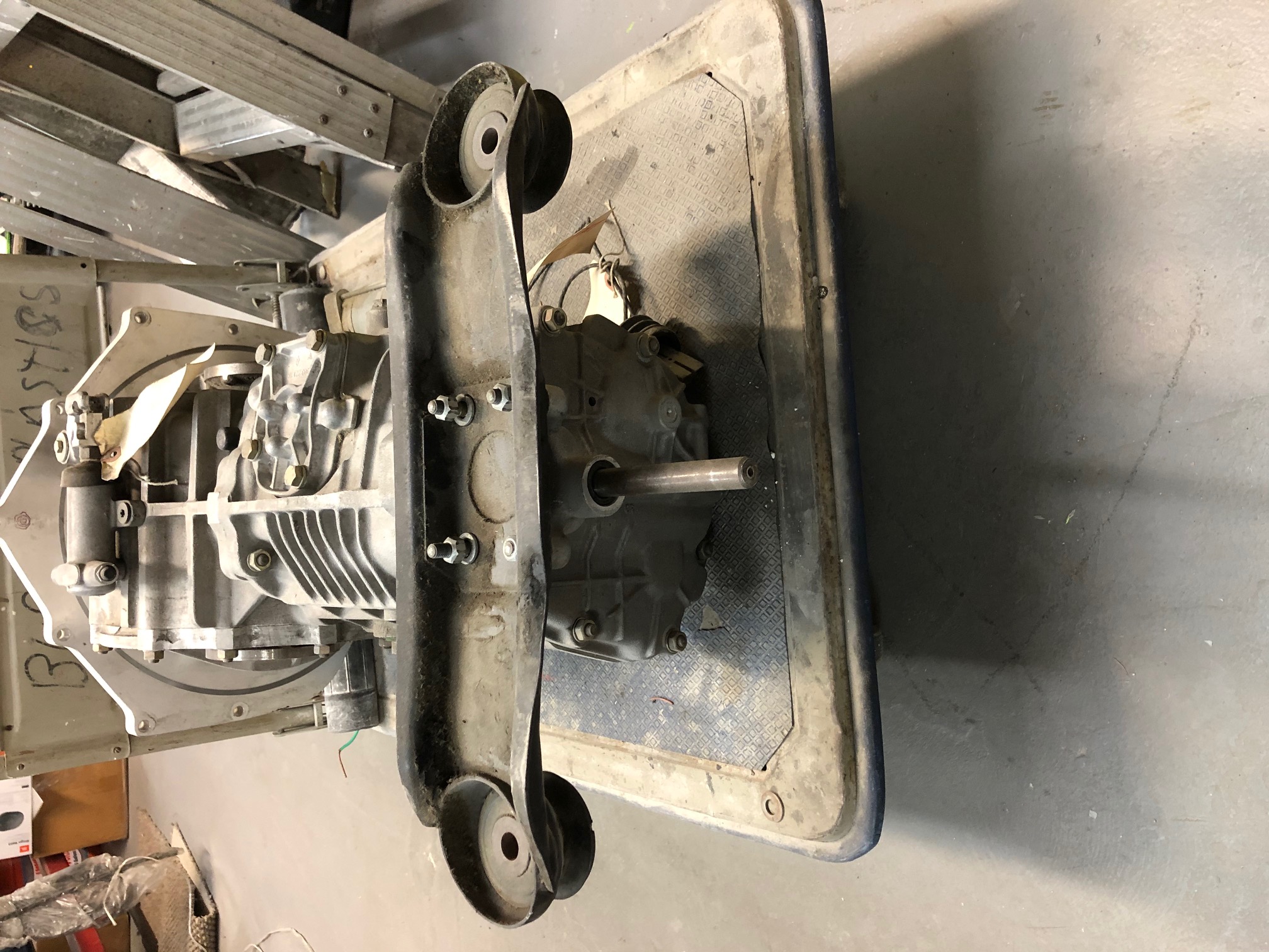

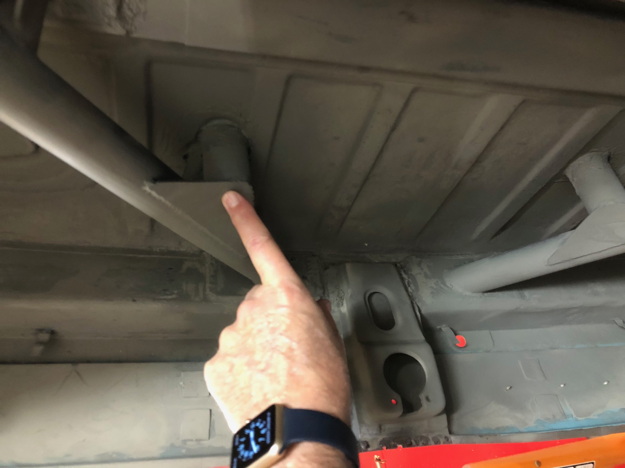

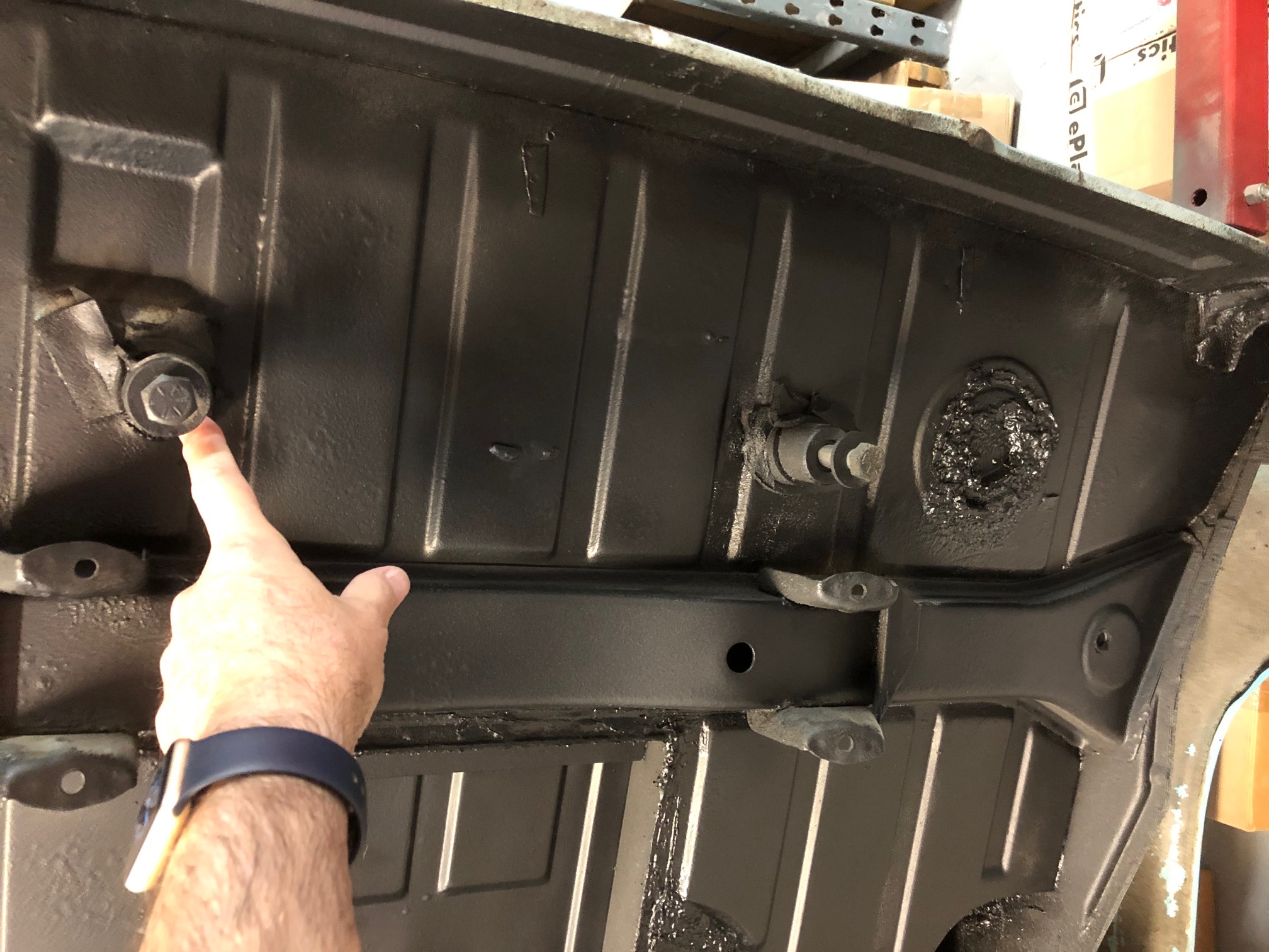

OK, these are pictures of my V8 car as far as the 930 trans, body mods to make the trans rear support fit the 914 body and the top view of rear trunk to show how I put in the moved back trans support as well as the factory 930 rear trans support mounted to the trans. Stock 930 trans mount on a flipped 930 so it hangs down and is not under the trans.
You can come down to my shop in Inglewood that you have been to see if this is an option for you on a 915 box. I am going to use Cable Shifts set up for linkage. You can use the same with a 915
Best regards,
Bob B
Click to view attachment Click to view attachmentClick to view attachment bye1.gif
