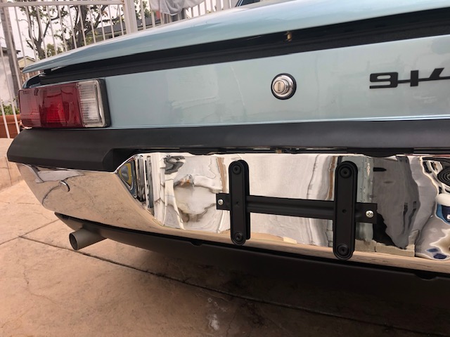

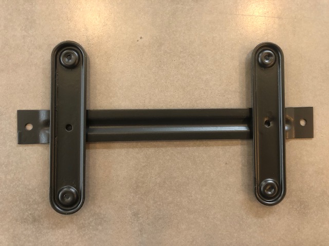

This used bracket for $20 from the Euro junkyard, they painted it, I bought # 10 screws to put it on tight, it came with the big rubber grommets. I will upload pics again when I get my custom plate on it. Attached Image Attached Image

Will be installing the front plate bracket and bumper on mine next week and don't recall any spacers on the set up. The rear bracket mounts flat and did not have spacers either when it was torn down. Can anyone chime in on that?

Yes there was a flat spacer under the bracket, but not as thick as shown. I think it was the same spacer used on the bumper top Not shown in the current PET, will check the old paper catalog. The thicker one shown is probably a better idea to keep the 4 screws from denting the bumper.

(IMG:style_emoticons/default/agree.gif) fatter than stock but probably better to prevent the tip of the screws
from damaging the chrome.
I think the rubber washers were not original on 914's but were provided on all later
later 911's and in all dealer supplied license plate kits ?

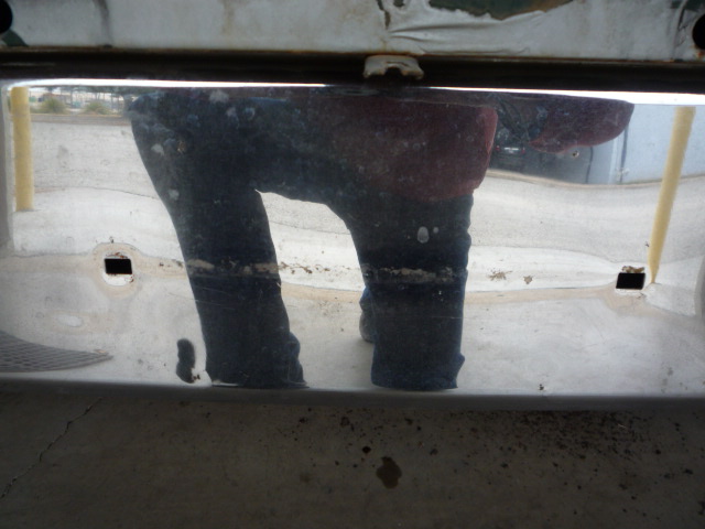

Nothing shown in catalog, does not even show the mounting hardware or USA plate brackets. Hard to see divots in the chrome bumper but if you look really close you can see the two lower ones to the left and right of dark center. Also note discoloration of chrome from bracket.
