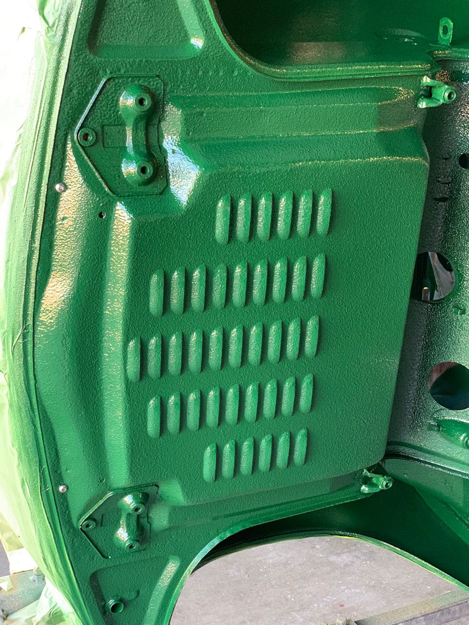

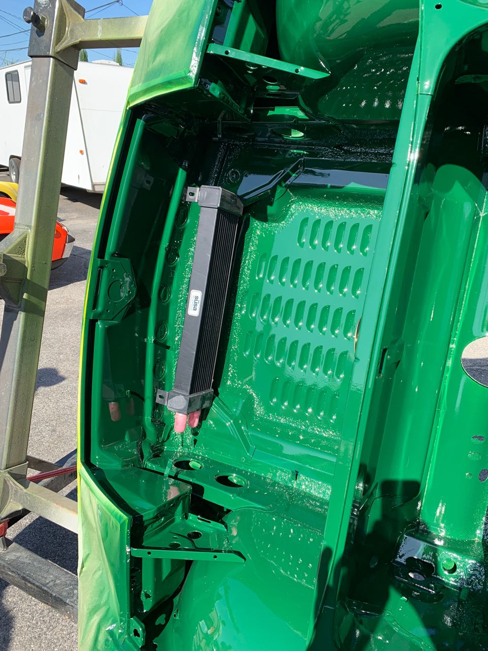

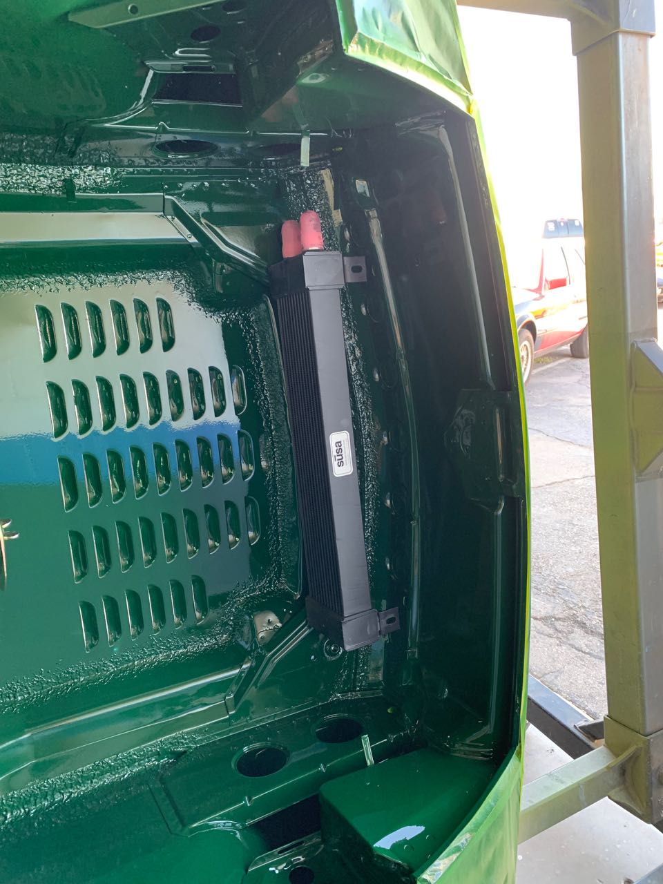

So, that is exactly what we did on my car. I have the GT style oil cooler in the front trunk and we left the 5 center most black plugs out and have the valance slightly modified to allow more air to flow to those openings. We have a shroud covering the oil cooler and sealing to the trunk floor. The floor is louvered for air to flow out. We should know pretty soon how that works for cooling. (IMG:style_emoticons/default/beerchug.gif)

Here are a couple pictures showing the front valance:
