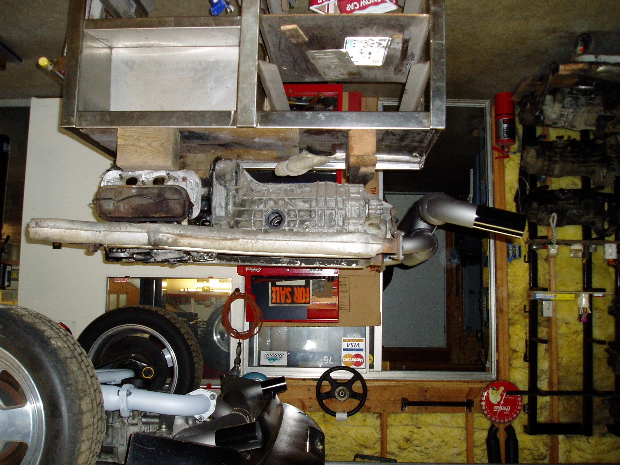

wow someone has really butched up your heat exchanger system, welding early pipes onto a late heat exchanger!

Triadwest@comcast.net makes a bolt on system for the 75/76 heat exchangers.Attached Image
