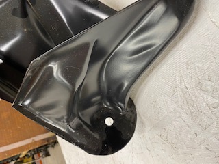

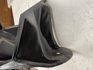

not bad, remove the swing arm, grind and sandblast and reweld. Look at the inner console and see if it is bad. The inner console we sell has some of the metal you need on it.Attached Image Attached Image
Thanks George I’ll go and see how far it runs.
