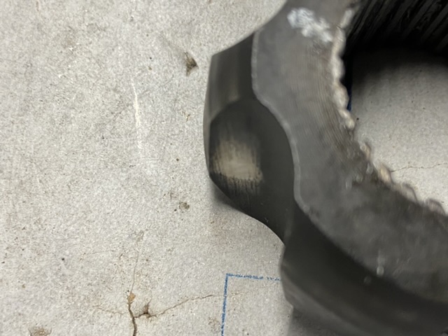

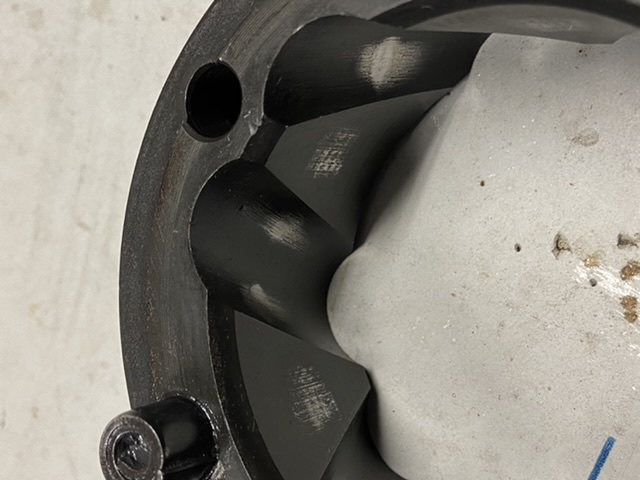

This should not have happened unless somehow the spline is galled.
Post aome pics of the cv races.
I rcommend new cv.s and axles at this point. Once done you will probably never have to mess with them again.

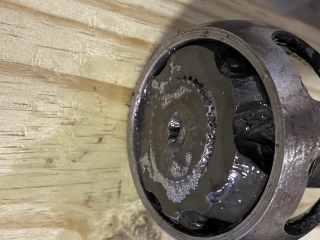

here’s some pics of the first one l got cleaned up and the stuck one
looks pretty rough but l really got these to clean up and have as spares
so no harm done really but would like to get them cleaned up

make friends with or pay someone with a shop press.
The clean one pictured looks great. Reassemble, lube and use.

Replace as George suggests. Not worth your time.

Those look like new !
