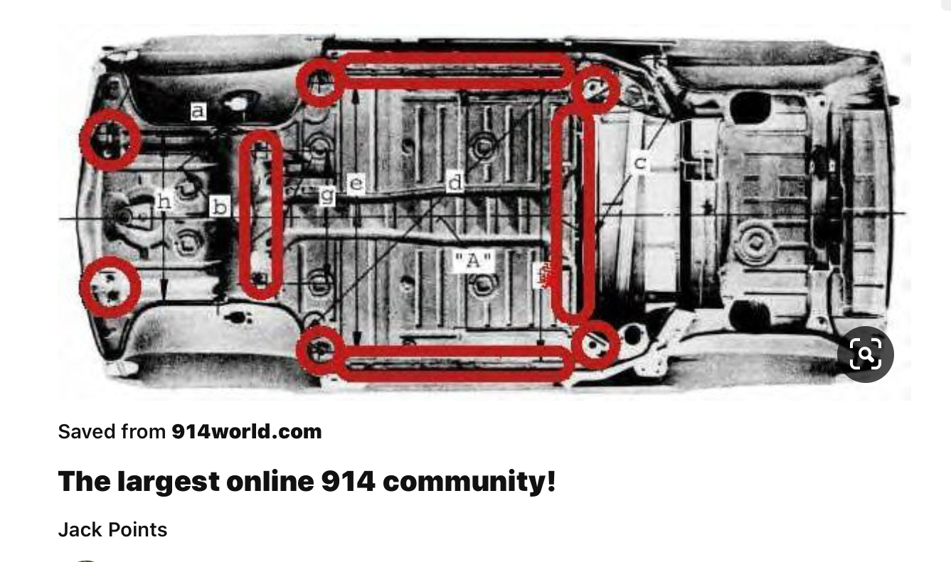

Ok not good. Thanks. I had used a reference on the world referencing round 'donuts' that were safe to jack on - evidently not! What purpose do those areas serve ?

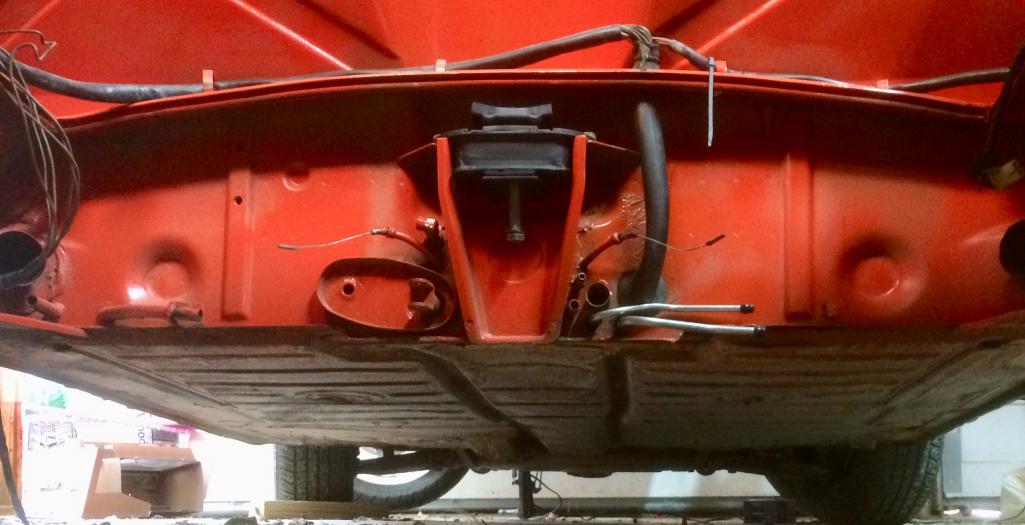

And if you check the location of the donuts in the front and look at that location from above you'll find that it is only supported by the thin sheetmetal of the floor pan.
In the rear, it's only supported by the thin sheetmetal of the triangle piece in that corner.
There is nothing structural backing up any of the donuts ...

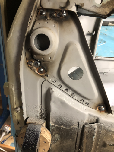

QUOTE(SirAndy @ Mar 25 2020, 06:19 PM) *
Hi SirAndy, I'm sorry to say I don't agree with you for the rear donuts... Few weeks ago took of the triangle plate + donut to check for any rust and to make it straight again. The donut itself is directly under the frame member and supports it fully, see picture.
The front I don't know yet...

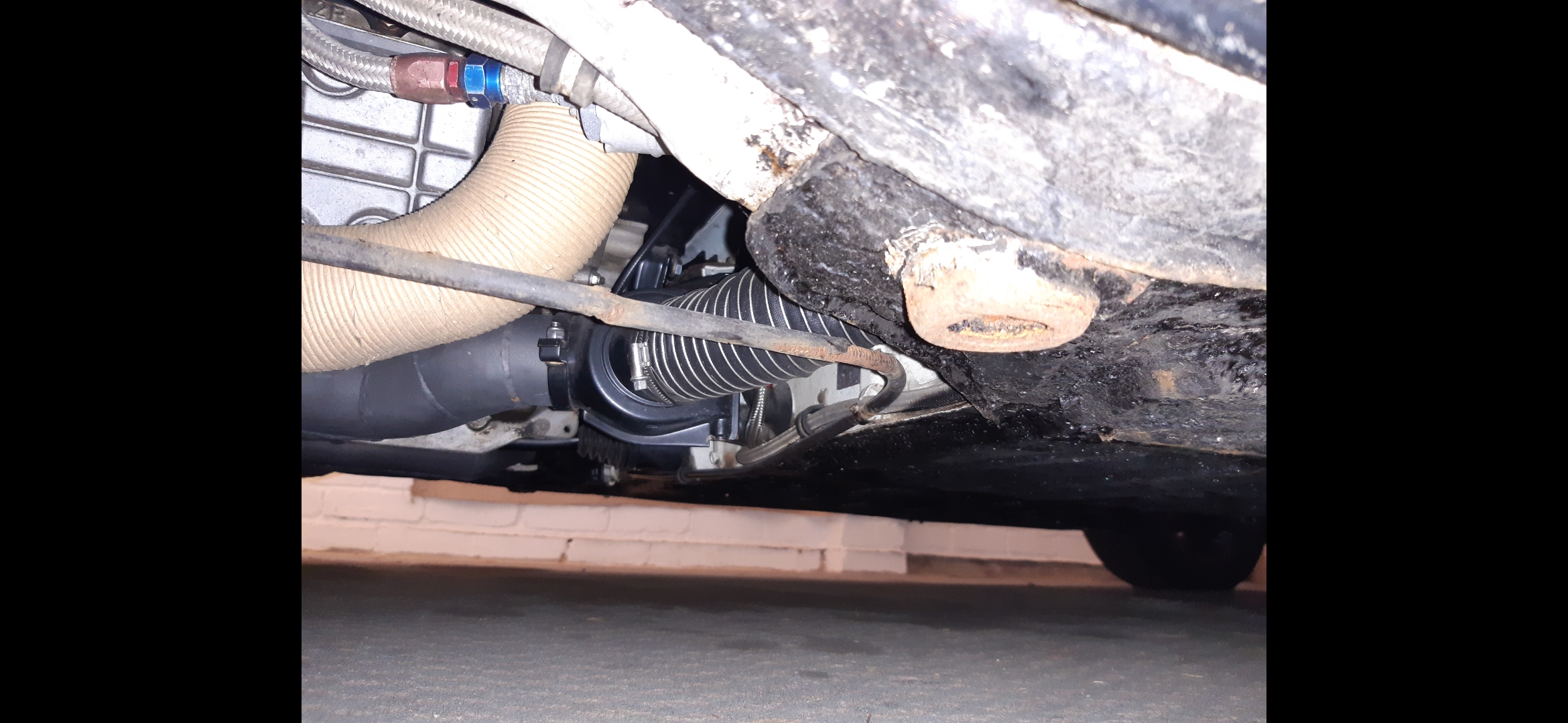

You can see the point on the floor ,in front of
the engine mount where it has been dented in
from many years of being jacked up with a
floor jack with a piece of wood on it..

QUOTE(gandalf_025 @ Mar 25 2020, 05:14 PM) *
(IMG:style_emoticons/default/agree.gif) Very common damage on 6s but hard to avoid as it is a very
solid point on the chassis and provides great height when jacked there.

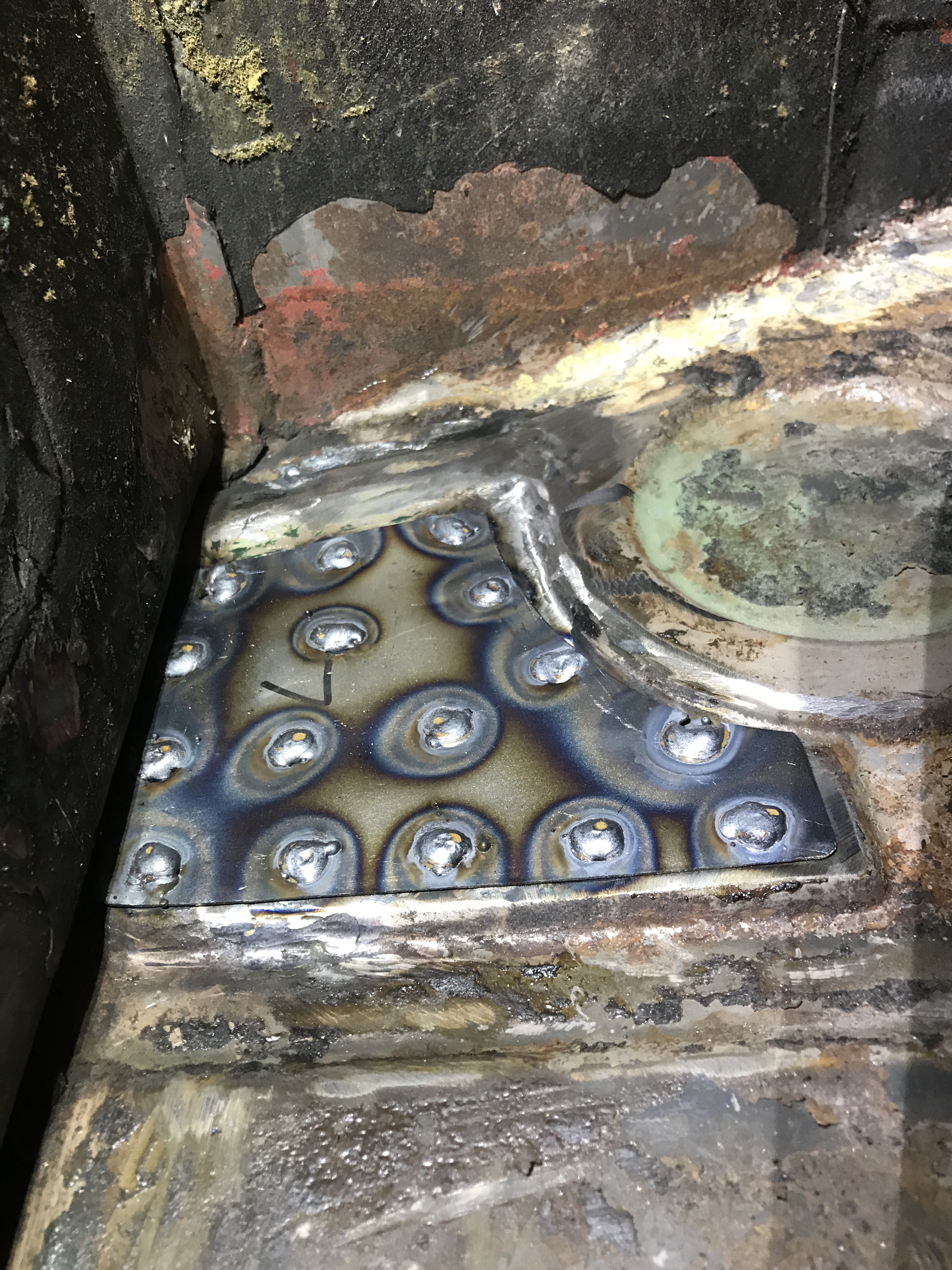

QUOTE(SirAndy @ Mar 25 2020, 10:15 AM) *
They are crooked because those aren't jacking points!
There is noting solid on the other side, using them as jacking points means you are deforming your floorpan.
There is on mine (with some custom backing plates inside the front floor).

QUOTE(bkrantz @ Mar 25 2020, 07:29 PM) *
I thought about doing that as well. What gauge of sheet metal did you use?
