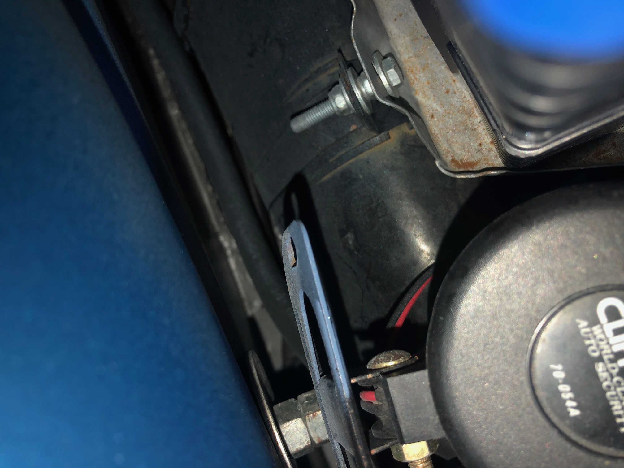

Hard to see, but the late model plastic charcoal canister, fits perfectly between the battery and the firewall. I attached the bracket where the 914-6 CD mounts to, which is not needed with a 3.2

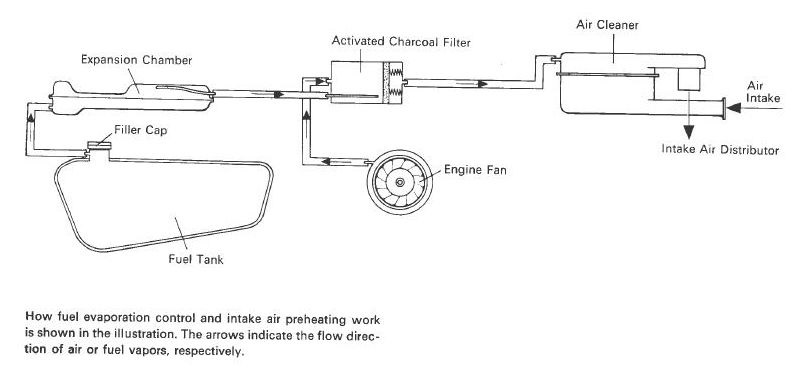

In the originality forum, you can see the stock locations in the engine compartment.
http://www.914world.com/bbs2/index.php?sho...amp;hl=canister

I have a 911 engine with carbs. The filter return line is connected to the air cleaner - per the diagram Steve added above. No gas smell in the garage.

Sounds like you might need an external expansion chamber. 911’s used an external expansion chamber, but they are kind of bulky.

(IMG:style_emoticons/default/agree.gif) You have to have an expansion chamber and a charcoal canister.
