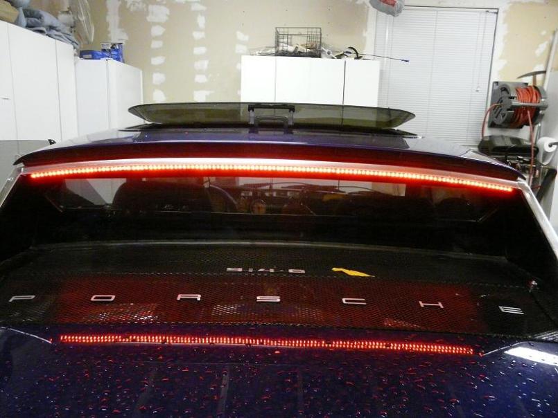

I totally agree with the importance of the 3rd brake light. If you don't have one you should be thinking about mounting one. Some guys have mounted the 3rd brake on the engine lid which is fine but I prefer to have the 3rd brake light as high as possible on the vehicle since the 914 sits so low.
I've thought about doing something for the 3rd brake on the 914 but the issue is there is no existing fixture to be reused or repurposed. As well there are many off-the-shelf options for 3rd brake and LED fixtures and strips.
Any solution will involve cutting, drilling, or taping and that's something I've stayed away from with my LED boards.
About the front-end flashers when you hit the brakes, there are many standalone brake light flashers on the market; some for as little as $5.
One thing I have thought about making is a pigtail with or without a flashing module that would help to wire a third brake light onto the roll hoop or engine lid. This is what I did with my 914.
On my 914 I stole power from the driver side rear light bucket using a Y-spade connector.
For ground I used a ring terminal and attached it to the ground stud behind the relay board.
I ran the power and ground wires up the sail panel under the trim and over to the 3rd brake light.
Spoke
post Apr 30 2020, 10:58 AM
Jerry
Posts: 7,370
Joined: 29-October 04
From: Allentown, PA
Member No.: 3,031
The unit I used was from Summit Racing in the 12in version. They also have 9 and 6.5in versions.
Brake LED Strip
Using a small angle clip I mounted the light to the chrome trim on the roll hoop.
The LED is only 0.625 inches tall and is not seen from the interior because of the roll hoop pad in the interior.
I did have to file a little bit of the chrome strip for the angles to mount.
Also had to make a wire chase by grinding a slot in the roll hoop but this will be covered by the chrome strip.
It's a pretty easy install once the LED and wiring was determined. One thing I like about the wiring is none of the 914 OEM wiring was cut or spliced. One could also add a 3rd brake flasher in the wiring.

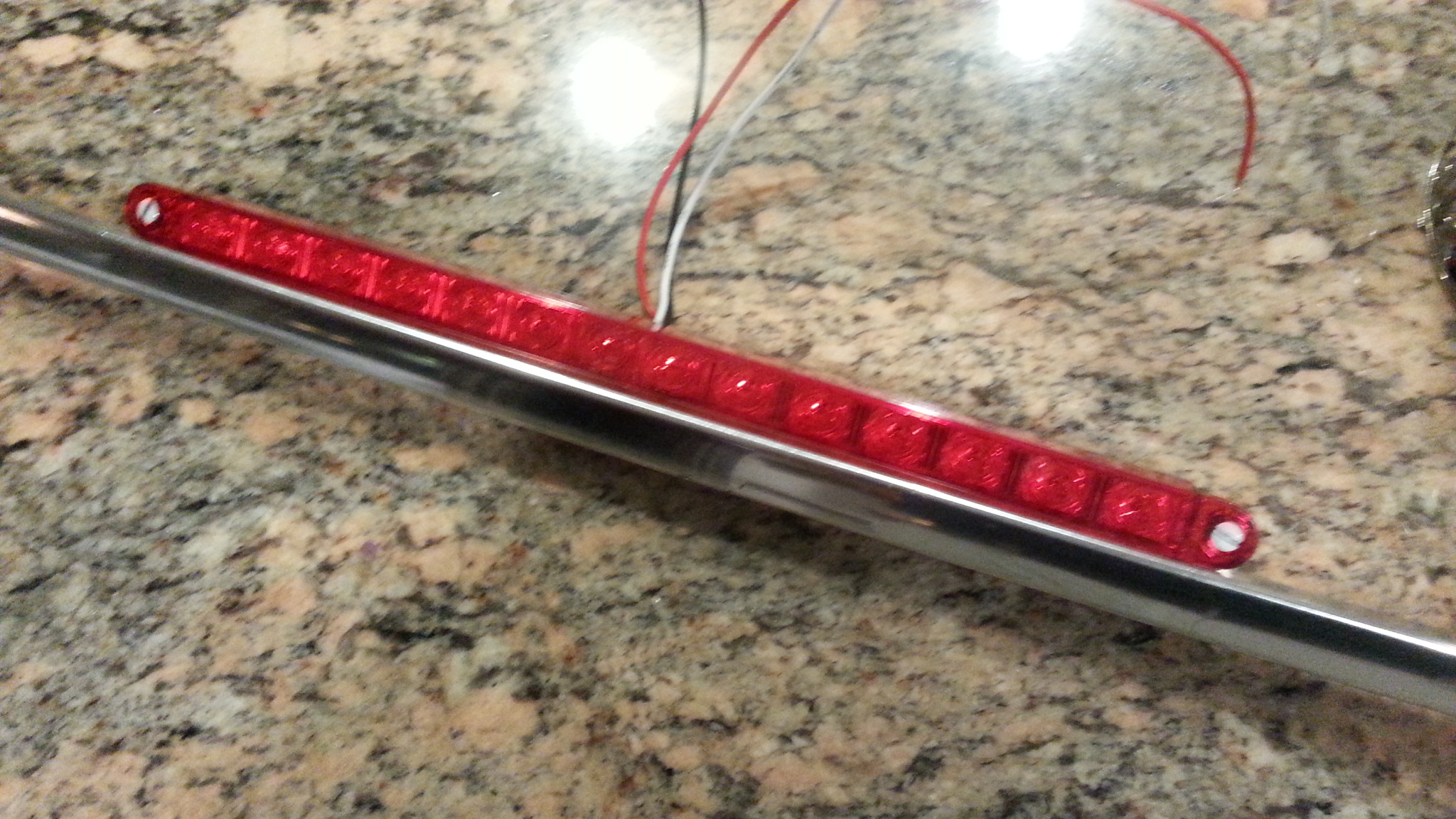

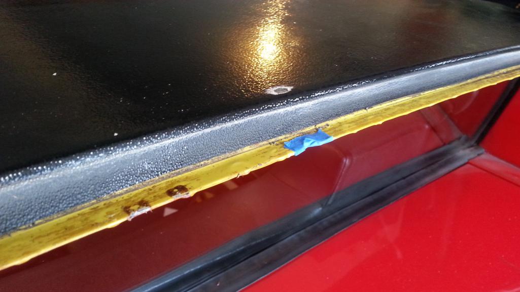

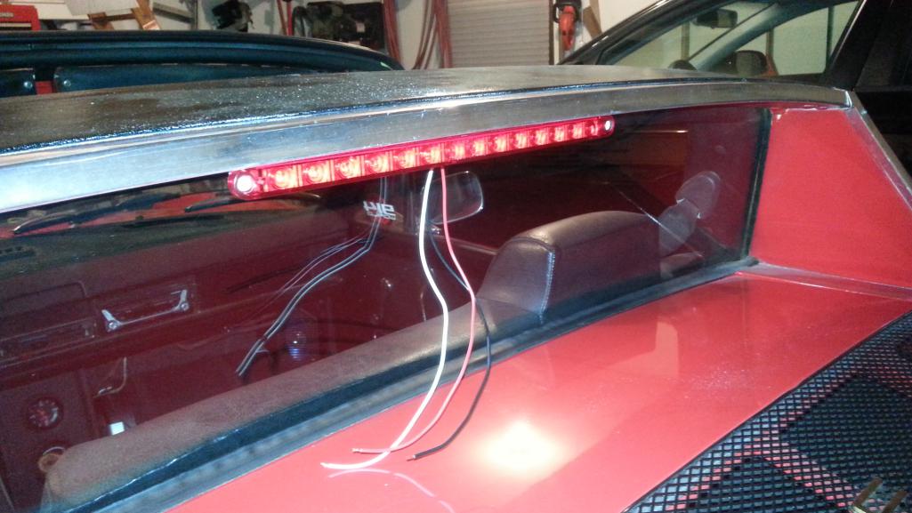

There's this one:
3rd Brake Light in Chrome Strip 1
And this one:
3rd Brake Light in Chrome Strip 2
