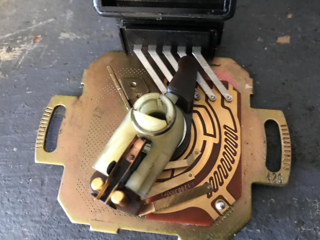

Took off the TPS, got inside. Photo attached. It does not look to me to be the issue. Of course it still might - but contacts look pretty decent. Only 40k miles from new.
I rechecked all vacuum lines. All good.
Car runs like a dream. So smooth and balanced. The only tiny issue is on that featherlight throttle - revs dip.
If I put normal throttle pressure, it’s fine. No hesitation or anything.
I think I’ll let it pass, and go enjoy the car. Unless anyone has another thought or advice. Welcome any at all.
Thanks. Gary

The trace for the "accelerator pump" isn't your problem. It has the same function as an accelerator pump on a carburetor only instead of moving a diaphragm to squeeze extra fuel into the air stream, it cycles the injectors open and closed. It only works to add extra fuel as the throttle is being opened, not to enrich it at a fixed throttle position.
If I recall correctly from my '74 2.0, the other traces on the board are used to sense throttle position and inform the fuel injection ECU so it can supply the right amount of fuel based on throttle position and load (measured by the manifold pressure sensor). Someone else suggested checking the adjustment of the throttle position sensor. I think that is where I would start. My guess is that it isn't changing resistance when you move the throttle very slightly off of idle. The result is extra air entering w/o the computer knowing to add extra fuel.

It had never been off the car before. After cleaning, I then put it back precisely in the same position. No joy. Same issue.
I then took your excellent advice, and moved it clockwise very slightly, and now I don’t get an hesitation whatsoever.
Big thank you all for your expert advice. Such a great and friendly forum.
So much appreciated. Gary

Update. I now get the slight hesitation at 1500 rpm. Seems I need one of those new boards. Must have an issue in the track that’s moved.
