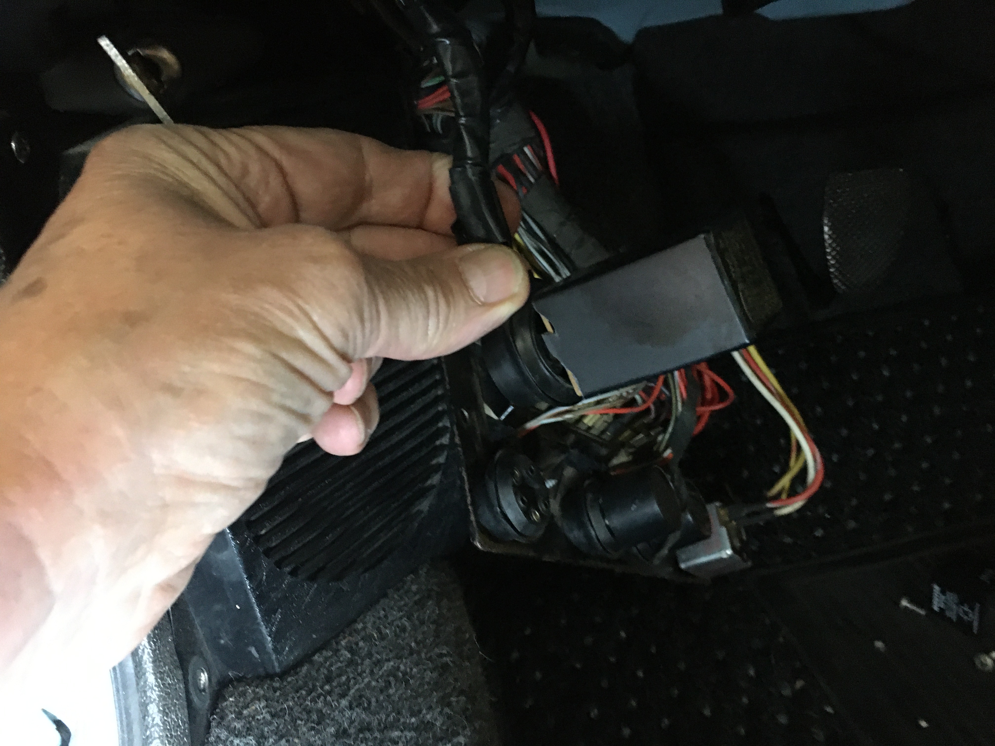

> Can you help make this easier, Wiring up flasher from Spokeworksled

What wire goes to what terminal?

Never mind found another connector stuffed in the dash

The first one is the high beam relay. If you manage to hook the flasher relay to that circuit, your headlights are gonna go all Disco on you!
Just an FYI for everyone here. The flasher relay was never mounted on the fuse panel. There is a hole in the dash frame below the switches. That holds the headlight flasher. The factory flasher relays were too tall to put on the fuse panel mount plate.
