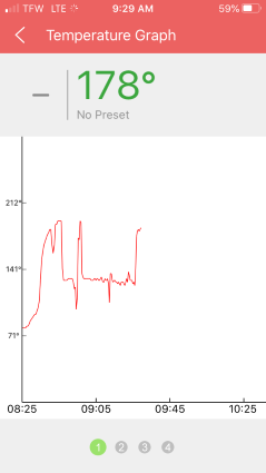

Ok, this morning wasn't unbearable heat, so here's my novella...
Test process:

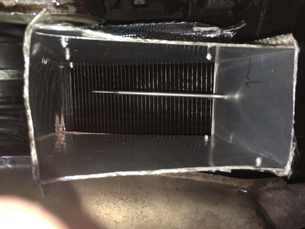

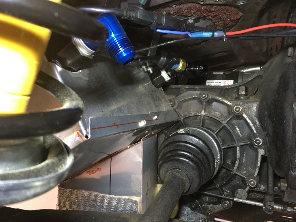

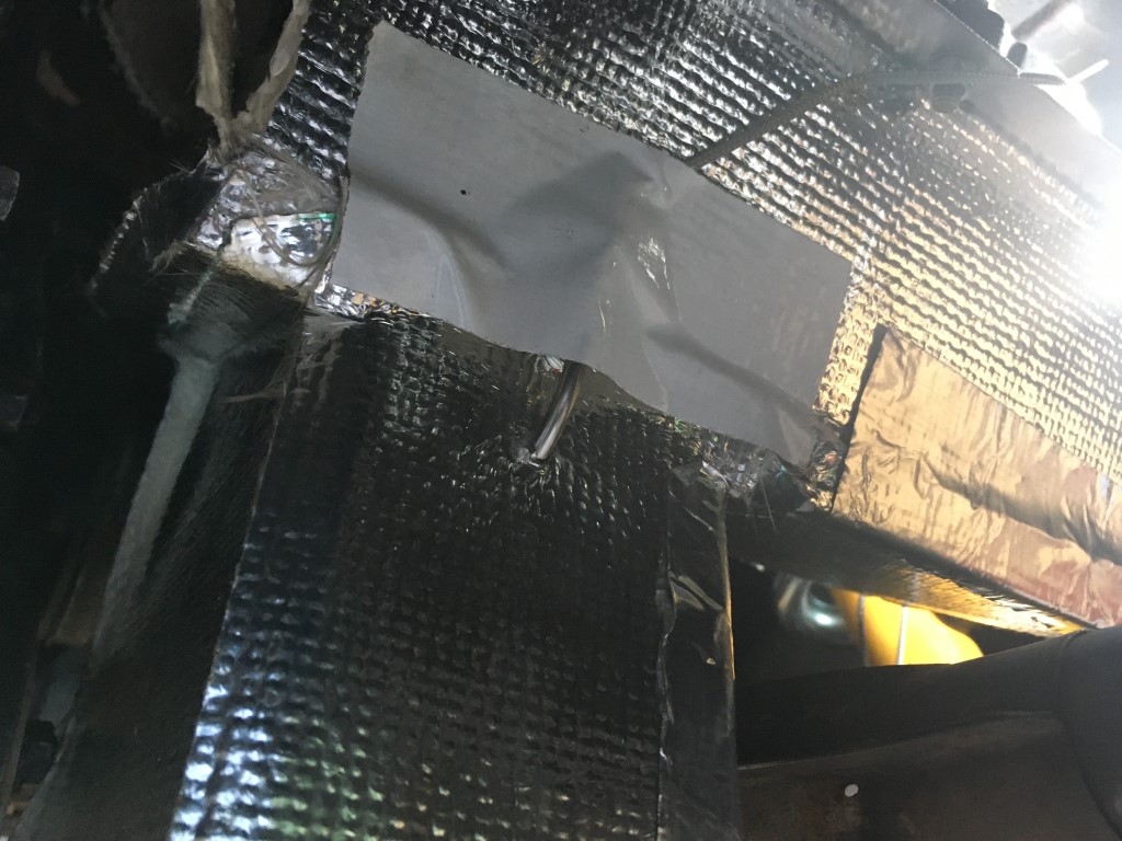

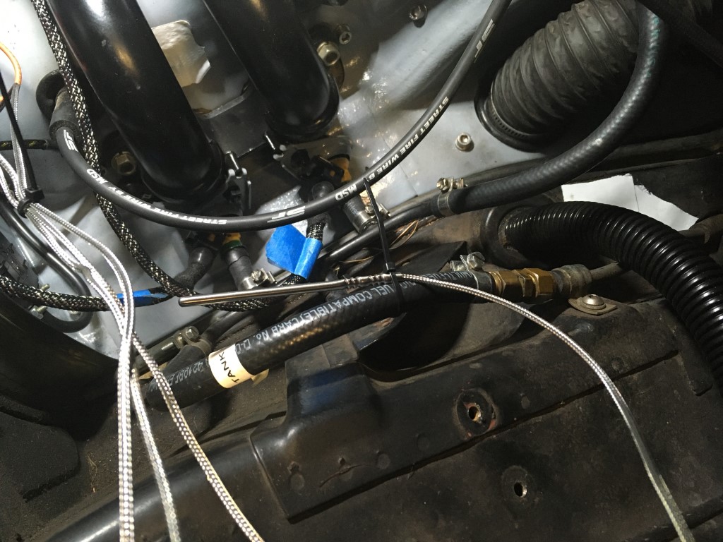

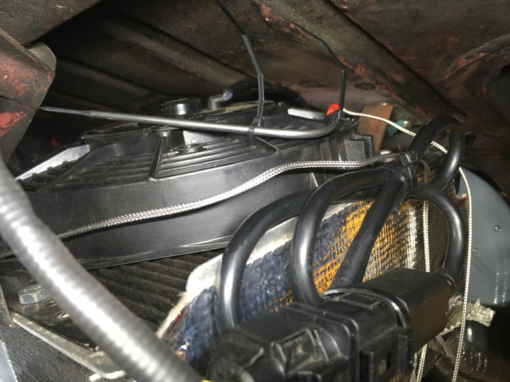

- Equipment as in the above post. Probes were placed in four locations:
#1 (green dot in screen shots), intake of my oil cooler duct I built, with the intent of pulling cool air across the cooler.
#2 (blue dot in screen shots), top of cooler fan, air exiting the cooler
#3 (red dot in screen shots), probe stuck backwards from the engine compartment through a wiring grommet in the vertical sheet metal. So it's measuring the air temperature pretty much at the transaxle/engine interface.
#4 (orange dot in screen shots), probe tye-wrapped to the right side fuel line in the engine compartment.
The car: 1974 2L, dead stock long block (AFAIK) but powered by Microsquirt. The oil cooler has been replaced by a Tangering Racing kit which includes a thermostatic block that bolts up where the stock oil cooler was.
The cooler includes a Microsquirt-controlled fan, which comes on at ~220 and shuts off at ~200. Oil tmeperature is measured at the cooler exit line.
Ambient conditions: sunny, 79F. Started roughly 830AM so low sun.
GregAmy

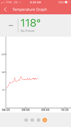

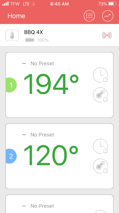

Test loop: my home is 5 minutes from I-91 in Middletown CT so I left the house and headed for the highway. Initial direction was southbound, which has a gradual decline to New Haven and Long Island Sound. Very light traffic.
As I started out I noticed something that surprised me: the bottom side of my cooling duct was baking. This duct extends downward between the transaxle and the right exhaust and ends roughly below the bottom of the heat exchanger. And it's close.
Recall that the oil cooler has a physical thermostat, which opens at around 180F. The fan does not come on until 220F. So until the thermostats kick in, these first two probes are roughly measuring actual air temperatures in between the heat exchanger and transaxle, and at the top of oil cooler near the trunk.
And it was baking.

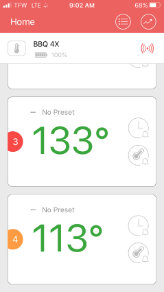

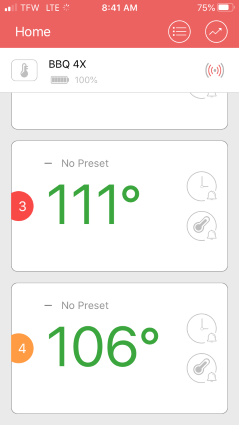

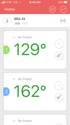

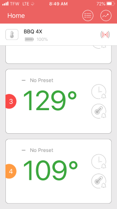

It took a bit for the oil temp to come up to speed, but before the fan kicked on I was seeing nearly 200F at the bottom of that duct with 120F at the trunk:
The front under-trunk area and engine compartment wasn't too bad at that point:
Once the thermostat fully opened and the fan finally kicked on the temperatures inverted. What was surprising was how much higher the forward engine probe got:
Attached ImageAttached Image

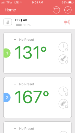

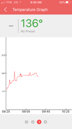

Long story short, once I had been in highway cruise for about a half hour, everything pretty much stabilized. Oil temps were around 214F with the fan constantly on.

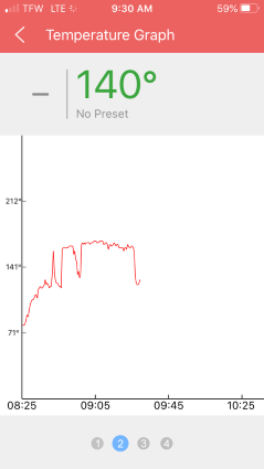

Here's the graphs for all four. You can distinctly see where the duct was baking until the fan kicked on, and how things stabilized. You can also pick out where I exited the highway and sat a bit at the light before reversing course.
Attached ImageAttached ImageAttached Image[attachmentid=754
686]

Conclusions? Eh, I'm not gonna make any declarations based on such a small data set. I was surprised kow baked that area between the heat exchanger and transaxle is; I expected some level of radiant shielding from the heat exhanger shroud itself, especially since there's air constantly flowing through there.
There seems to be a lot of stagnant air under there, too. If there was strong airflow then the exhaust heat would be carried away better and the forward temp probe would have pretty much stayed as solid.
In the interest of science, I flipped on my interior heat with the fan, to see if any additional airflow would cool the general airflow under there, and dump the hot air into the cabin instead of out the heater valve. Zilch, zippo. Ddid not affect the temps by even one degree.
I was also surprised at the minimal difference in air temps between the cooler inlet and outlet; I expected not only a higher delta but a higher overall exit temperature. 30F delta is not a lot, making me wonder how I can make it more efficient. Plus, it highlights the significant importance of the inlet temperature flow; if I could get the inlet closer to ambient instead of 130F then I'm confident it would affect the oil cooler temperature a whole lot more. This whole exercise shows how effective the front coolers are, and is making me rethink my support of rear-mounted coolers...but front coolers are such a major PITA on a street car...
Oh well! Digest the info, lemme me know what you think. And if you have some other places you'd like to see my try, I'm open to ideas.
BTW, I may try this again later today when it's hot as blazes, just to see how 15F ambient affects it. Depends on whether I hit the beer early or not...

That's interesting data. Nice Work! One test I'd like to see you try is removing your cooler duct and then replicating the same test run. I wonder if you remove the duct, place the 1st probe as close to the same proximity as it is in the duct, and keep every other variable the same.
....I think that not only would the data from probe 1 be interesting to see, but also how that might or might not affect the #2 probe? Just curious.
GregAmy
post Jul 27 2020, 05:03 PM
Posts: 2,711
Joined: 22-February 13
From: Middletown CT
Member No.: 15,565
QUOTE(Craigers17 @ Jul 27 2020, 06:54 PM) *
...try is removing your cooler duct and then replicating the same test run. I wonder if you remove the duct, place the 1st probe as close to the same proximity as it is in the duct, and keep every other variable the same...
"Brilliant minds", and all that. I was thinking the same thing as I was driving homeward yesterday. It would be easy to do, given the bottom part screws right off.
Idea was that pulling air from right next to the heat exchanger didn't do what I expected (pull cool air passing underneath) and maybe have made it worse (pulling ho air from off the heat exchanger).
Maybe later in the week. "Watch this space."

QUOTE(GregAmy @ Jul 20 2020, 01:53 PM) *
This just arrived...$52 delivered. Four probes, Bluetooth to the phone, and logging.
Once the weather stops being hot as Hades I'll run a nice 4-point log of some interesting places in the car.
I'm thinking one in the engine compartment near the D-Jet plenum, one under the trunk near the transaxle, one inside the intake of my air duct to the rear-mounted oil cooler, and one above the exit of the oil cooler.
Then I'll go cook me some steakage...
(IMG:http://www.914world.com/bbs2/uploads_offsite/images-na.ssl-images-amazon.com-15565-1595267625.1.jpg)
cool research thanks for posting, i amgoing to get one of these and do the same, but no shroud on my oil cooler , fan seems like it doesnt come on until about 220, i have a variable rheostat but thats the soonest so i might change this , but i am interested in seeing exact temps for the various locations of themotor even the heads and the oil .
could you put one each in alongside each head at the spark plugs , compare 1,2,3,4? i know we say #3 alwys hotter and thatswhere my single CHT gauge lead goes, .
