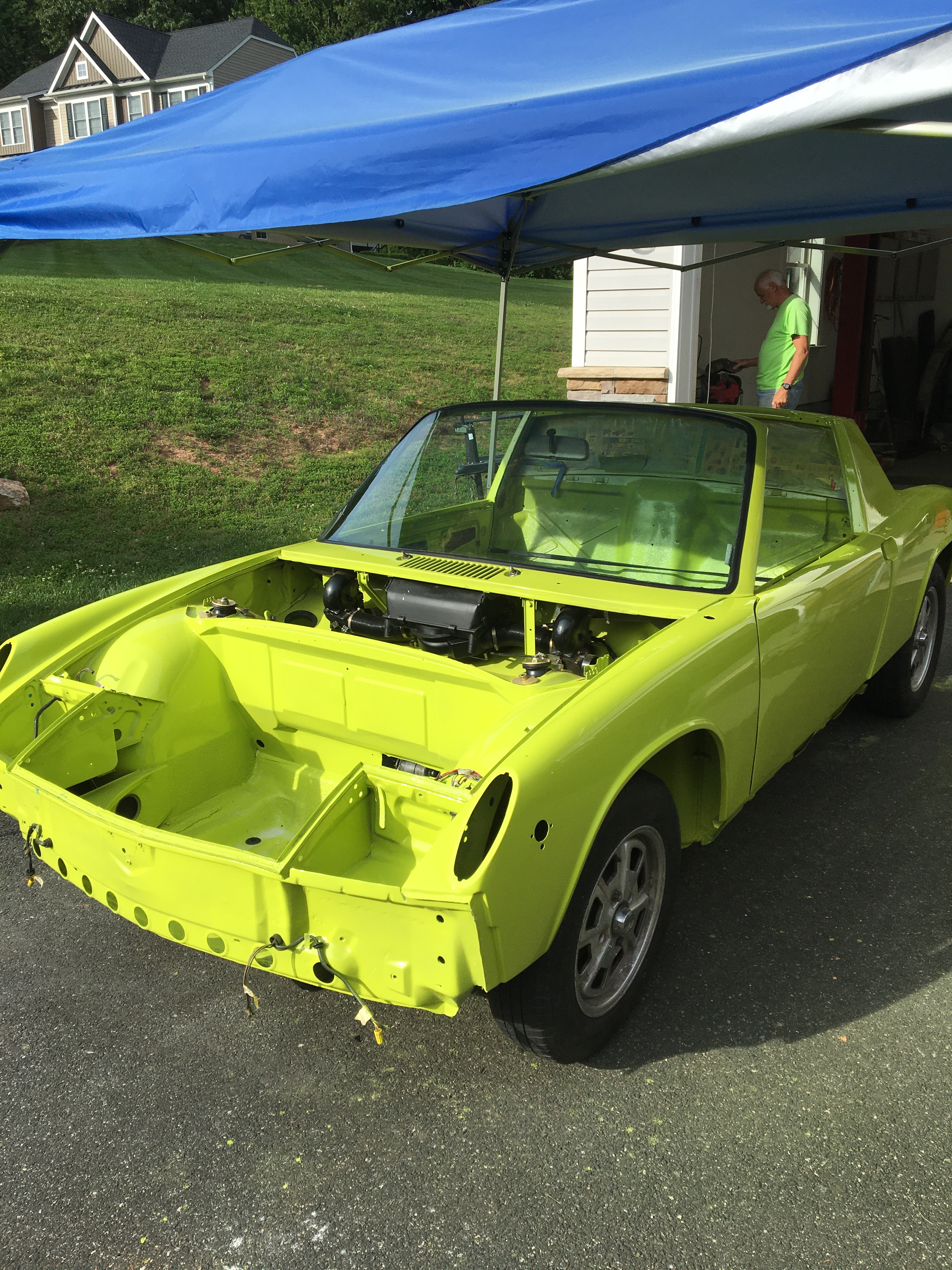

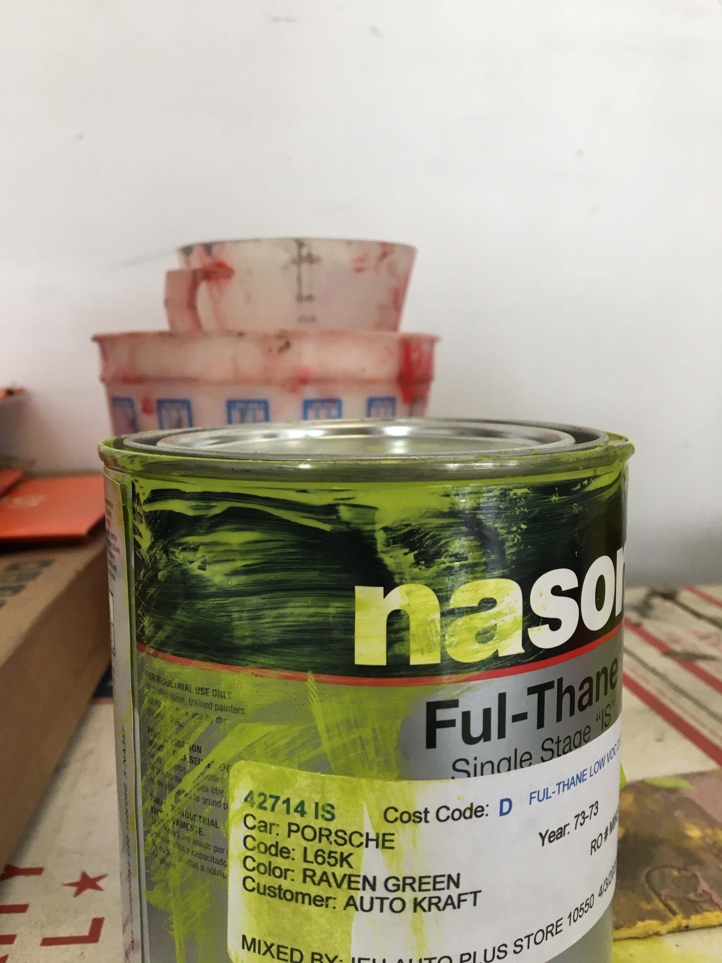

This is what I used.Attached Image

Turned out perfect . This is single stage ,no clear coat.Attached Image

Now that’s a beautiful car. Bump
rgalla9146
post Aug 1 2020, 07:15 AM
Posts: 5,026
Joined: 23-November 05
From: Paramus NJ
Member No.: 5,176
Matcing shirt too !
Beautiful.

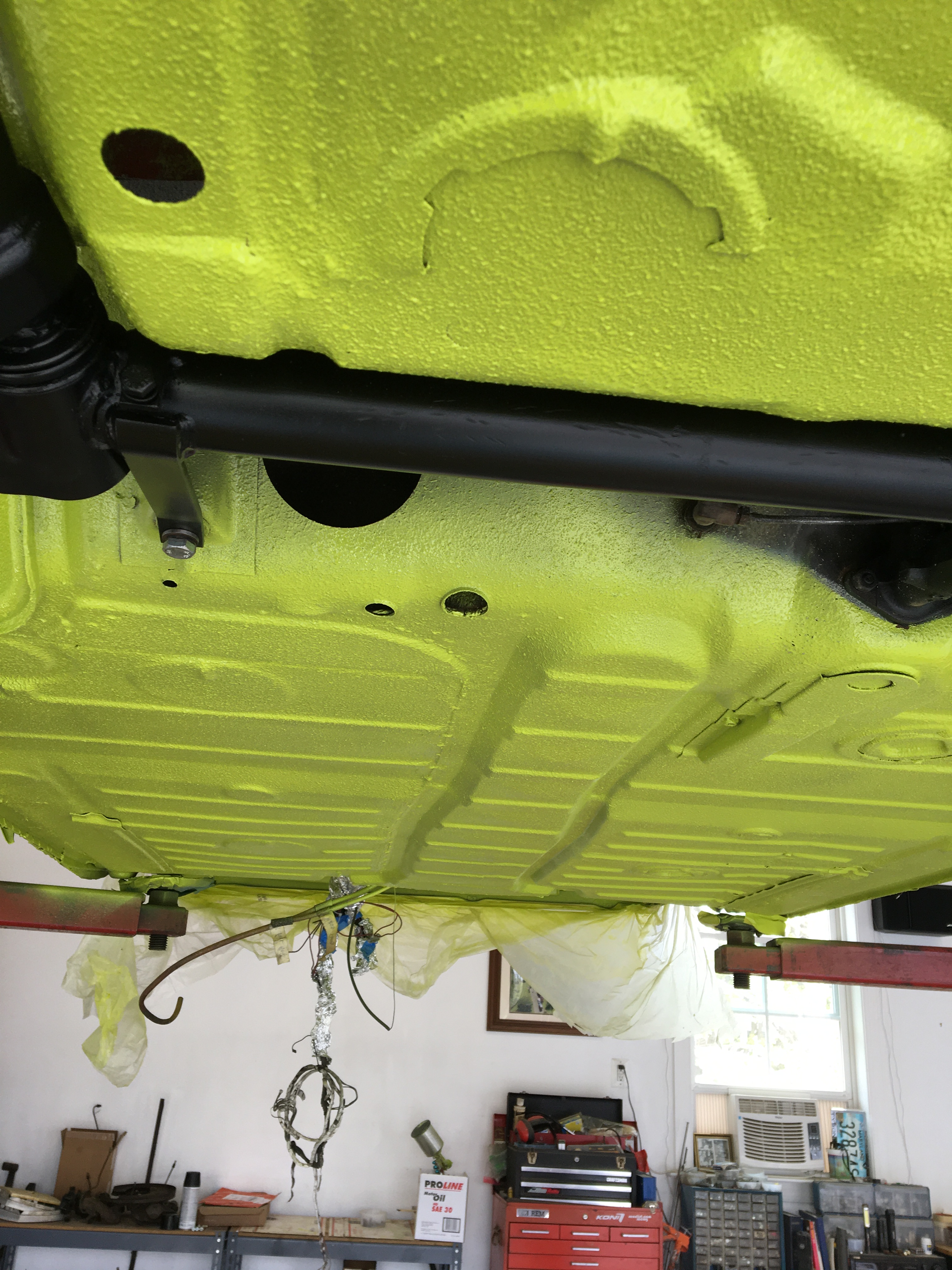

post Aug 1 2020, 08:37 PM
Posts: 7
Joined: 29-March 20
From: Maryland
Member No.: 24,076
Bottom is as nice as the top . This was the first time using Nason (you may remeber them as Dupont) paint .Always used PPG in the past but the local supplier went out of business. I must say it was wonderful to use if you go by the spec sheet directions. Car was down to bare metal used epoxy sealer first then medium build primer before putting down 3 coats of color.
