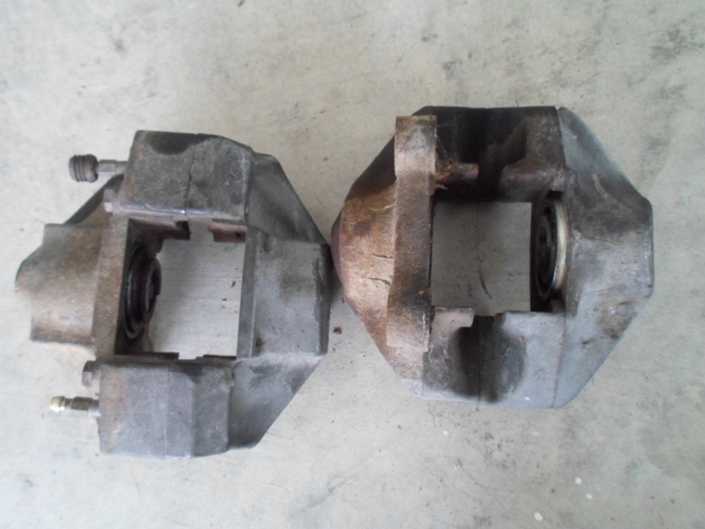

Just to add a quick update to this thread. I purchased a scissor style spreader, and it worked well. Unfortunately, the brakes are not functioning well, ...one of the pistons is completely seized and another is close.
....So....I took them off and am sending them to PMB today for a rebuild. Attached Image Attached Image

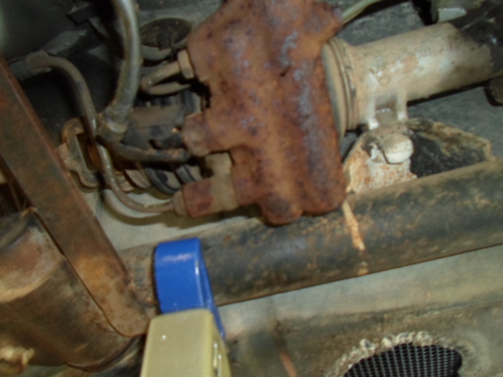

I'm also going to replace all the lines and master cylinder. I took off the steering rack cover and found that the 45 year old master cylinder probably isn't helping things.
....which begs the question ....why not replace the pedal cluster while your taking out the master cylinder...... frigg'n slippery slope....
