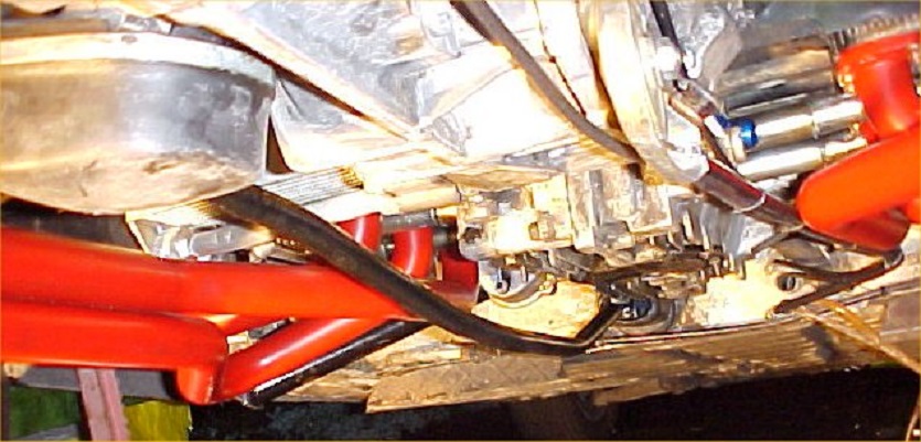

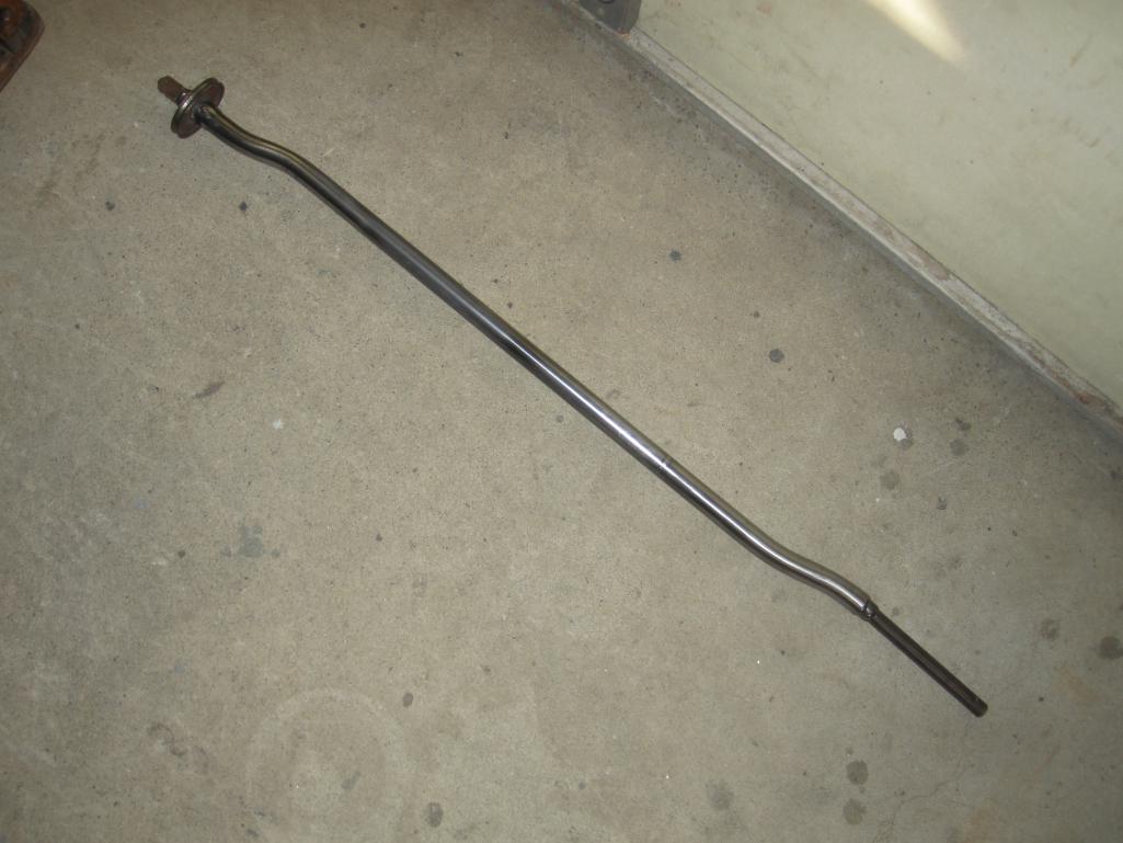

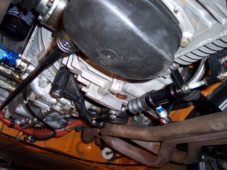

sixnotfour
post Aug 8 2020, 05:43 PM
Posts: 11,199
Joined: 12-September 04
Member No.: 2,744
stock one cut and straight piece added
stock one cut and turned rewelded
http://www.914world.com/bbs2/index.php?showtopic=46166
roblav1
post Aug 8 2020, 10:02 PM
Posts: 528
Joined: 18-September 12
From: KY
Member No.: 14,943
I did what 6not4 illustrates in the 1st pic. Straight shot. Also welded in an Apex helo universal joint.
