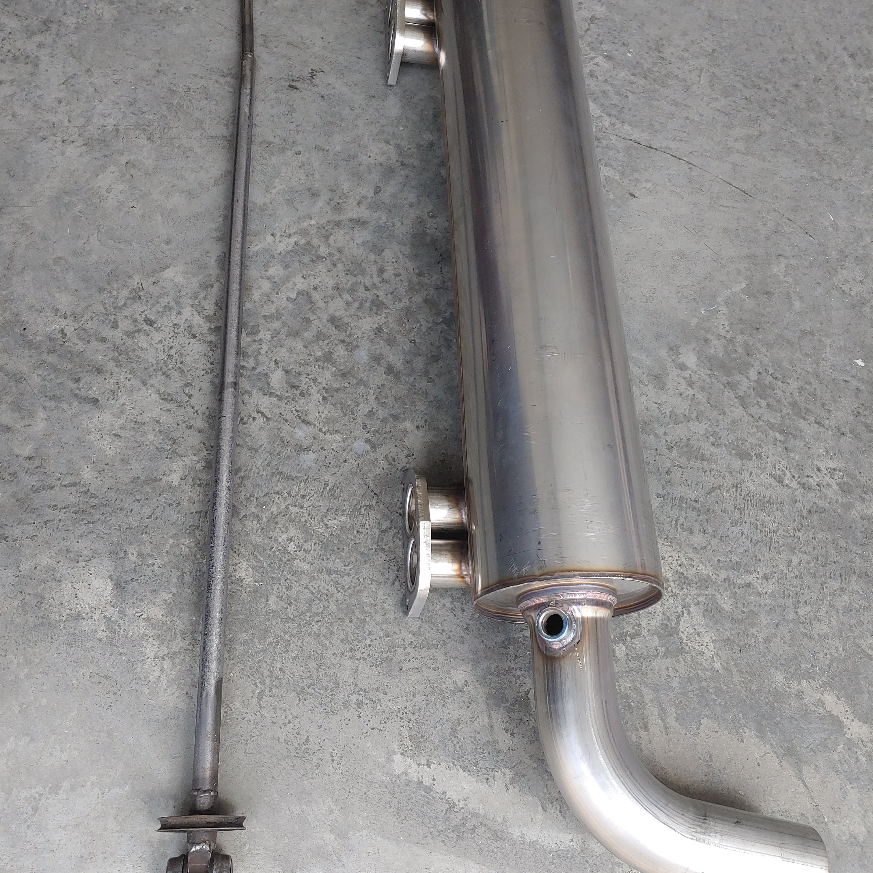

rgalla9146
Aug 8 2020, 02:03 PM
as suggested above
This was assembled from a 4cyl rear shift part with side shift ends welded on.
requires attention to clearance issues .....exhaust etc.etc.
