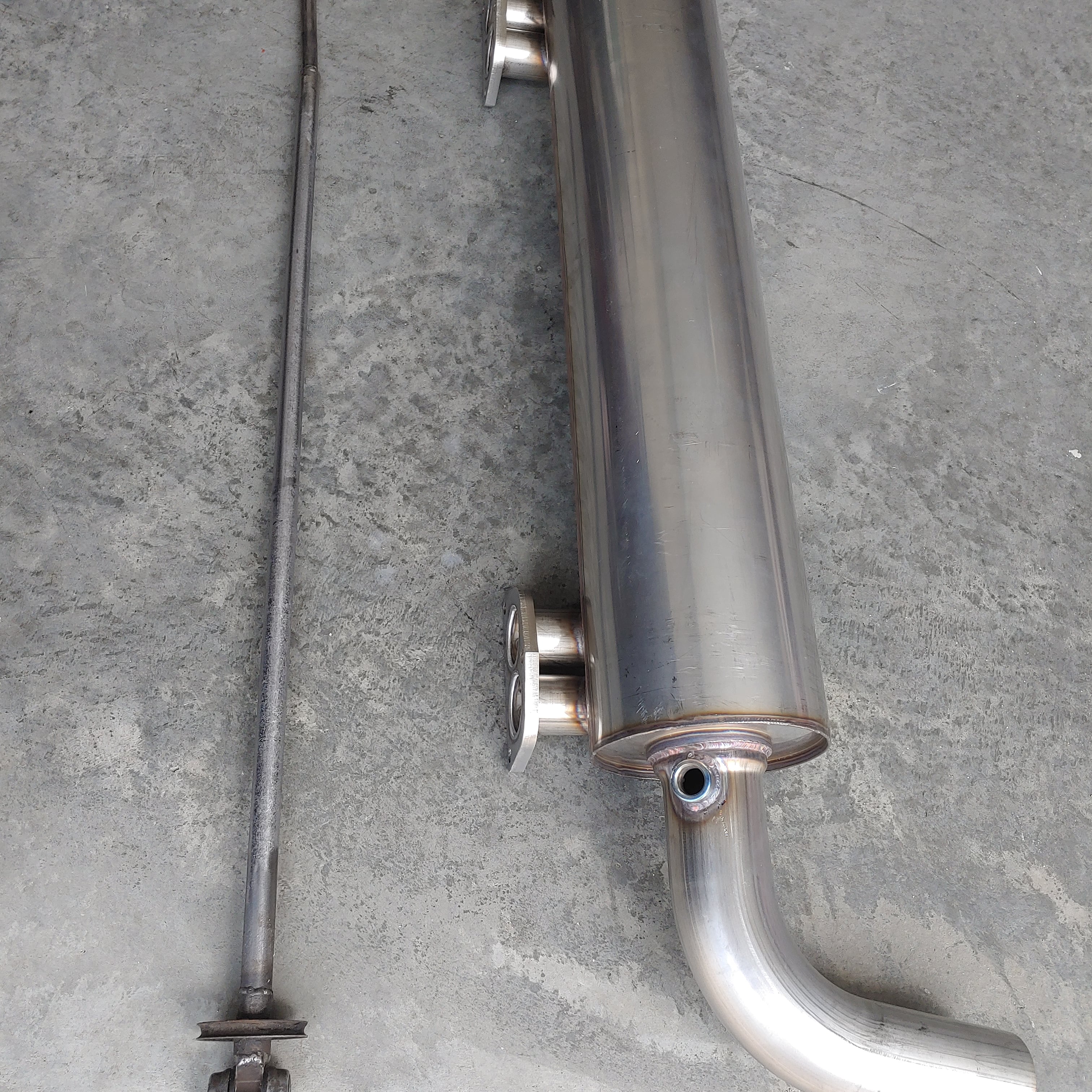

rgalla9146
post Aug 8 2020, 02:03 PM
Posts: 4,954
Joined: 23-November 05
From: Paramus NJ
Member No.: 5,176
as suggested above
This was assembled from a 4cyl rear shift part with side shift ends welded on.
requires attention to clearance issues .....exhaust etc.etc.

I still do not understand why the rear shift rod needs to be straightened? Why the stock shift rod cannot be used without mods?
Philippe
post Aug 8 2020, 03:25 PM
Posts: 14
Joined: 8-December 11
From: Belgium
Member No.: 13,877
I guess that the answer is because of the headers (I am using 914-6 GT type of headers).

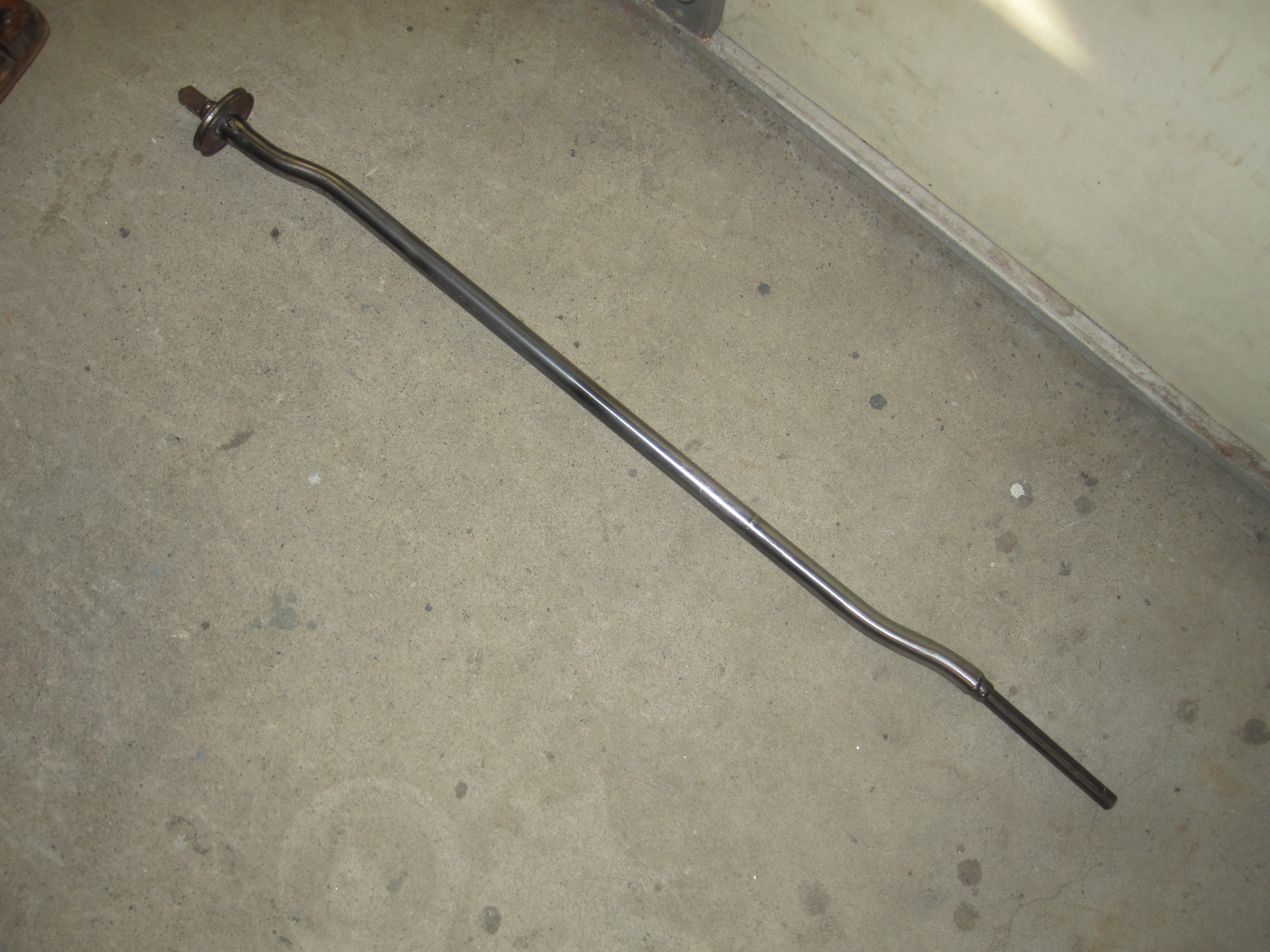

sixnotfour
post Aug 8 2020, 05:43 PM
Posts: 11,199
Joined: 12-September 04
Member No.: 2,744
stock one cut and straight piece added
stock one cut and turned rewelded
http://www.914world.com/bbs2/index.php?showtopic=46166
roblav1
post Aug 8 2020, 10:02 PM
Posts: 528
Joined: 18-September 12
From: KY
Member No.: 14,943
I did what 6not4 illustrates in the 1st pic. Straight shot. Also welded in an Apex helo universal joint.
