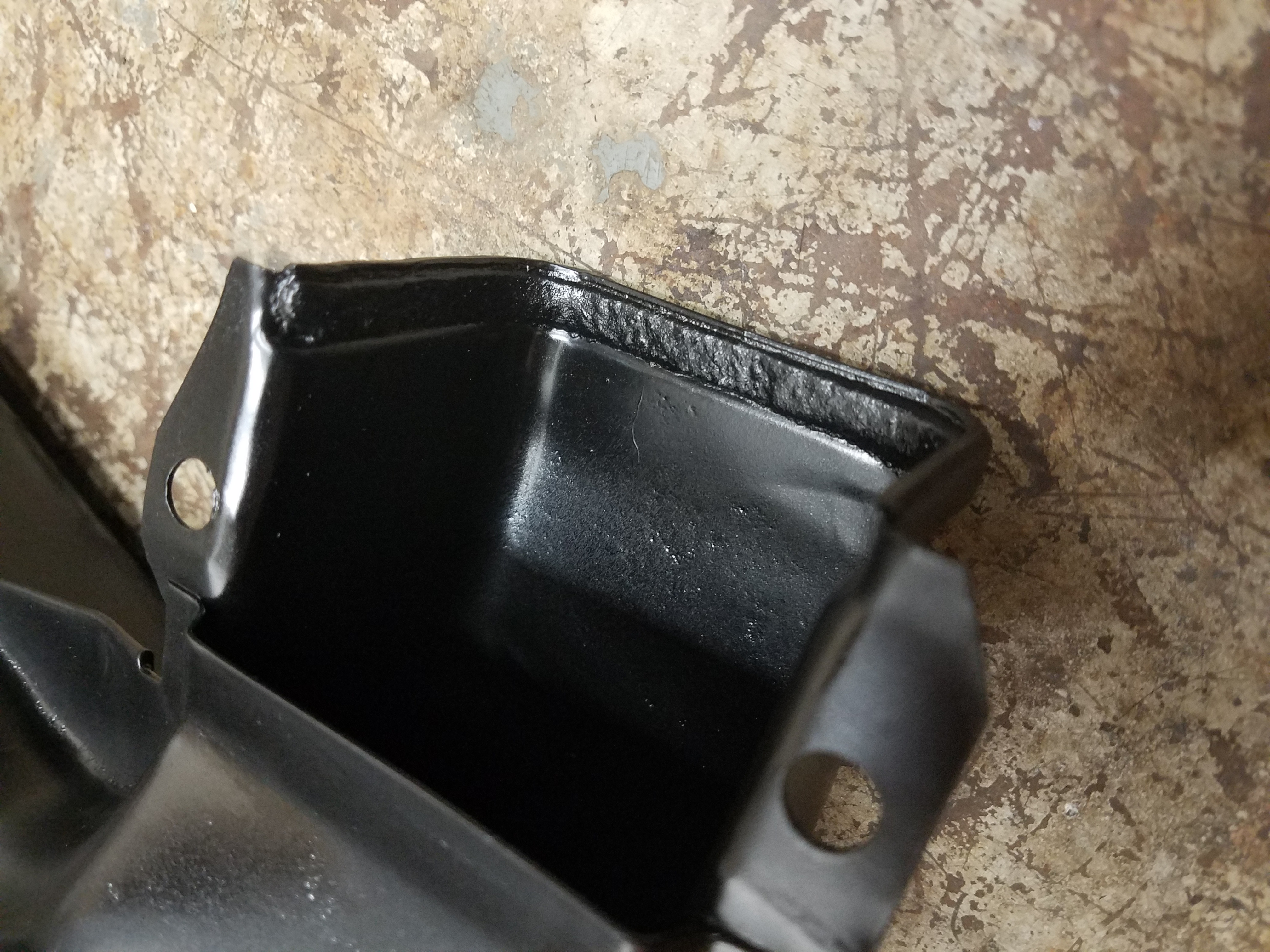

Besides the seal under the "cap" I've seen some that have what I think is a cork-like strip in the channel below. -it seemed original and I think it was glued in.

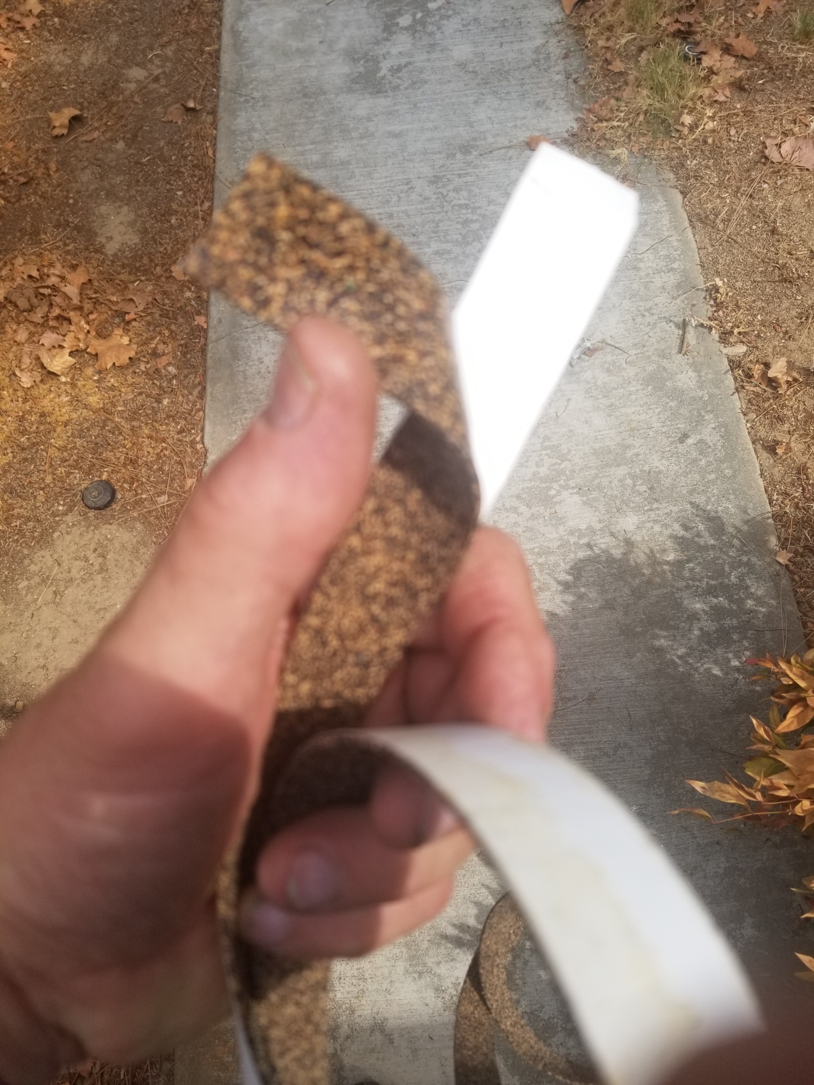

I have never seen a gasket in that location and there is not much gap for one.
I got the 1" x 1/16 rubber cork gasket material. It was $10 for a 100 ft roll. I am going to try a piece there.

IIRC, the gasket was silvery and didn't look like cork, like the rectangular gasket. It seemed like a metal or metal-mix, like lead and/or asbestos, and maybe 1mm thick. Or, maybe it was cork that picked up so much metal from the fan shroud that it looked like metal. Either way, it was very fragile and would break if removed.
That adhesive cork strip looks like it might work pretty well.

The seal here was cork - probably should have removed it before i painted it
