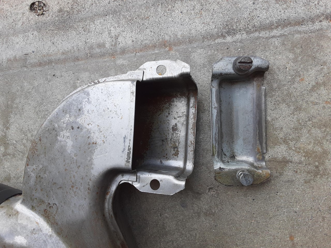

When reassembling the heater ducts under the engine is there a high temp sealing material that goes between the joins or is it just metal on metal?
Picture is just an example of the joints, but I'm asking about all of them.

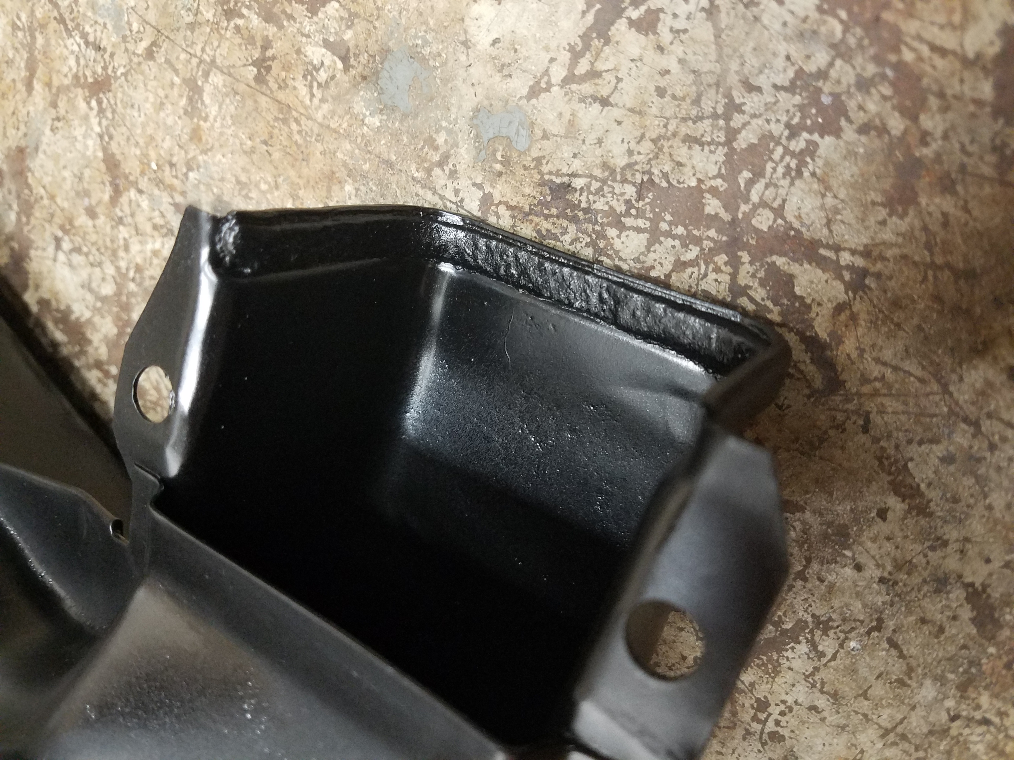

Besides the seal under the "cap" I've seen some that have what I think is a cork-like strip in the channel below. -it seemed original and I think it was glued in.

In addition to the rectangular gasket shown in the picture in post #2, there's also a U-shaped gasket that goes in the branch piece shown in the first pic. It fits in the channel at the front of the branch piece (under where the clamp part gets attached).
Unfortunately, I haven't seen that gasket available anywhere, and each side is a slightly different size. I was going to cut up an extra set of the rectangular gaskets to fit, unless Mark comes out with the correct gaskets before I get around to installing my heater parts.

IIRC, the gasket was silvery and didn't look like cork, like the rectangular gasket. It seemed like a metal or metal-mix, like lead and/or asbestos, and maybe 1mm thick. Or, maybe it was cork that picked up so much metal from the fan shroud that it looked like metal. Either way, it was very fragile and would break if removed.
That adhesive cork strip looks like it might work pretty well.

The seal here was cork - probably should have removed it before i painted it
