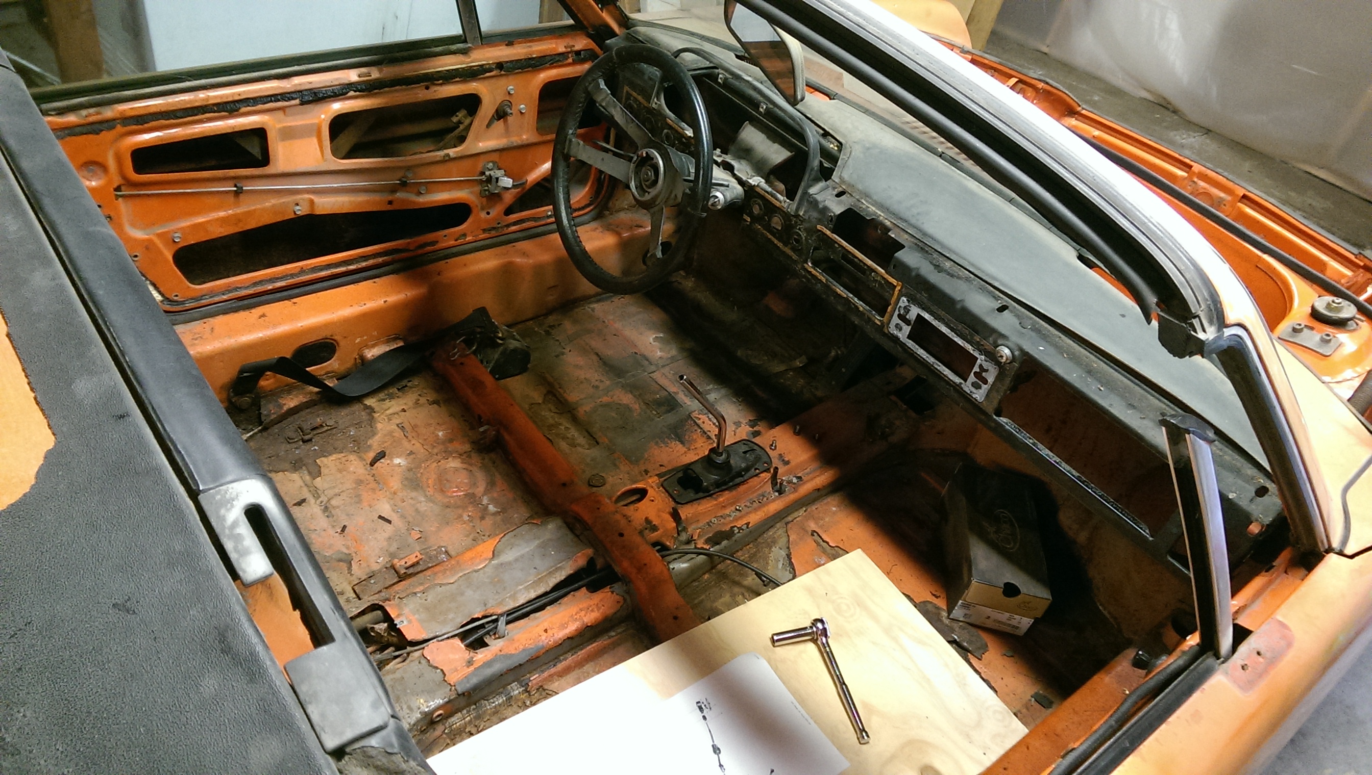

Pictures!
I'm starting to run out of stuff to remove.

QUOTE(Ed Evans @ Aug 25 2020, 08:46 PM) *
Pictures!
Ha! I see plenty of stuff to remove. You just have to lose control of yourself, and before you know it, you will have a bare body shell, and lots of boxes of parts.

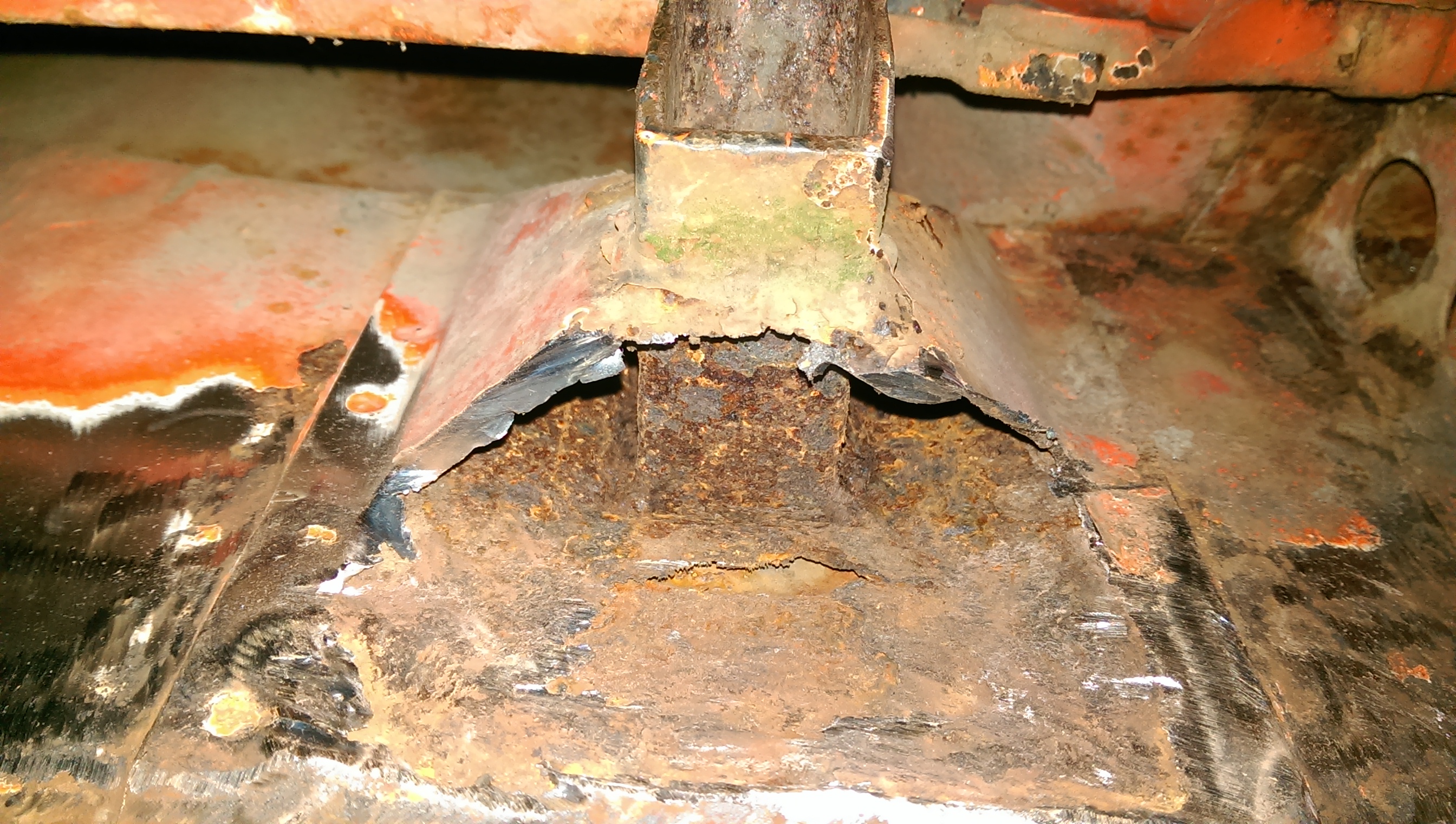

I decided to get into some scary bits today.
This is the passenger side jack post with the lower half of the pyramid cut away.
Can someone point me to a thread with ideas for next steps?

Put this into Google
914world.com Jack point repair hell hole
Look at images
Then pick a thread

That's not scary, that's not too bad. Scary is when you hit it with the sawzall and the whole thing rattles off

Yeah that looks really good actually.
Rot does not look to have gotten into the longitudinal. Wire wheel, seal and move on!
It will be easer for you in the long run to drill out the spot welds around the rest of the jack post support and just weld on a new one from Restoration Design. Just be careful not to drill all the way through into the long!
