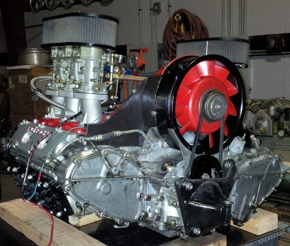

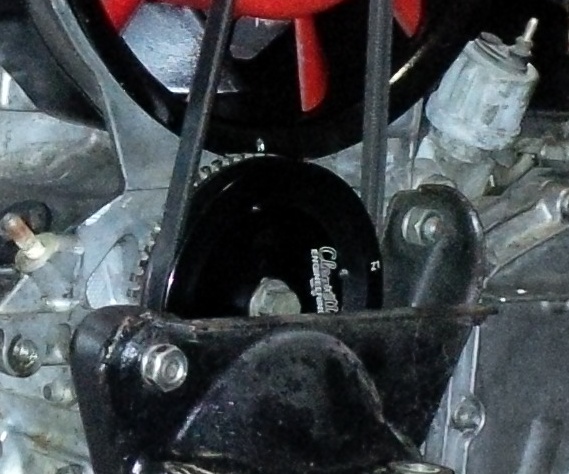

@gms What is that spacer piece behind the mount?
This is what mine looks like
(IMG:http://live.staticflickr.com/65535/50276757841_e7f7d1d789_c.jpg)
(IMG:http://www.914world.com/bbs2/uploads_offsite/live.staticflickr.com-18763-1598579967.1.jpg)
(IMG:http://www.914world.com/bbs2/uploads_offsite/live.staticflickr.com-18763-1598579967.2.jpg)

QUOTE(nditiz1 @ Aug 27 2020, 05:59 PM) *
You have the serpentine pully thats the difference.

Crap!
Thanks Ben.
Ok time for a different pulley.

QUOTE(mb911 @ Aug 27 2020, 09:01 PM) *
You have the serpentine pulley and I don't
