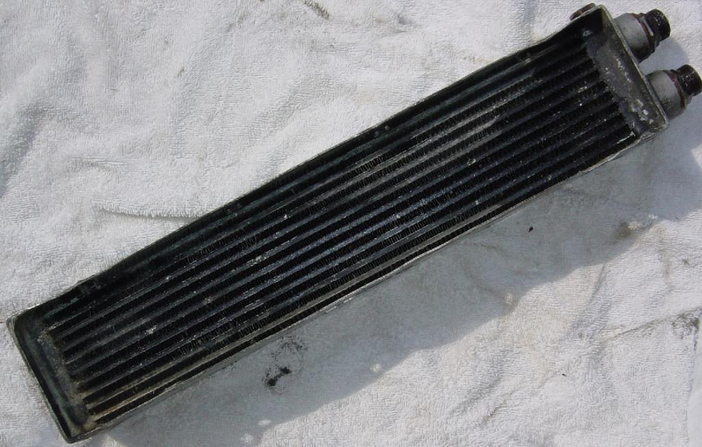

Retroracer
post Aug 31 2020, 04:45 PM
Posts: 655
Joined: 7-July 13
From: Bend OR
Member No.: 16,100

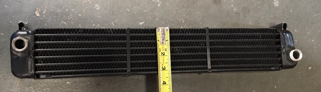

Hey - I extracted one from a Mercedes 300D in the local pick n pull. It sits vertically in the Mercedes, but fits nicely (horizontally) in the GT style front mount shroud area. The fittings are each end and metric, and you'll have to fab up your own mounts, but otherwise its a functional, high "value for money" option. Made by Behr as well, keeping that Germanic flavor to your freshly cooled oil.
FYI,
- Tony
Retroracer
post Aug 31 2020, 04:51 PM
Posts: 655
Joined: 7-July 13
From: Bend OR
Member No.: 16,100

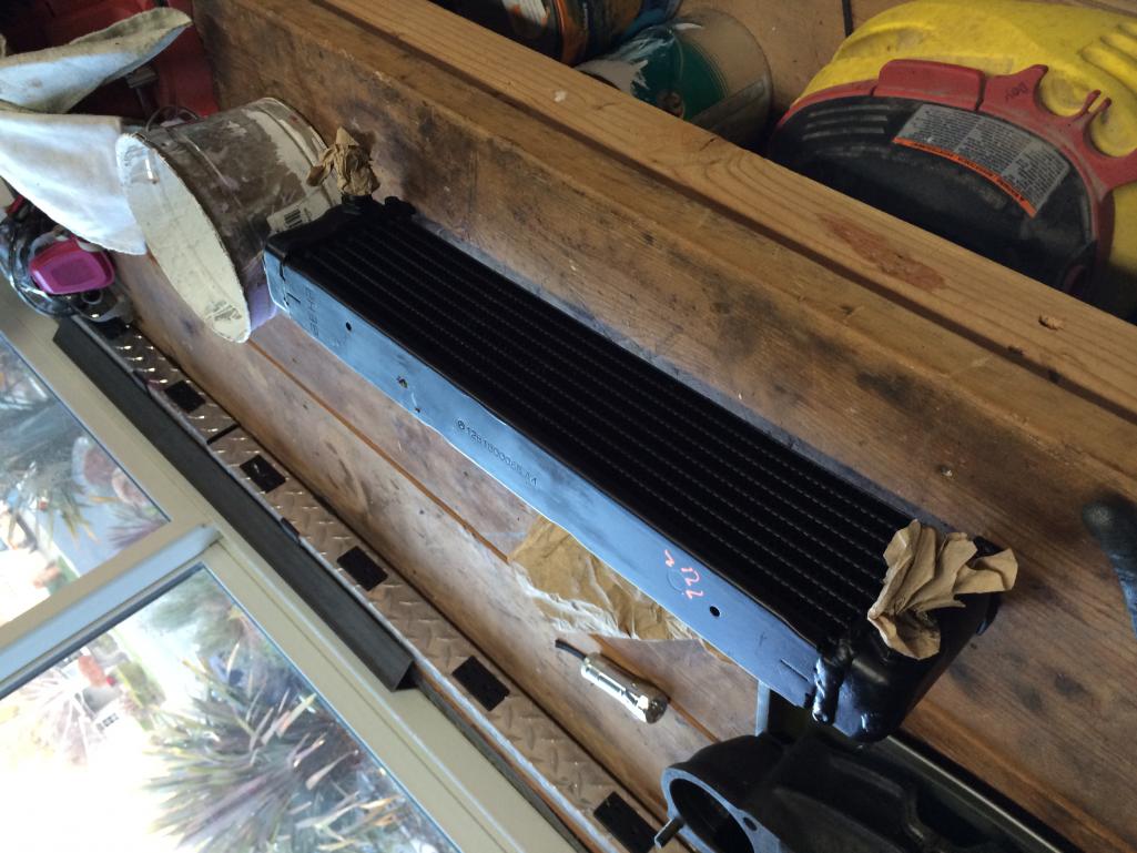

Another pic:
- Tony

Tony, what are the dimensions of this Mercedes 300D oil cooler. Any particular years.

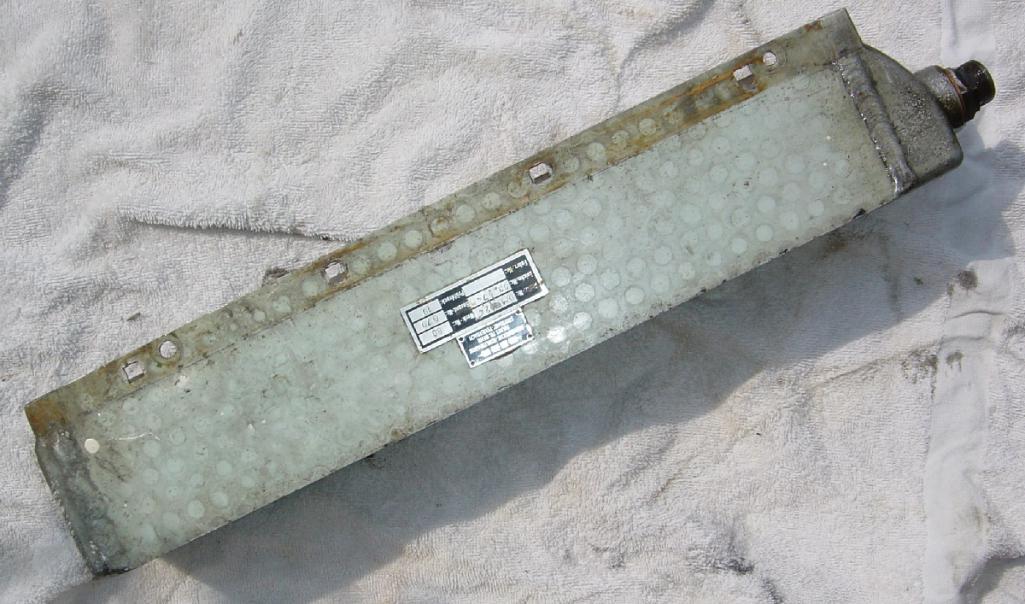

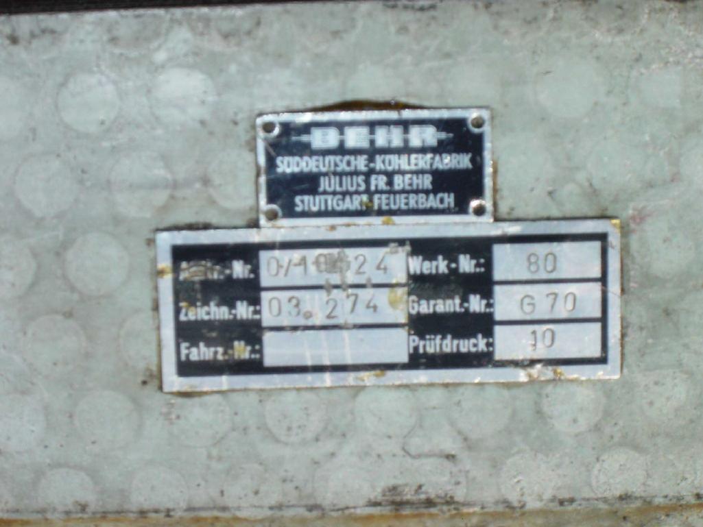

I prefer this Behr cooler (IMG:style_emoticons/default/biggrin.gif)
me two , but have used mazda after market ones with enlarged fittings,
Erics gts use it also

QUOTE(gms @ Sep 1 2020, 06:55 AM) *
Me too, Glenn. Me too..!

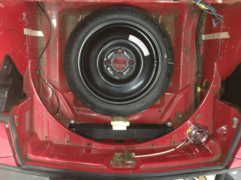

Montreal914
post Sep 1 2020, 09:21 AM
Posts: 2,072
Joined: 8-August 10
From: Claremont, CA
Member No.: 12,023

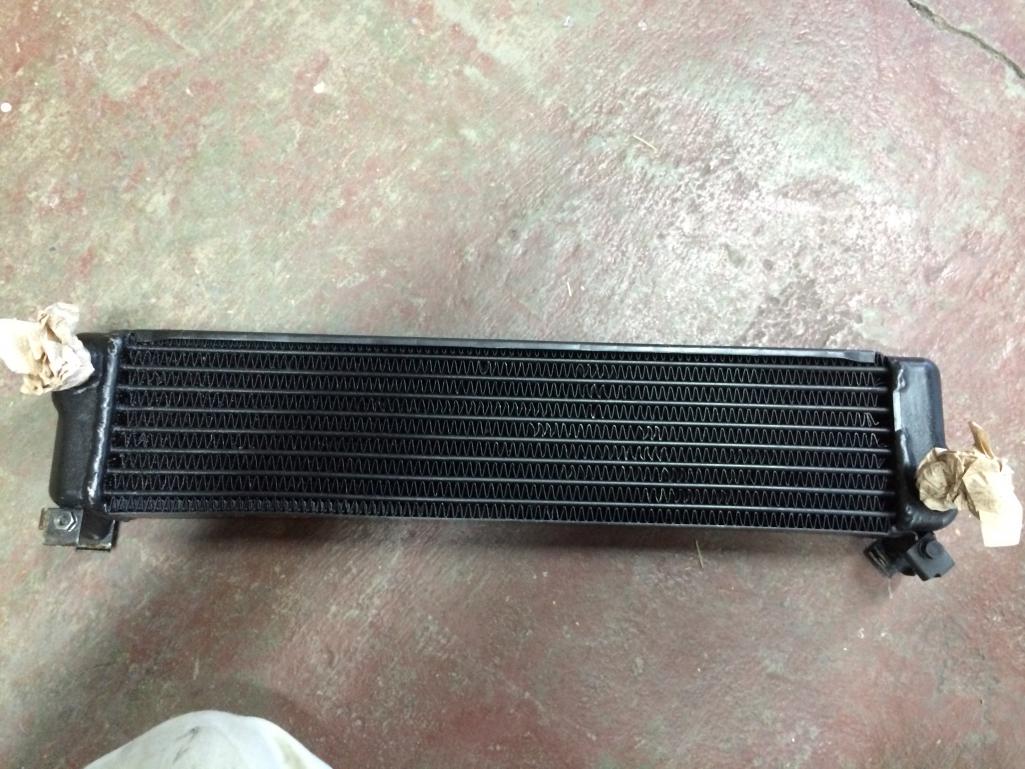

I got a couple of MBZ ones from Bruce Stone. I chose the smaller one (6 pass) of the two so it fits under the shelf, as you can see in the mock up below. Not sure yet if I will be using the fittings it came with, or AN that would be welded on the end tanks.
This one will be use on a 4 cylinder car.

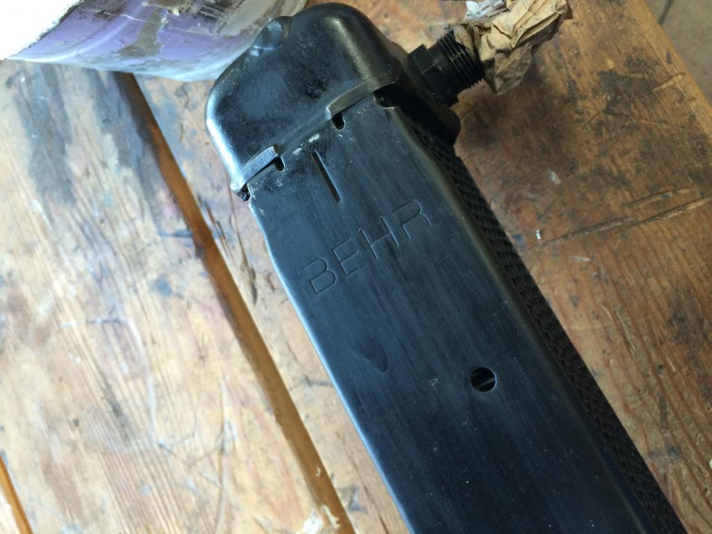

post Sep 1 2020, 09:50 AM
Posts: 655
Joined: 7-July 13
From: Bend OR
Member No.: 16,100

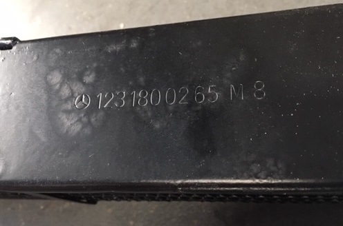

@Montreal914 - looks like a smaller version of the one I have. Attached shot shows part number as well:
@davep - the dimensions are (roughly) 20" wide and 4" high. It fits in nicely in a GT shroud without having to make cuts.
- Tony
