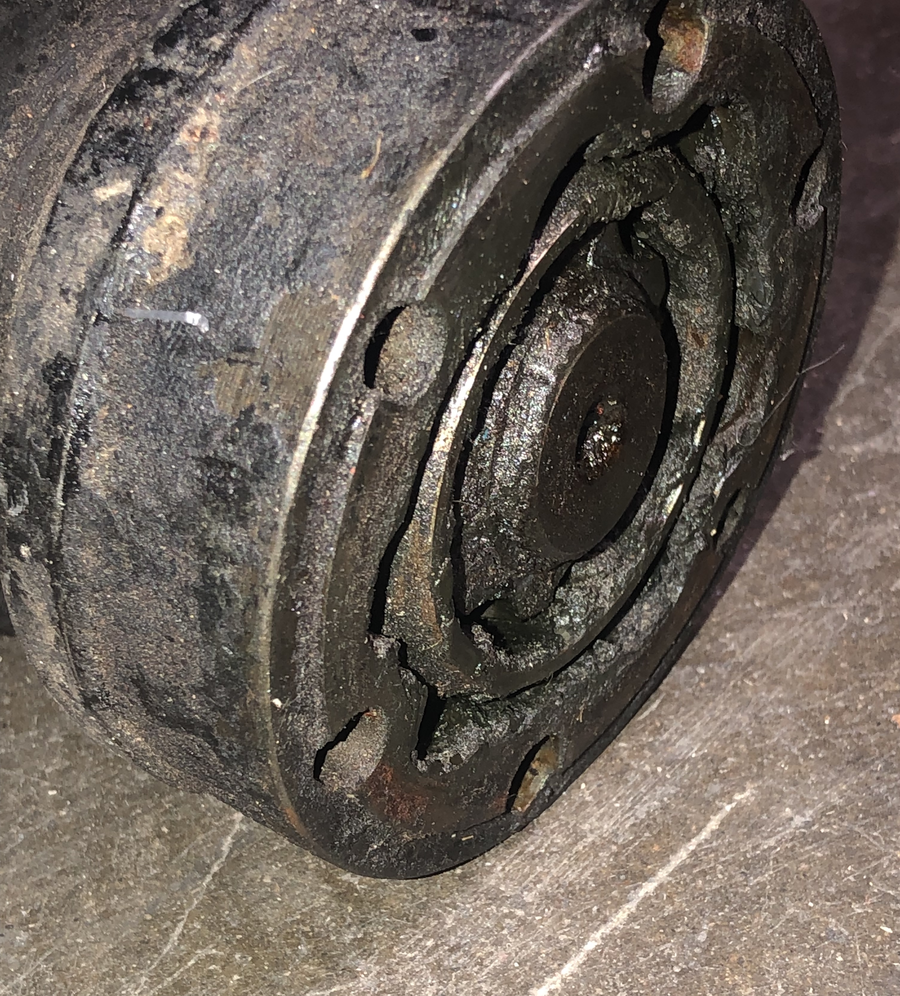

Does this picture show the groove that the gasket sits in there by making this a 914/6 axle/CV?Attached Image

Good morning. So I cleaned the various sets of these axles that I had laying around in preparation for rebuilding them.
I was able to confirm that this ring on the outside match is the known to be 914 CV joint/axles and the length is identical.
So that seems to confirm that these are 914/6 axles? Any advantage to using these on a/six build or are the equivalent in strength to the four-cylinder 914 ones? To use the 6 foot ones I need a matching six bolt flange installed under the transmission I believe, yes?

A more definitive way to confirm would be to count the splines on the driveshaft/CV. I don’t remember off hand what the spline counts were but somebody here will chime in or Google is your friend.
I want to say 31 splines for the -6 and 36 splines for the -4. But that’s a WAG.

There isn't a strength advantage 914/6 vs 914/4 axles. You would only get stronger axles by doing something like a 5 bolt conversion and using the 108mm hubs, stubs, CV's and Sway-A-Way axles.
I agree with Rob-O count the splines and do a search. Eric has a good write up on the different kit you can use with a 5-bolt conversion.
