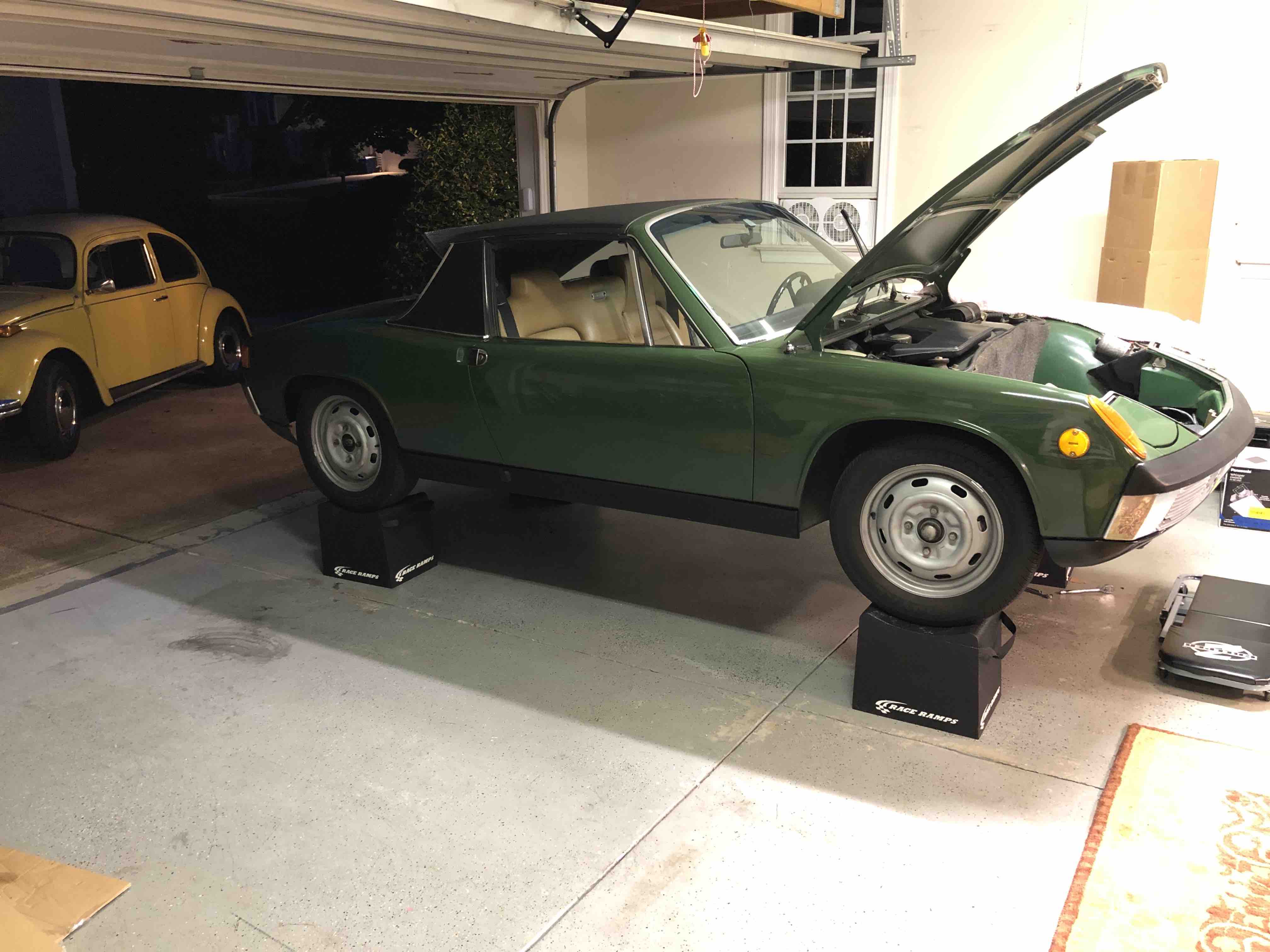

I'm about 3 weeks into my relationship with my new '71 Irish Green 914.

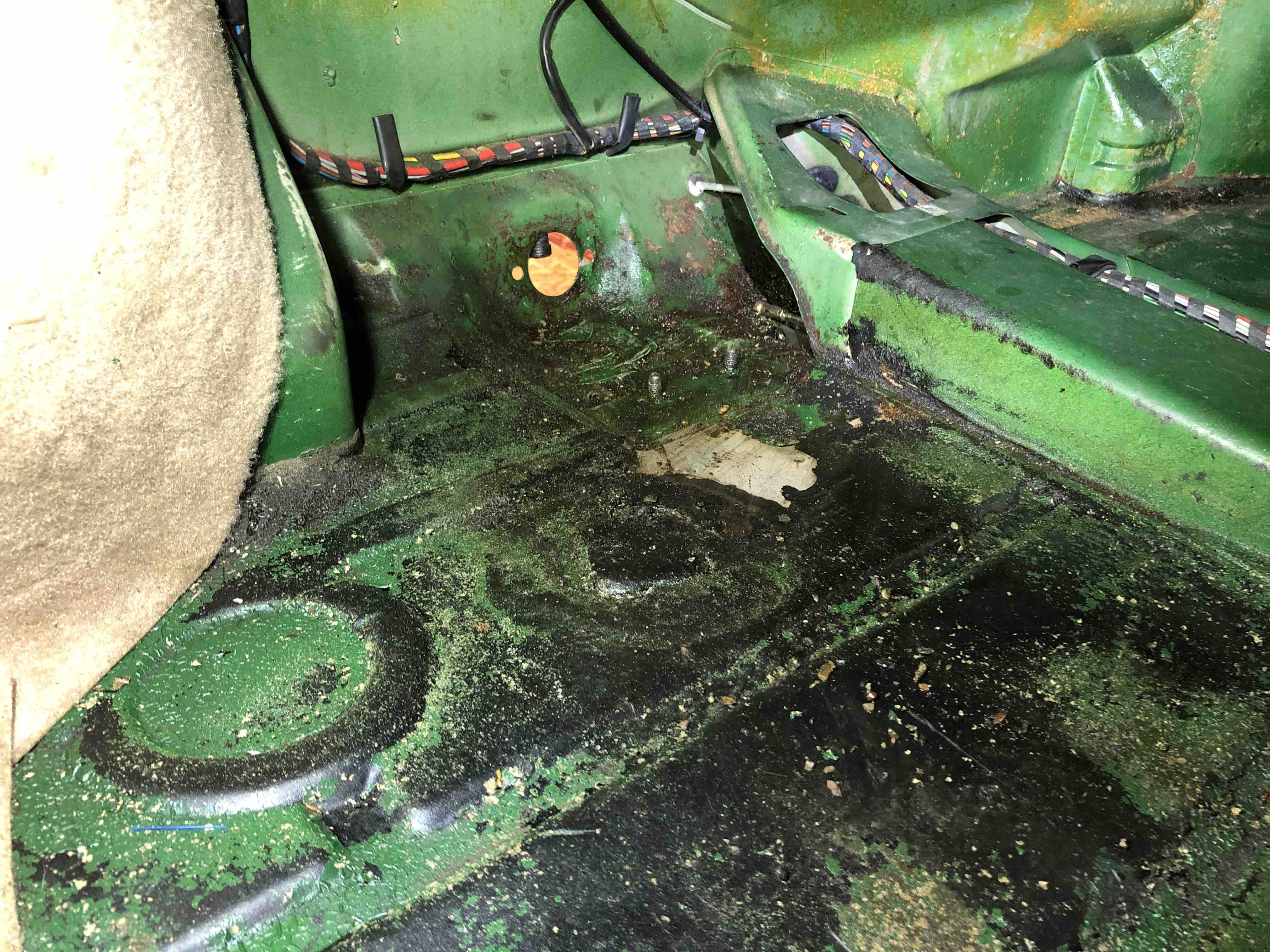

I'm writing in this post to ask about my current problem, which is that my drivers side floorpan is full of brake fluid, bubbling paint and basically a huge mess.
The master cylinder failed and so now I need to clean up the pan before I install my new pedal set (from Bruce) and master cylinder.
I'm a total newb so here's what I'm thinking and please tell me if you know better.
I'm thinking about sopping up what brake fluid I can, going over the pan with some brake cleaner to really clean it up, then stripping the paint with paint stripper, cleaning the bare metal with wurth clean prep then painting it with rustoleum flat black paint.
Please let me know if there is a better way to do this.
I, of course, want to prevent further corrosion and to protect the floor.

That sounds like a good plan, always remove it ASAP. Phosphoric acid will remove any rust that has taken hold prior to paint but after wiring brushing.
You should be OK.

You probably need to remove the tar paper on the floor. I just did this on my car. It often hides rust. It is not that hard to do with a heat gun and putty knife.
I cleaned the floor with strong detergent then Evporust to get rid of the rust. I used modeling clay to confine it to specific areas. After that I used wire wheels in a hand drip to clean on the remnants. There is a white PVC sealant used on the floor plugs. Do not over heat it as it produces cancer causing fumes.
I used good old Rustoleam primer and paint to refinish the floor.
Best done with good ventilation.
