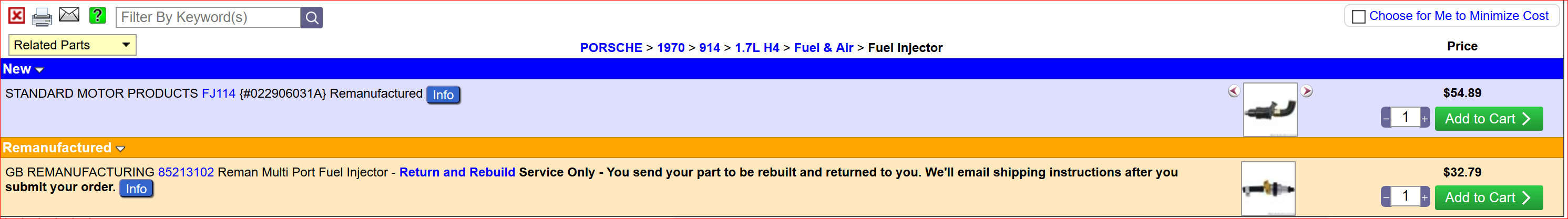

Attached ImageAre they just out of stock? I’m assuming the ‘73 1.7 injectors I just looked up are the same for all 1.7’s. Perhaps an old fashioned phone call to Rock Auto would clarify? ah! I now see the “reman” tag. If mine were remanufactured, I didn’t realize it. They looked brand new and have worked great!

QUOTE(bzettner @ Nov 24 2020, 01:05 PM) *
I've used the Standard for a few years now. Haven't had any problems with them. Check Ebay that's where I got mine at $36 each, but that was a few years ago.
