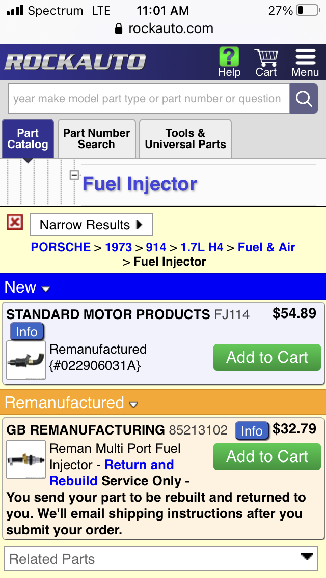

Mr Injector guided me to Rock Auto for my inexpensive injectors for my 1.7. They’ve worked flawlessly. I’d give you their part number but it incredibly easy to navigate their site.
rockauto.com

Click to view attachmentAre they just out of stock? I’m assuming the ‘73 1.7 injectors I just looked up are the same for all 1.7’s. Perhaps an old fashioned phone call to Rock Auto would clarify? ah! I now see the “reman” tag. If mine were remanufactured, I didn’t realize it. They looked brand new and have worked great!

I've used the Standard for a few years now. Haven't had any problems with them. Check Ebay that's where I got mine at $36 each, but that was a few years ago.

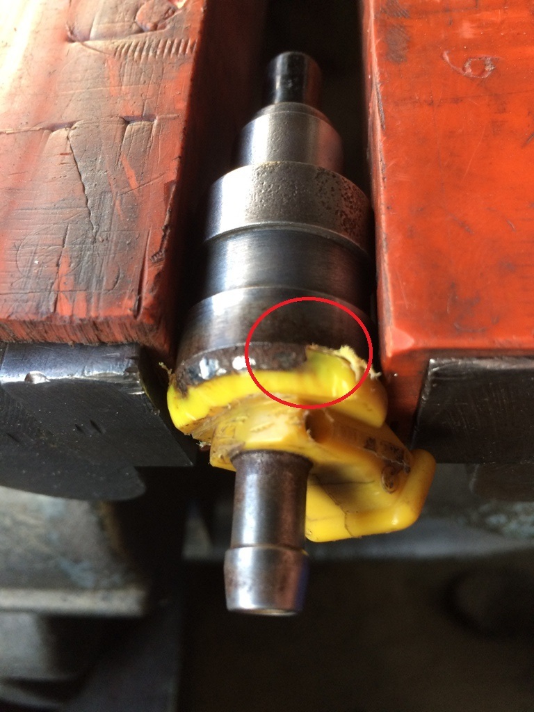

Bosch manufactured the last run of those injectors in 2007. I missed on the occasion to buy new ones back then.
When stored dry for a longer period or not been used (driven), they tend to dry out and fuel is leaking out between the plastic and the steel housing. Nothing you can do, since the plastic is molded onto the body. No way to separate.
Note the corrosion under the yellow plastic, too. (Yes - 914´s even rust on the injectors!)
