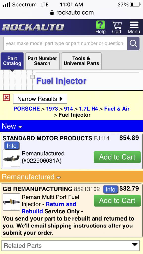

Mr Injector guided me to Rock Auto for my inexpensive injectors for my 1.7. They’ve worked flawlessly. I’d give you their part number but it incredibly easy to navigate their site.
rockauto.com
bdstone914
post Nov 24 2020, 11:01 AM
bdstone914
Posts: 5,421
Joined: 8-November 03
From: Riverside CA
Member No.: 1,319
QUOTE(bzettner @ Nov 24 2020, 10:53 AM) *
rockauto.com
They just have remanufactured injectors shown.
bzettner
post Nov 24 2020, 11:05 AM
Posts: 222
Joined: 2-June 13
From: San Antonio, TX
Member No.: 15,951

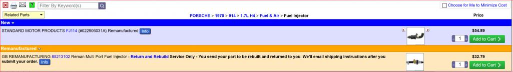

Attached ImageAre they just out of stock? I’m assuming the ‘73 1.7 injectors I just looked up are the same for all 1.7’s. Perhaps an old fashioned phone call to Rock Auto would clarify? ah! I now see the “reman” tag. If mine were remanufactured, I didn’t realize it. They looked brand new and have worked great!

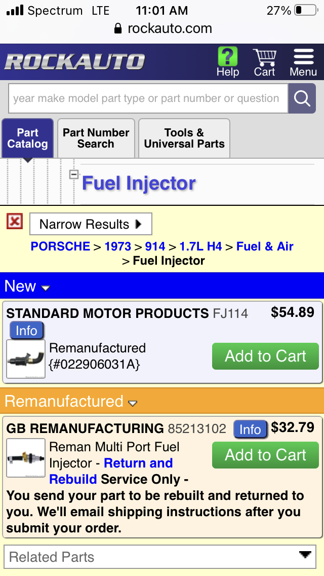

QUOTE(bzettner @ Nov 24 2020, 01:05 PM) *
I've used the Standard for a few years now. Haven't had any problems with them. Check Ebay that's where I got mine at $36 each, but that was a few years ago.

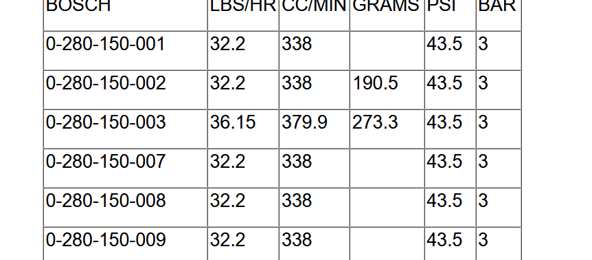

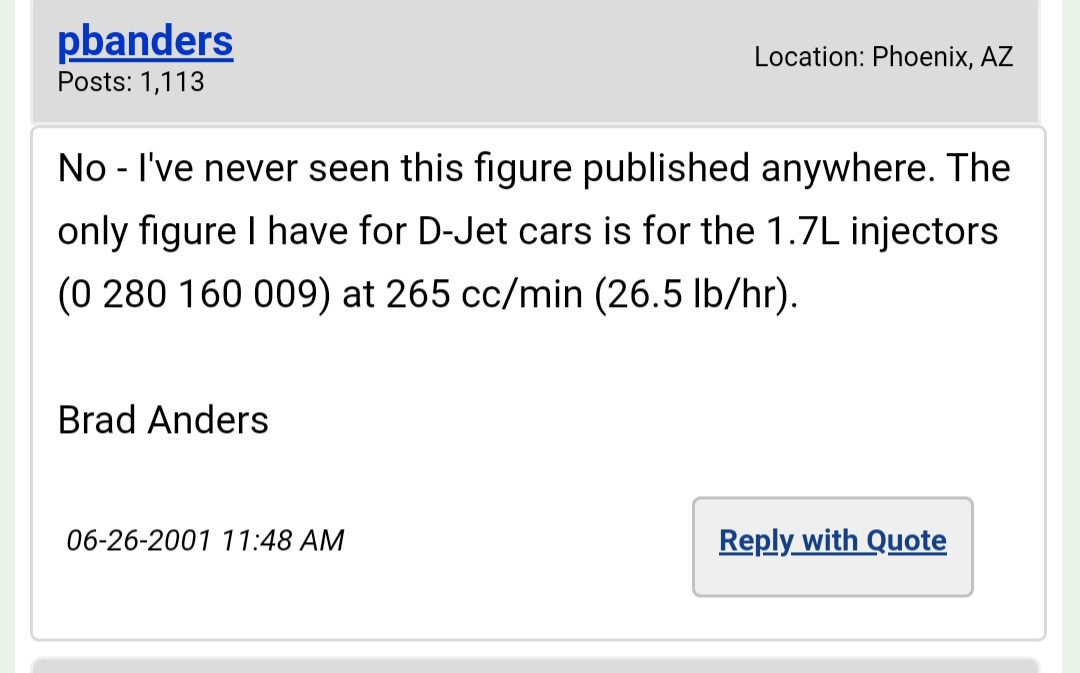

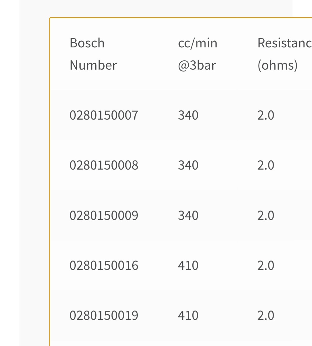

Everywhere I look gives different flow rates for the 007 and 009 injectors- im at a point where I have no idea what the real cc is for each of the injectors (IMG:style_emoticons/default/mad.gif)
914Sixer
post Nov 27 2020, 06:41 PM
Posts: 9,603
Joined: 17-January 05
From: San Angelo Texas
Member No.: 3,457

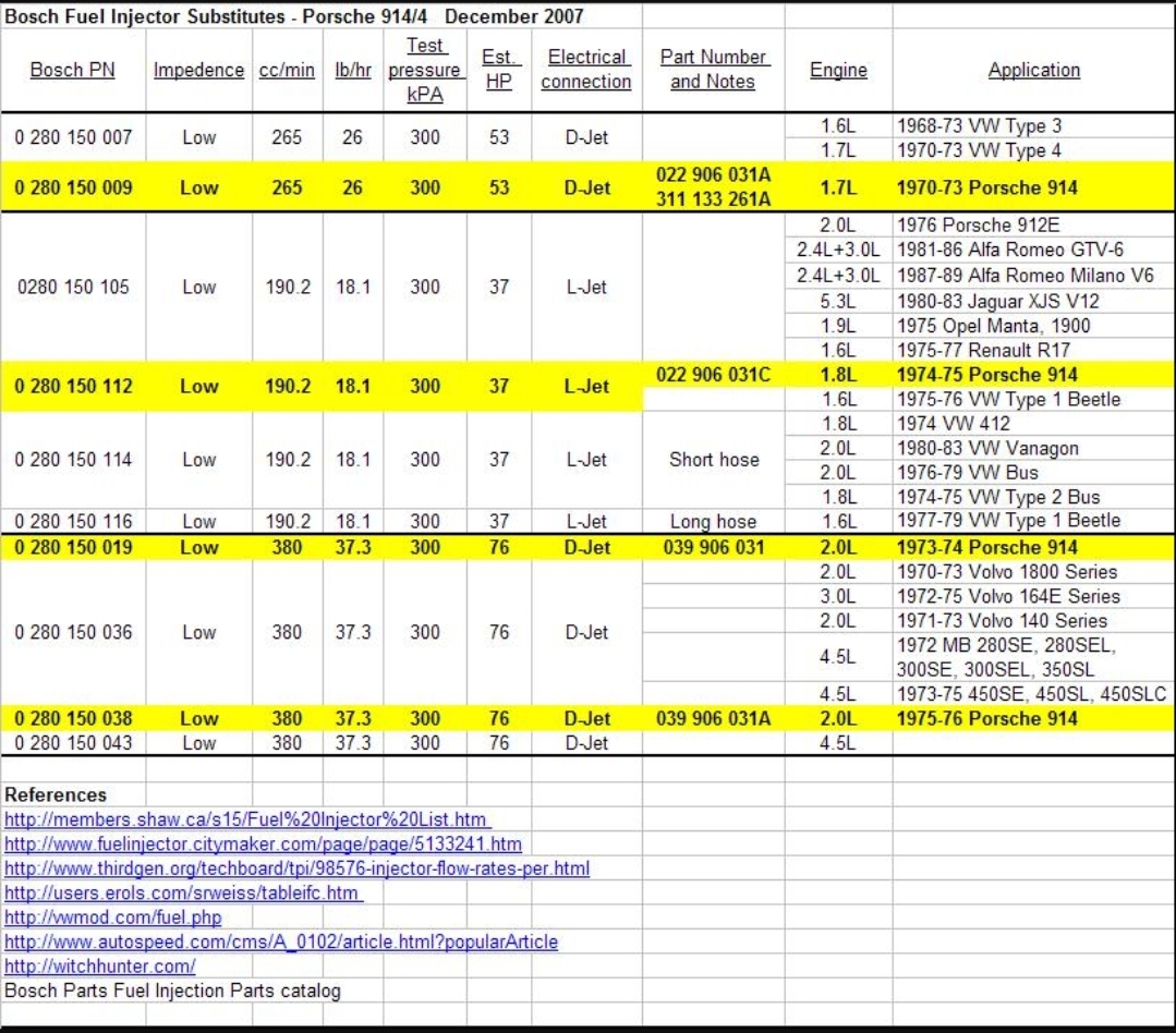

007 and 009 are the SAME injector with a DIFFERENT HOSE CONNECTOR. Also known as VW 311 133. 261A Buy the one's over on theSamba and put the curved hose kit on them. NOTHING better than NOS Bosch for $50 each.

post Nov 28 2020, 06:06 AM
Posts: 34
Joined: 5-August 20
From: Northamptonshire, UK.
Member No.: 24,569
Region Association: England
I couldn't agree with you more, its just hard to know what one is right as you can see below
